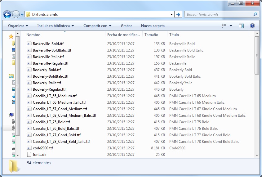

Originally Posted by Cex View Post
Hello,
I tried your script with Bookerly font for eInk devices (extracted from PW2 firmware), but I can't get rid of the Italics problem described in this thread:
https://www.mobileread.com/forums/sho...d.php?t=262943.
I have also tried to correct metadata manually, but can't find any error in the fonts. I have also tried all possible font names with same results.
I'm using sideloaded epubs (have not tested with kepubs) on Glo HD, and I always get italic as bold-italic.
Could someone provide some guidelines to correct this issue?
Thank you.
Sounds to me like it could be a PANOSE issue. Did you choose to strip this information when you generated the font?
EDIT: Dod you restart your Kobo after adding the fonts to the reader?
Stop using the LCD version of Bookerly and pull the eInk version out of the Kindle firmware. I can confirm that the eInk version works no issue and no need to Koboify.
I restarted every time I tested a change, but I have not tried to remove PANOSE.
Will check later and come back with the results...
The names should be:
Bookerly-Regular.ttf
Bookerly-Italic.ttf
Bookerly-Bold.ttf
Bookerly-BoldItalic.ttf
Those are the names that the font files have by default (at least the eInk version I extracted) and they have the issue. JSWolf also suggests that font renaming is required.
I tried those names, removing "-Regular" from first file, and rename using -i/-b/-z, and I get the same result in all cases (I turn off, and then on the reader after loading the font). I think I get the same result in all cases, except with -i/-b/-z, where I got all the text in bold italic. I always test with epub, not kepub, and factory firmware without any modification.
I will test again, just in case I messed up with names or font files.

When I look at Bookerly using Windows font viewer I get the following...
Filename: Bookerly-Regular.ttf
File size: 983,004
Font name: Bookerly
Version: Version 1.01 August 17, 2015
Opentype Layout, Digitally Signed, Truetype Outlines
Interesting. The versions I extracted from the Voyage 5.6.5 firmware are about half the sizes you are showing. For example, the -Regular is 450048 bytes. The version is the same at 1.010 with the Dalton Maag copyright from 2014. The date information just shows as unknown.
OTOH, the fonts files needed no renaming before being copied to my H2O and my font test epub doesn't show any issues with mixed up styles/weights.
I'm showing sizes that seem to be along the lines of DNSB, same version and copyright, mine were from a PW2. I haven't run them through this script, but they pass my test epub, not too shabby looking either. I'm stilling trying to pick between Literata and Bookerly for my font of choice for reading.

On a PW2:
stat -c '%n: %s' Bookerly*
Bookerly-BoldItalic.ttf: 451448
Bookerly-Bold.ttf: 446684
Bookerly-Italic.ttf: 452208
Bookerly-Regular.ttf: 450048
md5sum Bookerly*
8e5aa4db8ddbade4a4ffb1f5b65c36bf  Bookerly-BoldItalic.ttf
60ccb09b8b3c3e56fd83dbb36b5f2404  Bookerly-Bold.ttf
80d006df82df190f6d8f6c387bb347ec  Bookerly-Italic.ttf
0e2bb478d072d68082b703aeb238d2d5  Bookerly-Regular.ttf
V 1.010
Old 10-24-2015, 06:23 PM   #75
Posts: 82,176
Karma: 150871427
On a PW2:
md5sum Bookerly*
V 1.010
I did forget that I modified the font metrics to have a smaller built-in line height because as it comes, the line height is too large.
