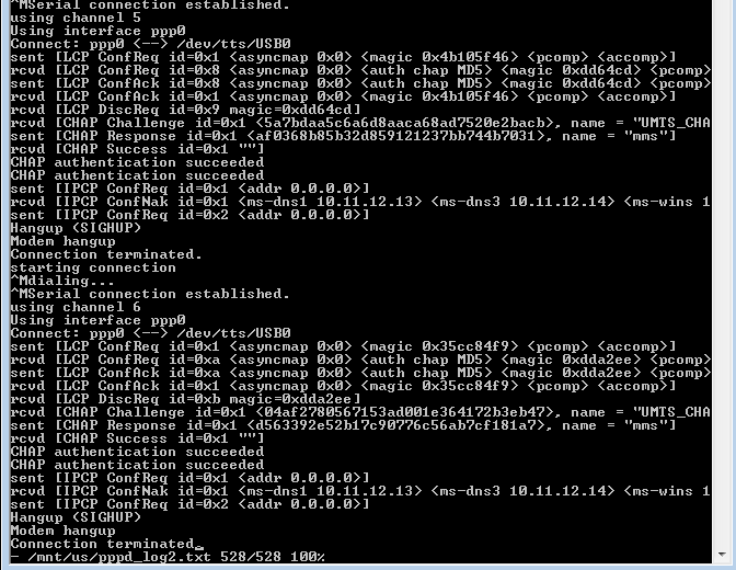

there seems to be problem with authentification: "No auth is possible"
try to add this line in "/etc/ppp/peers/peer-3":
auth
btw, you don't need to add any IP address in config files, pppd will get them automatically.
make sure, that the username in /etc/ppp/{chap,pap}-secrets correctly matches the one you provide in "/etc/ppp/peers/peer-3" file. Any spaces or special characters in the local name, password, or remote name must be properly quoted.

Hi ooommm,
I think I fixed the authentication problem, the log show that CHAP autho was success. and the username in the log file is correct. But strange thing is still no internet connection. I could see the 3G sign when I press menu but can not register or shop. Very strange!

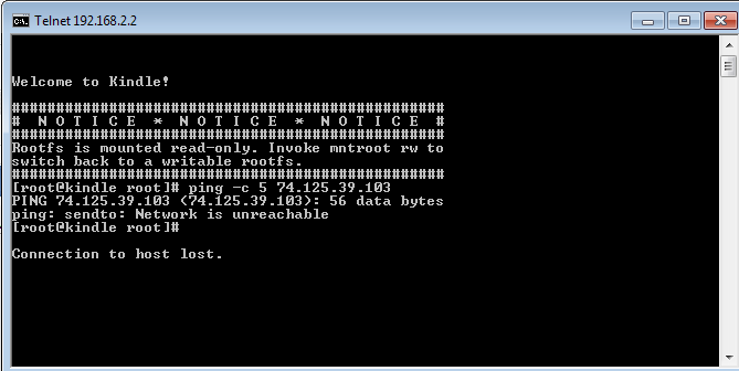

turn on wireless and from kindle linux command line try to ping some hosts, for example:
ping -c 5 www.google.com
then if internet connection is working, you should see smt like this:
PING www.l.google.com (74.125.39.103) 56(84) bytes of data.
64 bytes from fx-in-f103.1e100.net (74.125.39.103): icmp_seq=0 ttl=55 time=31.3 ms
64 bytes from fx-in-f103.1e100.net (74.125.39.103): icmp_seq=1 ttl=55 time=32.3 ms
if you see nothing, try to ping google's or other IP:
ping -c 5 74.125.39.103
ooommm is offline   Reply With Quote

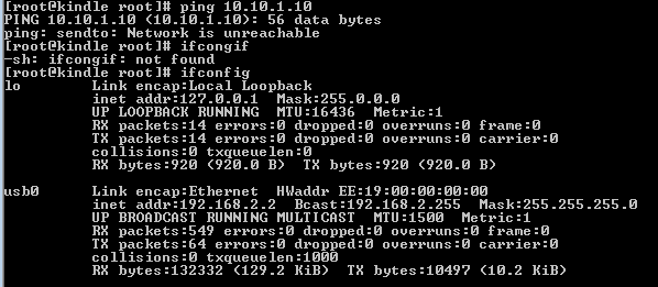

I got Network unreachable.
And do you have problem that the telnet always disconnect to kindle after 1-2 minutes? It said: the connection to host lost. And when I turn wireless on, it disconnect after 30second or less. So whatever I did in telnet, I have to do it fast! This is quite annoying!
And if I do ifconfig, the result as attachment.

Hi ooommm,
I am SOOO happy that the internet now is working, the reason came from IP address (how stupid I am when not listen to you!) I put into connection string, after deleted, it work fine!
Thanks so much for your appreciate help and your passion!. I plan to write down every thing of the process to make this available for every one.

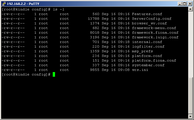

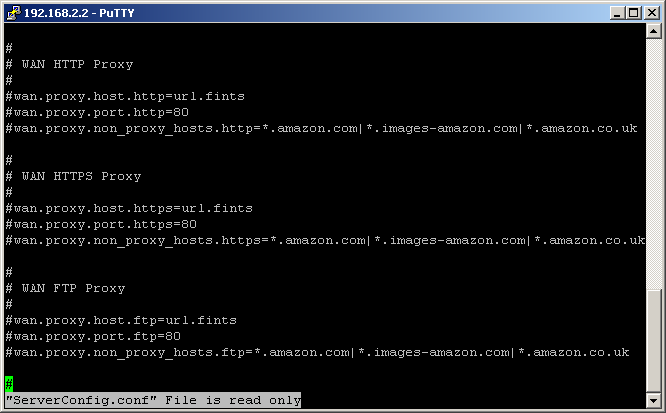

Mine is kindle 3 and i there is no file /opt/amazon/ebook/config/browser_prefs. i can see the proxy lines in ServerConfig.conf, but i cannot save it after putting a # into the front. it said the file is readOnly. how can we change to read and write please.

xptiger: you need to enter "mntroot rw" command before editing, which will mount disk with read/write access, default it is only reading access.

Hi ooommm,
The internet seems to work now, after i "mntroot rw" and change "resolf.conf.3" and "connect-3" and put # in in proxy in "ServerConfig.conf". With 3G turn-on, I can ping to to google.com by IP. but, when i used kindle browser, the 3G signal is gone until the popup message "your kindle is unable to to load the requested page." appear, then the 3G signal shows up again.
do you think it's the browser problem? below is the code of my ServerConfig.conf you can see that i put the # in front of the proxy lines

wan.proxy.non_proxy_hosts.http=*
wan.proxy.non_proxy_hosts.https=*
wan.proxy.non_proxy_hosts.ftp=*

# WAN HTTP Proxy
wan.proxy.host.http=url.fints
wan.proxy.port.http=80
# WAN HTTPS Proxy
wan.proxy.host.https=url.fints
wan.proxy.port.https=80
# WAN FTP Proxy
wan.proxy.host.ftp=url.fints
wan.proxy.port.ftp=80
# FINTS server - Proxy
# The proxy URL should only include the hostname without the protocol.
url.fints=fints-g7g.amazon.com

I've tired for so long, but still no success. it is the code bellow that seems to be a problem.
- when i comment them with #, the browser doesn't load
- when uncomment them, the page loads via Amazon proxy that block access to websites with error message: "Sorry, the browser cannot access this website" ,
- when i change the proxy "url.fints=fints-g7g.amazon.com" to new one i got from "http://aliveproxy.com" it works, but the free one is as slow as dail-up and they also block some websites such as youtube, facebook, etc. i have tried several of them and they are similar.
i have zipped my folder "/opt/amazon/ebook/config" anyone with proxy skill please kindly help.
# WAN HTTP Proxy
# WAN HTTPS Proxy
# WAN FTP Proxy
