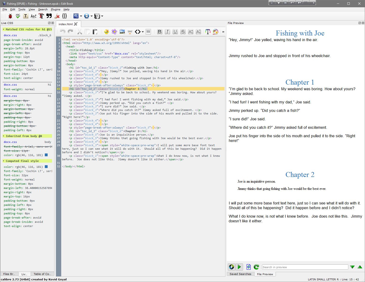

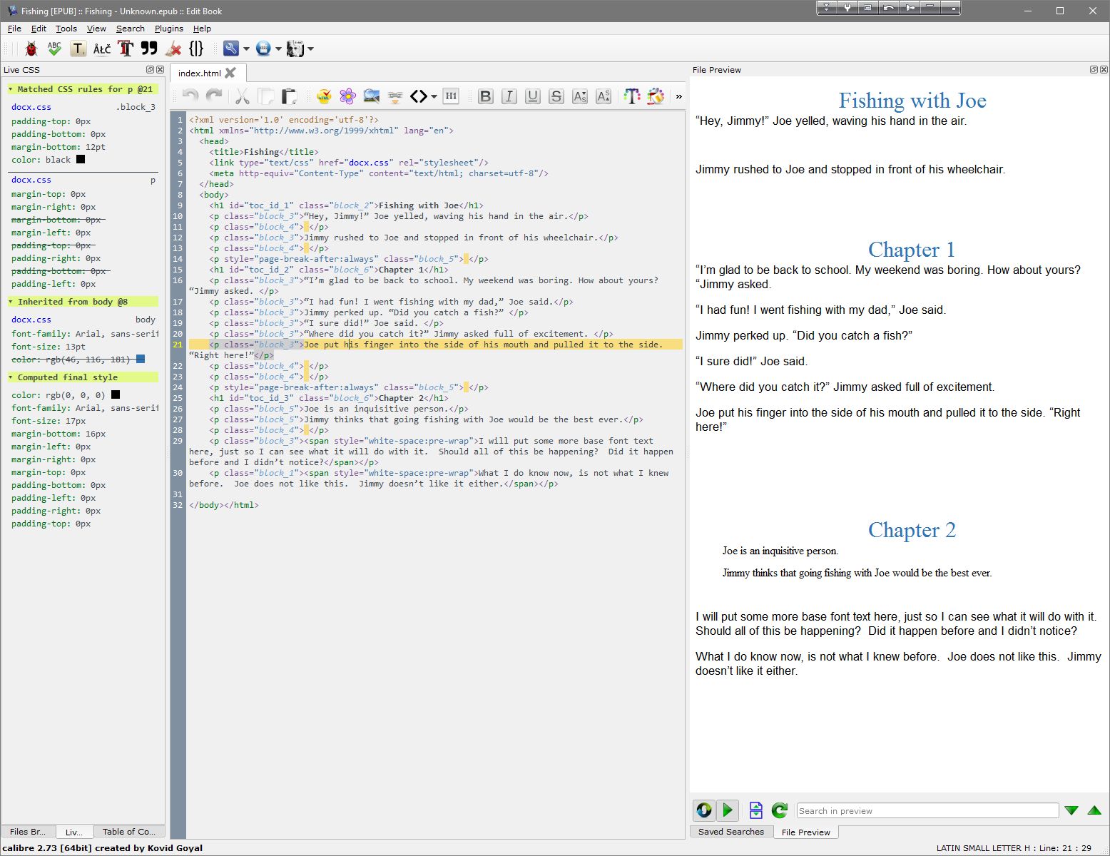

@hidden.platypus - if you look at the Live CSS Panel in the editor, it will show the styles that are used to create the 'final style'.
I imported your docx into editor, here are a couple of examples of what I'm seeing in Live CSS.
ID:	153242 Click image for larger version
I don't see the problem - the final styles have a font specified. And what I see in Word, the editor preview, and the ebook viewer, look pretty much the same to me.
