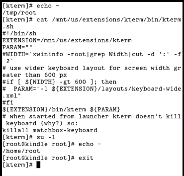

Originally Posted by nasser View Post
there seems to be a difference between logging in through ssh and "logging in" through kterm.. see screenshots..
ssh recognises the "new" home at /home/root..
while the kterm session is still hung up on /tmp/root..
My guess - -
kterm isn't being started in a "login shell" but instead in an "interactive shell".
Check how your copy of kterm is being invoked.
Or -
Start in new shell instance in kterm:
su -l (su - lower case ell)
and then check - -
just be sure to remember to 'exit' both levels of command shell in kterm.
What if you log in through ssh and start kterm from command line:
/mnt/us/extensions/kterm/bin/kterm.sh

My guess - -
Or -
and then check - -
see attached screenshot:
Check how your copy of kterm is being invoked. --> /mnt/us/extensions/kterm/bin/kterm..
Start in new shell instance in kterm: su -l (su - lower case ell) then check - -> now /home/root is correctly recognised..
So.. kterm is being started in an "interactive shell"?
How to make it start in a login shell?
nothing happens..
just get a blinking cursor.. which stops blinking after some time..
able to get back by ^C though..
nothing happens..
hmm, do you mean kterm does not start on your kindle?
baf is offline   Reply With Quote
whoops.. i hadn't observed the kindle's screen..
kterm does start on the kindle.. and when i type in echo ~, i get /home/root.. (when i start kterm through kual i get /tmp/root..)
nasser is offline   Reply With Quote
The question is then, how scripts are started from kual and java environment.
