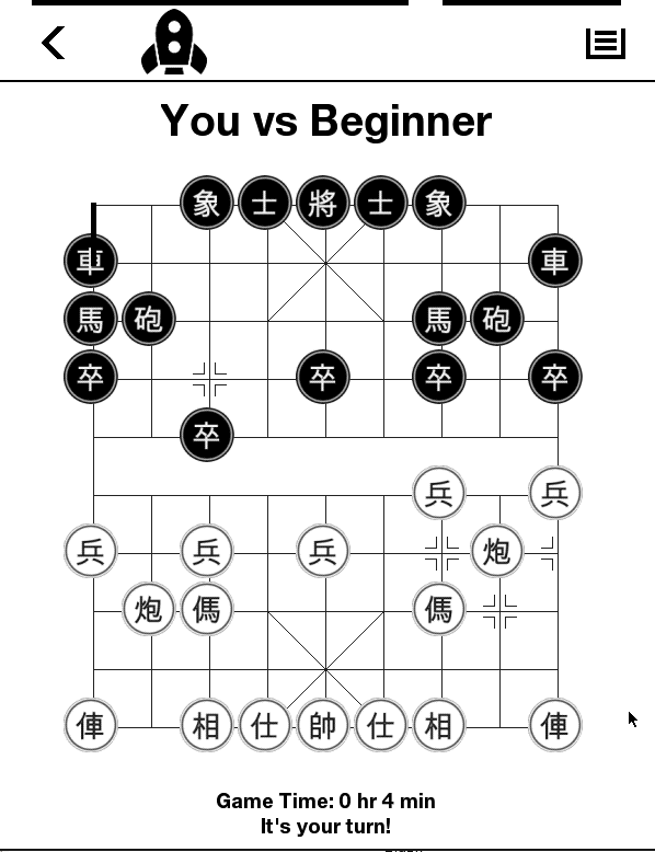

Anyway, here is another updated version of the Kindle Chinese Chess, see attachment.
Changes in Version 0.1.1
1. Changed the display Game Time from second to minute - Avoid drain the battery power.
2. Stop the Game Time if the game is over. (otherwise what is the point? )
3. Fix the Title problem by changing the manifest.mf file. (Thanks twobob for help!)
Install instructions
1. Delete the old file "KindleChineseChess-touch.0.1.0.azw2" from your Kindle.
2. Unzip the attached file.
3. Just copy the new file to your Kindle.

Originally Posted by Awak View Post
OK, I have put the source code in the following link:
https://github.com/AwakenHuman/ChineseChessForKindle
Cheer!
YAY!!!!
Thanks mate.
Looking good!
