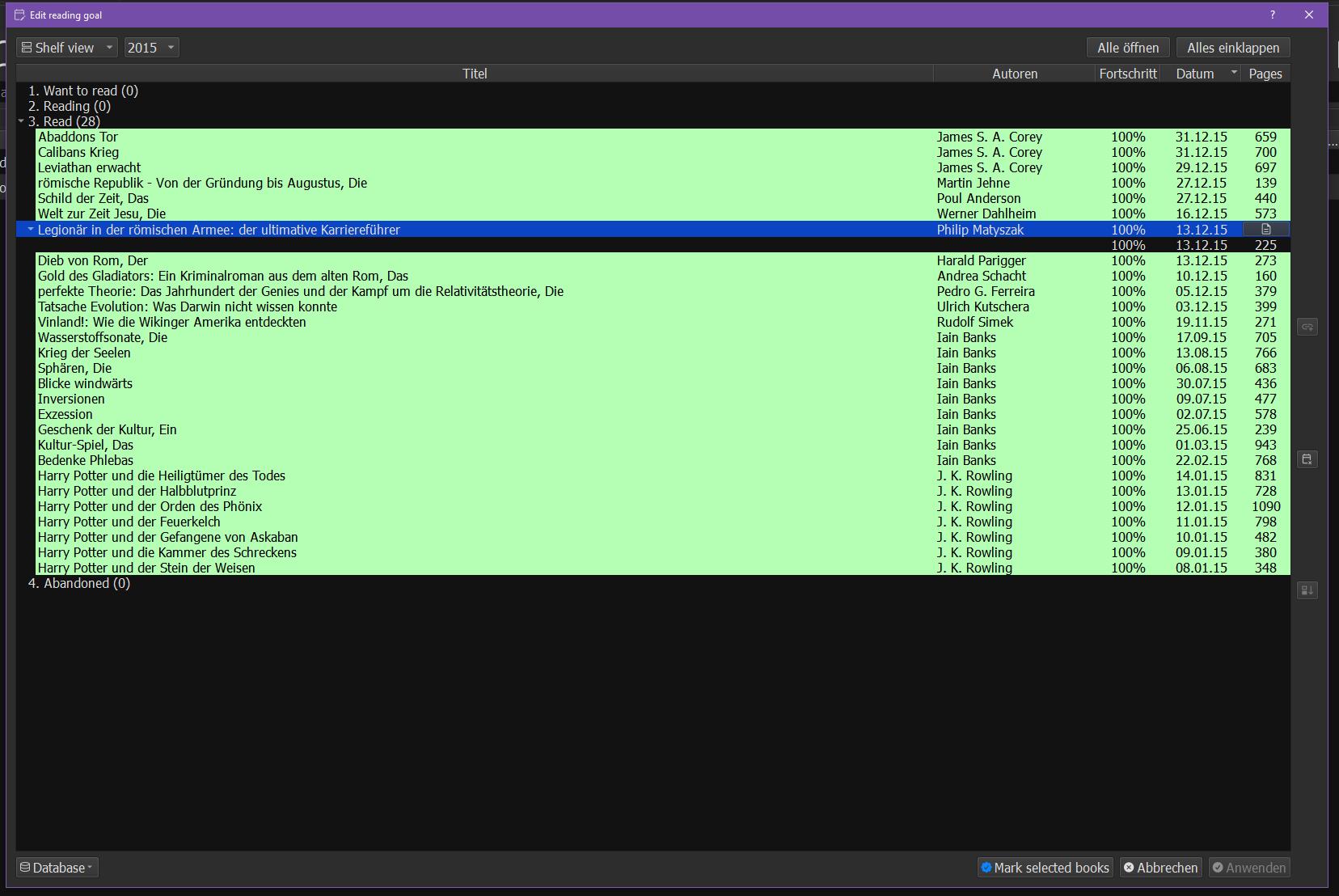

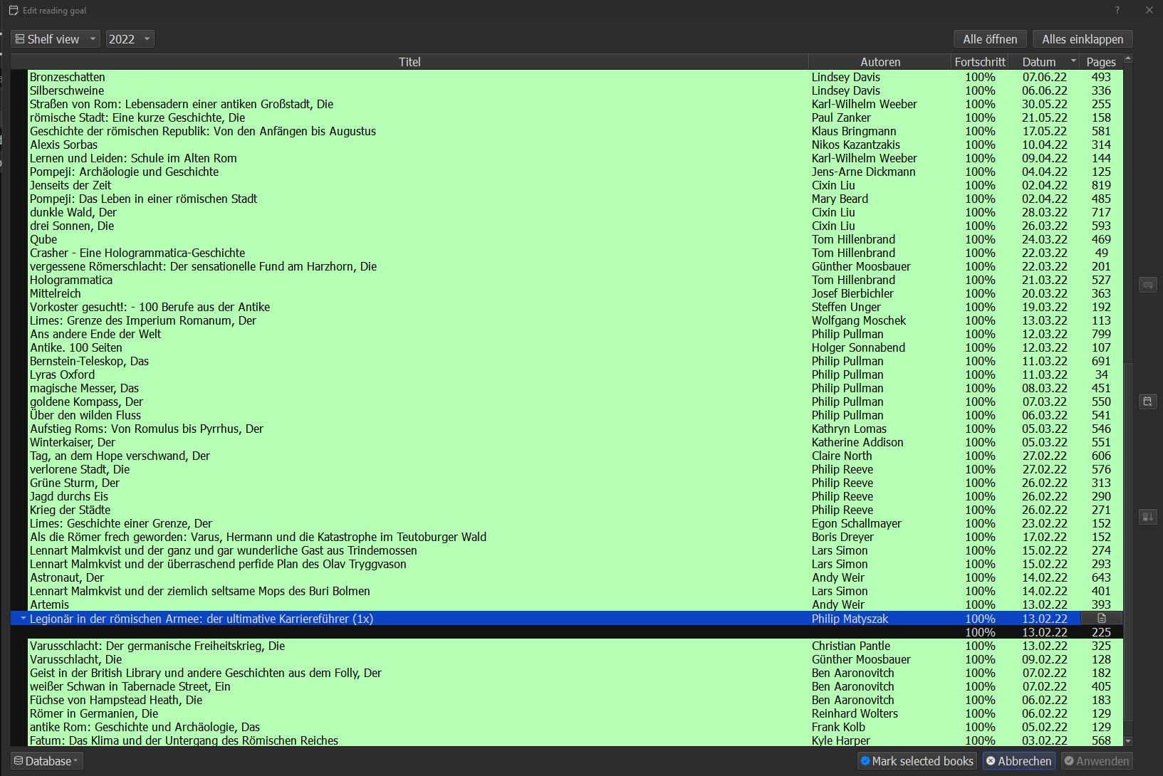

Originally Posted by thiago.eec View Post
I tested here using your RP column and got the same error. Apparently the switch_if function only return strings. Test the version attached version with a fix.
Thank you so much thiago, it works again!
Just one thing. My rereads are displayed with (1x), but are no longer in orange respectively in the rereading shelf. When I click on ‘show books records’, only the respective year is shown.
ID:	210929 Click image for larger version
1) Mark the option 'Keep 'Rereading' color for finished books in the config dialog
2) When you are visualizing your 2024's goal, you only see records for that year. If you want to see other years too, you need to chose 'All' in the year dropdown menu.
thiago.eec is offline   Reply With Quote
'Keep rereading colour' is marked - never changed it
If I switch to rereading shelf, no entries as mentioned above
I had forgotten that - thank you. On "All" show book records "shows" all reading dates - strange.
Should I send you the json file?
Choosing a rereading shelf doesn't work for you because you chose not to fill in the reading progress. Your template only gives 0% or 100%, so you will never see books under 'Reading' or 'Rereading'. That would require a value between 0 and 100.
I added some more options to the 'Rereading' shelf/color a while ago. Maybe, you need to reset your config options. Try this:
1) Uncheck all the checkboxes on the first tab of the config dialog
2) Click OK to confirm
3) Open the 'Edit reading goal' dialog and close it
4) Open the config dialog and check the boxes you want
4) Reopen the 'Edit reading goal' dialog and see if it fixed the issues
If that doesn't help, then send me your json.
Why do you think is strange? When you choose 'All', the plugin aggregates all your data, from all years, so all the records are there. If you choose a single year, then only that year's data is available on the records.
Didn't work.
Strange in that respect, because the entry is there, but no colour.
Edit: Sent you a PM
Didn't work.
Edit: Sent you a PM
Now I see the problem. The plugin is using the color only for the current year, but no for past years. I'll fix it.
