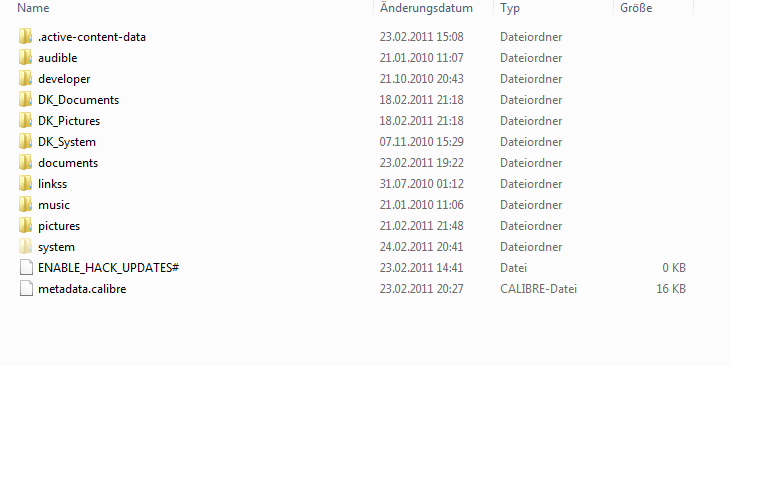

ok,
did turn off wireless and restarted by holding down power switch for 30 sek. But no luck, boot screen of duokan does not show up.
Did copy the v6613 version + update_duokan_0b00a.bin of that version. tried to update by pressing "Update Kindle" but no luck, got an error u007.
Used the update_duokan_installer_0.5.13.8661-02-18-11_k3gb_install from yifanlu with v6613 by pressing "update Kindle" and the update succeded.
Kindle rebooted automatically and no duokan screen.
Holded down power switch for 20 sec. and did a reboot. No luck no duokan screen.
(Did not turn wireless on during the whole process above)
My Usb Root looks like this:
jlove is offline   Reply With Quote

It did surprise me that it installed, the way you did it, so... Anyway it then runs some programs under Amazon, install runtime scripts, etc. before it finally brings up the initial startup screen. There are also some selection in system settings as to which system will be the default startup. Some timeout is involved as well.
As I did mention, a bug report exist already and I don't think we have to wait very long before this is taken care of.

I just registered to tell you that your bin worked for me and I couldn't previously get the install to work. I just upgraded to 3.1 today and re-did the jailbreak. I disabled the break in order to install this. Thanks!!
tvor is offline   Reply With Quote
Old 02-25-2011, 06:50 AM   #464
chal61
chal61 began at the beginning.
Posts: 22
Join Date: Feb 2011
Device: Kindle3 WiFi
@FethryDuck: Thanks! I'm going to test it asap.
@tvor: just to confirm the procedure you followed
1. remove usb root file ENABLE_HACK_UPDATES
2. restart k3
3. copied update_duokan_0b008.bin (or whatever fits to your k3) in root
4. executed an update
5. create again root file ENABLE_HACK_UPDATES to prevent unwanted updates.
and after reboot you have the duokan app?
chal61 is offline   Reply With Quote
