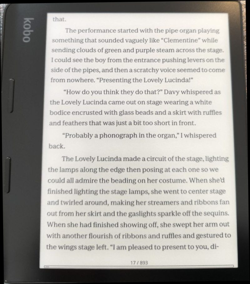

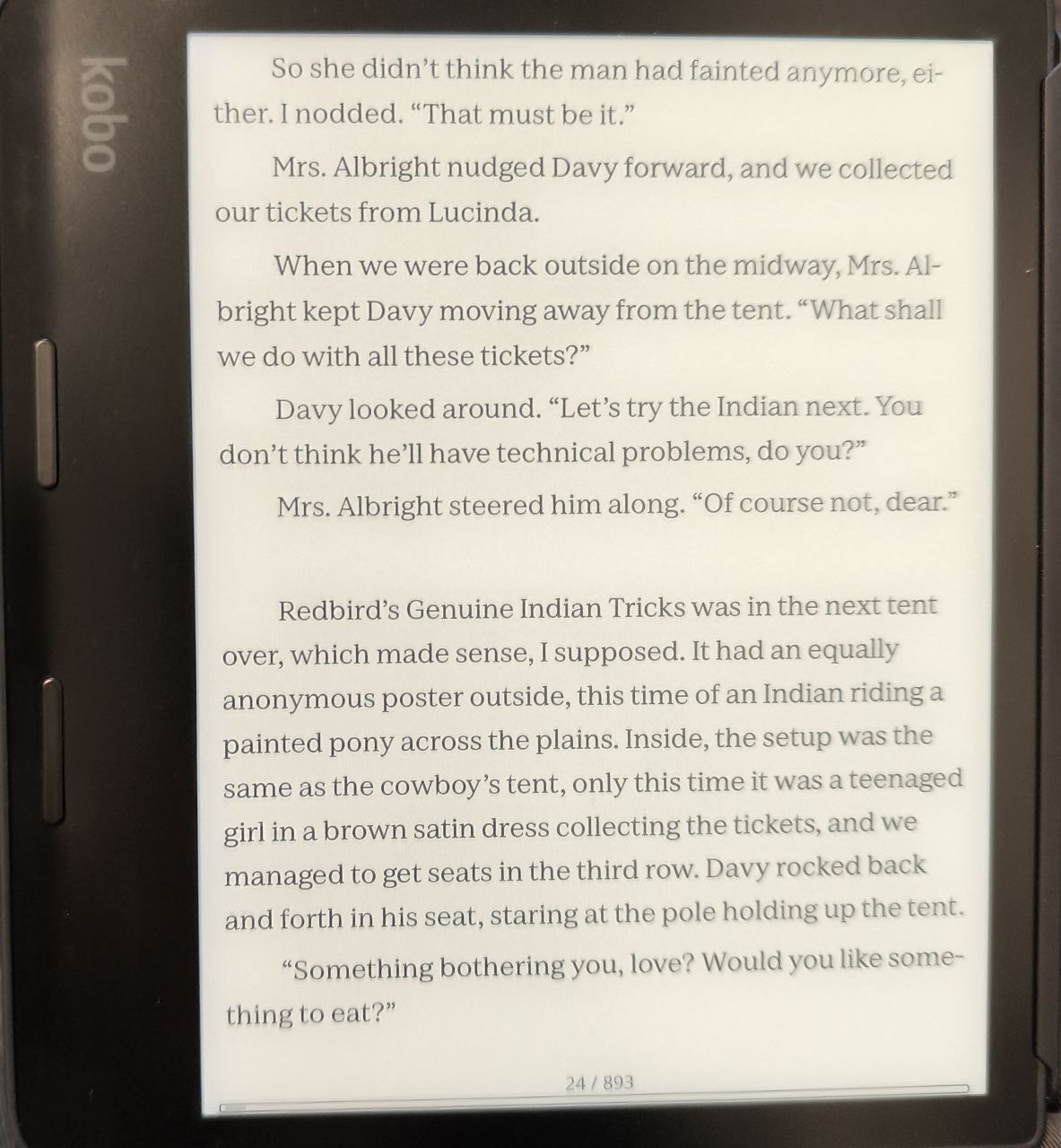

My new Sage is all setup, and hopefully keeping it at no more than 27% brightness will help delay the battery death. It's got to be better than 48%, I'm thinking. The attached photos show KOReader on the left and Nickel on the right, both in more or less my usual reading environment. If I can get away with turning it down further, I will.
