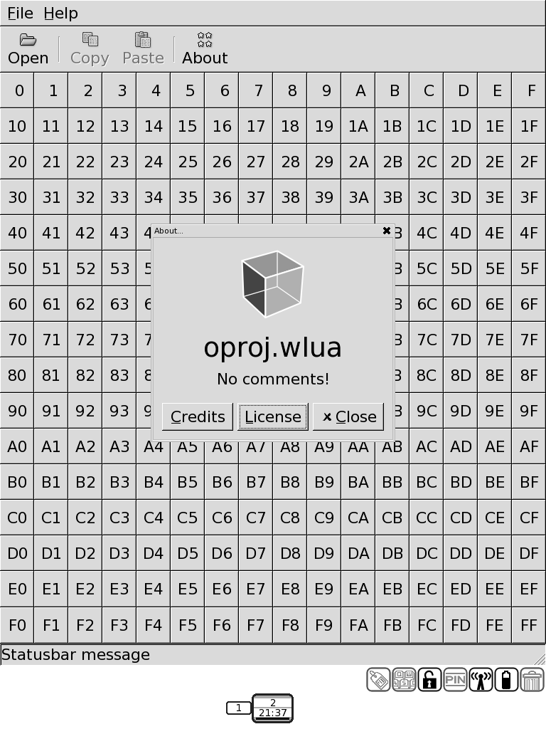

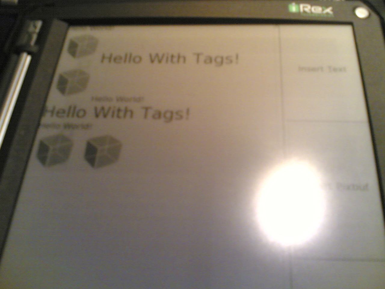

Update...
Hi Iņigo,
I downloaded the most recent version of lobj en lgui, applied your patches, tweaked a little more and managed to compile and run everything! The example with many buttons runs fine (same speed as native gtk).
Great work, great results Thanks!
Originally Posted by Iņigo View Post
Btw, any idea about the problem I mention regarding theme?Iņigo
I have not experienced any problems!?!? See screen shots.
I checked: you do NOT need liblua.a (or .so) to build the libraries.
My build is a bit hacky right now. When I have some more time, Ill sort things out and try to release a documented package...
To be continued...
ID:	24101   Click image for larger version

Question theme issue persists
Hi,
I've checked the new packages, they work great... but the problem I mentioned before regarding theme contrast with my own building persists, so I suppose it's an issue of my iLiad.
This is what I do:
mydesktop$ ssh -l root ILIAD_IP
iliad$ export DISPLAY=ILIAD_IP:0
iliad$ lua lgui_example.lua
After it, the example window displays on iLiad's screen but every widget is drawn with the same colour, so no contrast between different widgets.
I've tested several apps I installed on the iLiad (emelfm2, leafpad, etc) and all of them are displayed perfectly, both when running from contentlister or from ssh shell.
I've also checked all the gtkrc (gtk+ theme files) but I only have the standard ones in the standard places.
Any idea?
Iņigo
Last edited by Iņigo; 02-27-2009 at 11:28 AM. Reason: UPDATE: 20090227 16:27: added ugly screenshot
