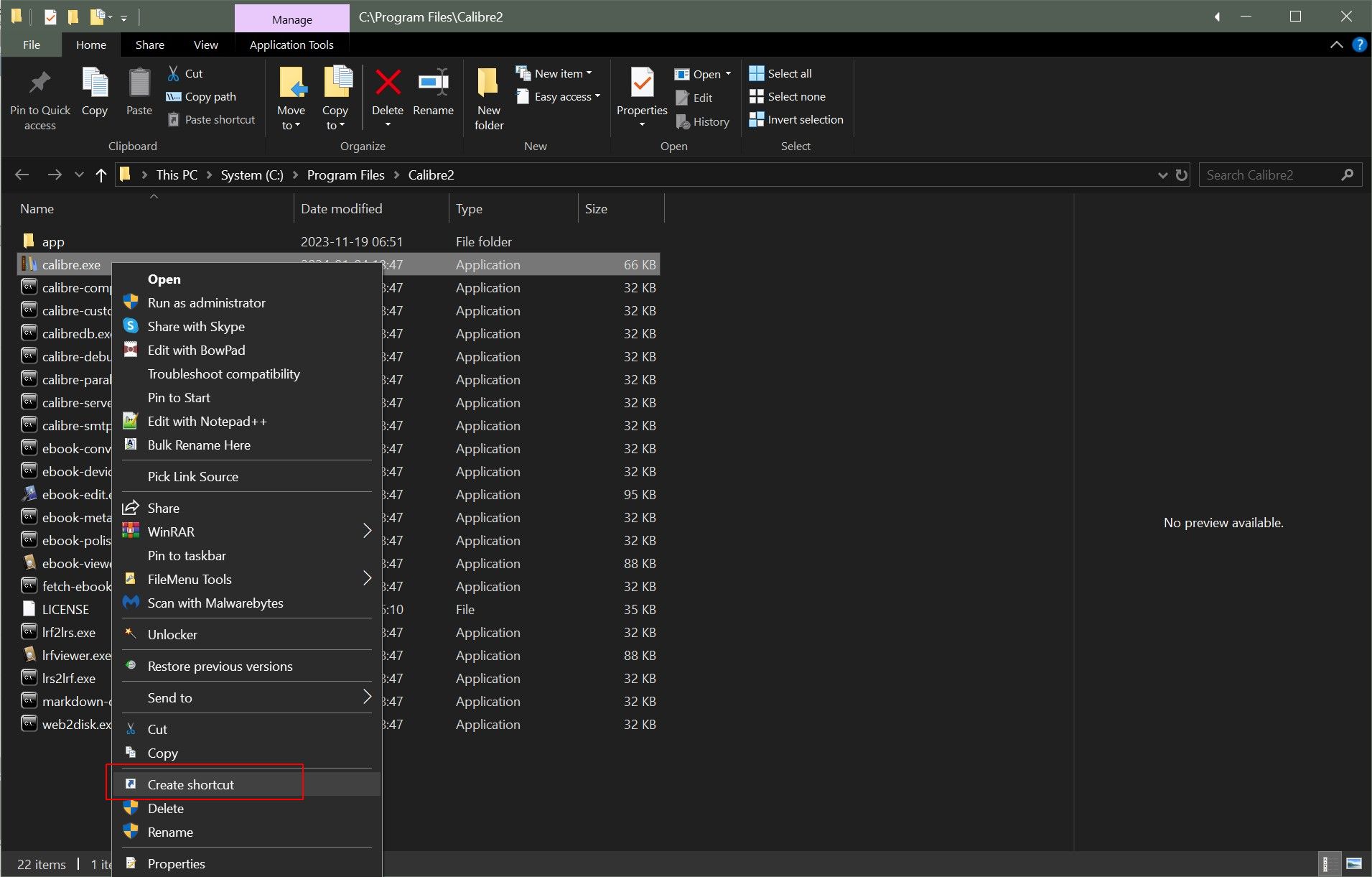

I may have figured out what's happening: calibre is being started with the path to the most recently accessed file. From the user manual
calibre [options] [path_to_ebook or calibre url ...]
Launch the main calibre Graphical User Interface and optionally add the e-book at path_to_ebook to the database.
Windows maintains a directory of shortcuts to the most recently accessed files at: %APPDATA%\Microsoft\Windows\Recent\. I am not aware of any way to get the path to the most recently accessed file, but that doesn't mean there isn't a way.
The calibre command will do the same with a shortcut to a file as it does with a direct path to the file… which is as it should be.
How do you start calibre? I would guess via a shortcut on the desktop, taskbar or start menu… or ????.
What happens of you start calibre directly, you do that by double clicking C:\Program Files\Calibre2\calibre.exe?
If that works I suspect there's something peculiar with the shortcut you're using, in which case I suggest you remove it and create a new one:

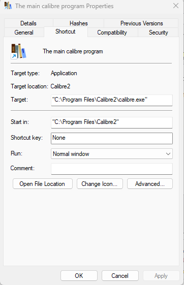

If you look at the properties of the shortcut that imports files, what does show? Right click on the task bar icon, right click on "The main calibre program", click on Properties. See attached image for what my computer shows.

The shortcut on the task bar is similar to yours, what i have just realised though is that the shortcut i have been using is on my Directory Opus toolbar. That seems to be the culprit.
If i drag the working shortcut from my desktop on to the Directory Opus toolbar is imports on start up.
