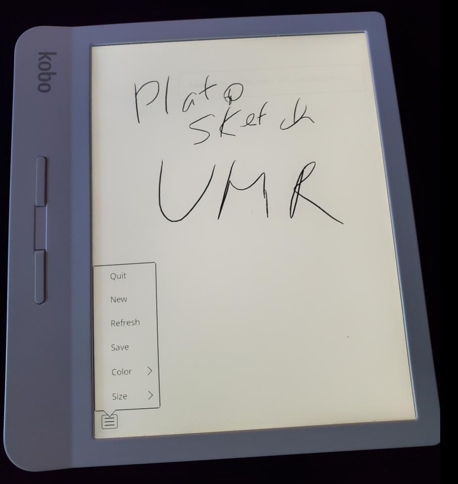

Test on my Libra H2O:
UltimateMangaApp: Behaves the same way. The power button will activate the screen saver. Pressing the power button again will bring up the Connect to Wifi popup but the screen is still unresponsive to inputs. Have to force restart in order to get back to kobo menus.
Scribble App: Unresponsive to any touch. The FILE, OPTIONS, HELP on the top is unresponsive to touch. Touching anywhere else on the screen has no response. Pressing the power button has no response. Have to hard shutdown and power back on.
Logs from Scribble app:
qt.qpa.input: evdevtouch: Adding device at /dev/input/event1
KoboKb: Attempting to capture input...
qt.qpa.input: evdevtouch: Using device /dev/input/event1
qt.qpa.input: evdevtouch: /dev/input/event1: Protocol type A  (multi), filtered=no
qt.qpa.input: evdevtouch: /dev/input/event1: min X: 0 max X: 1679
qt.qpa.input: evdevtouch: /dev/input/event1: min Y: 0 max Y: 1263
qt.qpa.input: evdevtouch: /dev/input/event1: min pressure: 0 max pressure: 0
qt.qpa.input: evdevtouch: /dev/input/event1: device name: cyttsp5_mt
qt.qpa.input: evdevtouch: Updating QInputDeviceManager device count: 1 touch devices, 0 pending handler(s)
Key pressed!  16777238
found focusobject: true in.type: 1  | in.code:  193  | code: 16777238  |  pressed
found focusobject: true in.type: 1  | in.code:  193  | code: 16777238  |  released
Key pressed!  16777239
found focusobject: true in.type: 1  | in.code:  194  | code: 16777239  |  pressed
found focusobject: true in.type: 1  | in.code:  194  | code: 16777239  |  released
Powerbutton Pressed!
found focusobject: true in.type: 1  | in.code:  116  | code: 16777483  |  pressed
found focusobject: true in.type: 1  | in.code:  116  | code: 16777483  |  released

Just looking at the logs, is it because Max Pressure is 0?
nuetron is offline   Reply With Quote
Old 09-16-2020, 02:51 PM   #34
NiLuJe
BLAM!
NiLuJe's Avatar
Posts: 13,507
Karma: 26047286
Location: Paris, France
That sounds mildly suspicious, and doesn't agree with evemu on my Forma:

I think the problem is that Plato and KoReader is not using QT. Can't really compare them since they are using something totally different.
For what it's worth.
Logs from Plato:
Plato is running on a Kobo Libra H₂O.
The framebuffer resolution is 1264 by 1680.
Framebuffer rotation: 2 -> 2.
insmod: can't insert '': No such file or directory
ifconfig: SIOCGIFFLAGS: No such device
udhcpc: SIOCGIFINDEX: No such device
Framebuffer rotation: 0 -> 0.
udhcpc: started, v1.31.1.kobo
udhcpc: sending discover
udhcpc: sending select for 192.168.1.101
udhcpc: lease of 192.168.1.101 obtained, lease time 5452
udhcpc: lease of 192.168.1.101 obtained, lease time 7200
