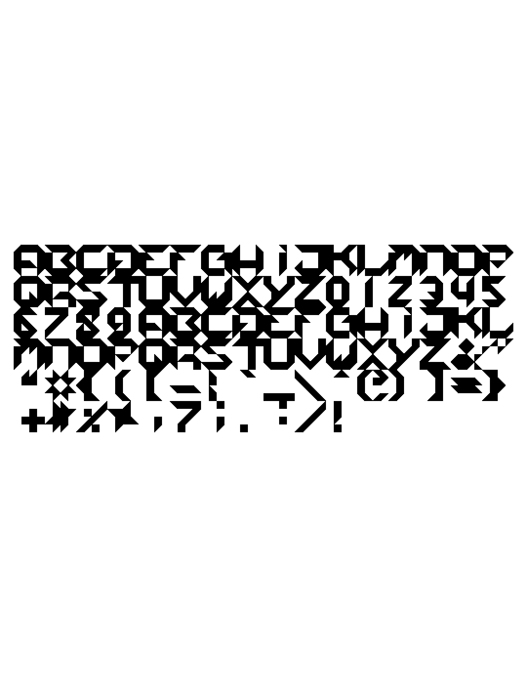

* Yeah, a scaled down version of the same glyphs would do just fine for the lowercase stuff .
* See the attached snapshot . I get the idea, but (some of) the digits are a bit all over the place (mostly 1, 2 & 3).
I'm considering the lack of padding a feature and not a bug ^^. Might be worth experimenting with a tiny bit of padding for the lowercase stuff, though? But I don't really have a strong opinion on that one .
* Yeah, there's a lot of really tiny BDF/PCF fonts (f.g., creep is 4xsomething, IIRC). Unfortunately, I can only use stuff with a *width* that matches the width of a C data type in bits (i.e., 8/16/32/64). If there's one column of difference one way or the other, than can usually be fudged w/ gbdfed, but even then, turns out that severely limits our possibilities .
(Plus, in our case, 8x8 is already mind-boggingly tiny on a >250dpi screen ;p)

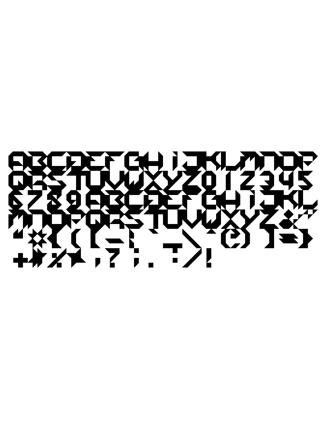

With those few aforementioned tweaks in .
EDIT: And with a tweaked question mark, so it looks less like a stretchy seven...
ID:	165594   Click image for larger version

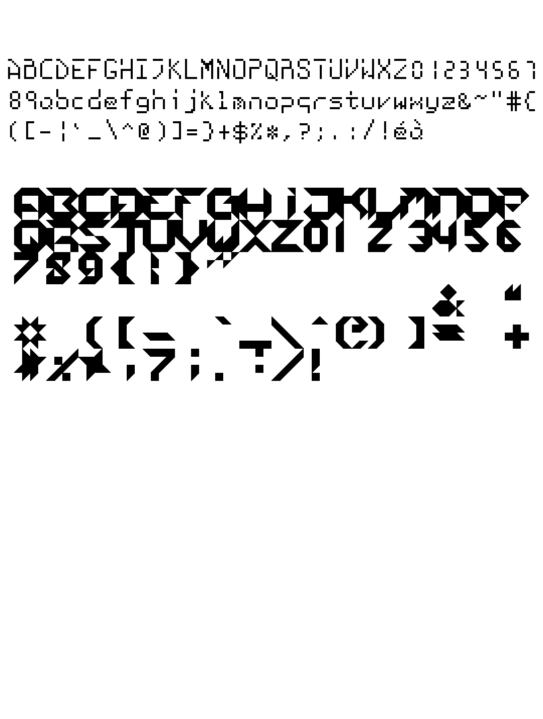

BLOCK lower cases
Originally Posted by PoP View Post
You were right. I am going crazy, and nowhere.
Eureka.
I had an idea for the lower case characters. Reduce the atomic triangles from 8x8 down to 4x4 and center 16x16 glyphs in a 32x32 grid.
Voilà: ꜱᴍᴀʟʟᴄᴀᴘꜱ in a blocky shape identical to the upper case.
@NiLuJe Do you think this might work? Attached are the .# drawings of a to z, plus a correction to the middle leg of the M:
M+atoz.txt

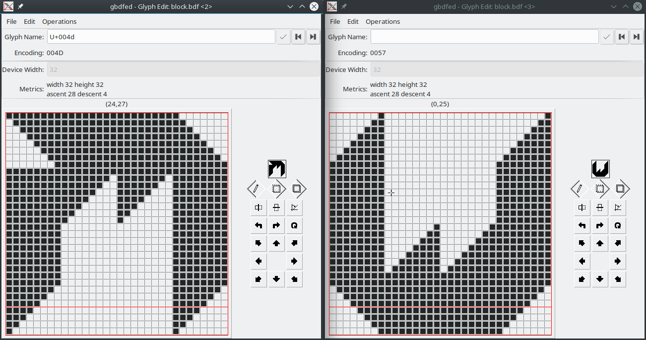

@PoP: I'll try it out .
I'm not seeing any change to that M, though?

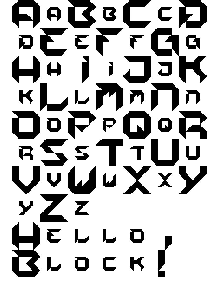

EDIT: Here's what it looks like in gbdfed (compared to the W, which doesn't look off either).
EDIT²: And here's how that looks.
(NOTE: I had to plug some holes ).
EDIT³: w was missing a slope .
EDIT⁴: o was missing a cap .
ID:	165722   Click image for larger version
ID:	165723   Click image for larger version
ID:	165724   Click image for larger version

OK then, perhaps problematic only in my internal draw files .
Ahhh. Satisfaction.
ACK.
ACK.
