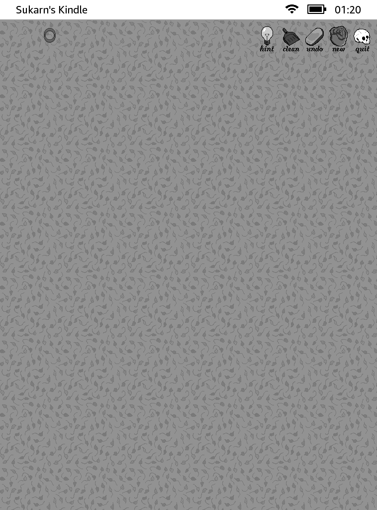

it looks like landscape shown in a portrait view.
I.E: the horz and vert sizes are exchanged (which on a Kindle, they are compared to a CRT screen).

Maybe you need to find a way to rotate the display? Mahjong is generally in landscape anyway, isn't it?
The current status is that it's looking okay and accepting touches, but is too wide for the kindle's display, right?

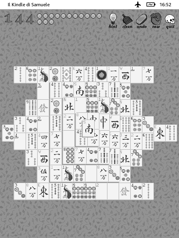

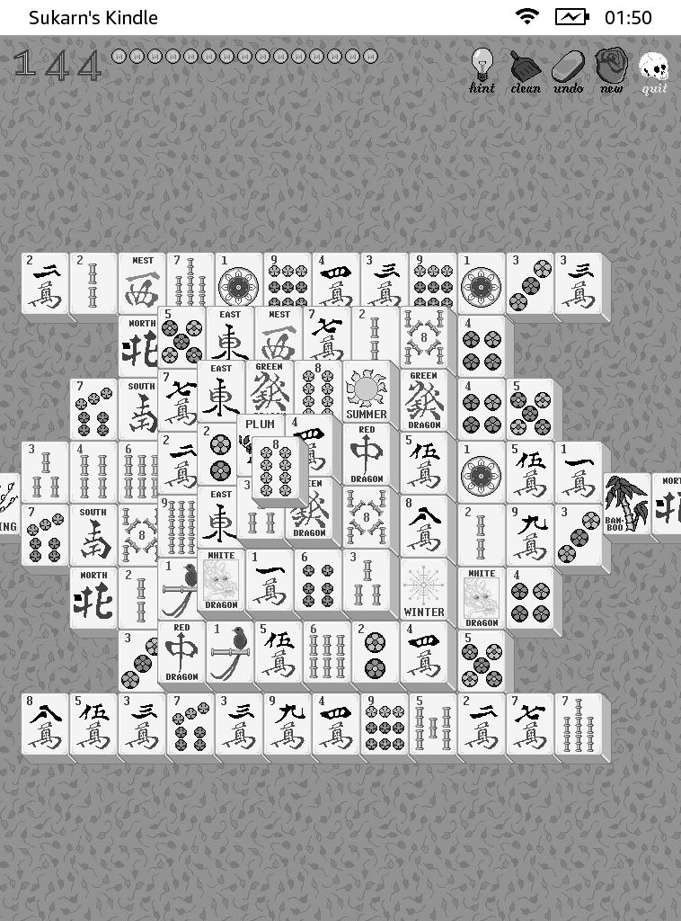

We can resize the tiles to make them fit the screen. The "gnome2" tileset is fitting well but it may be too small. I will post a working version soon.
Rotating the screen is a good idea, can we do it on the Kindle side?
Edit: here is the working KUAL extension. I made the gnome2_bigger tileset the default. It is the same as the gnome2 tileset, but bigger and with a sign to make blank tiles with black numbers different from the blank tiles with red numbers (it was hard to distinguish them in grayscale).

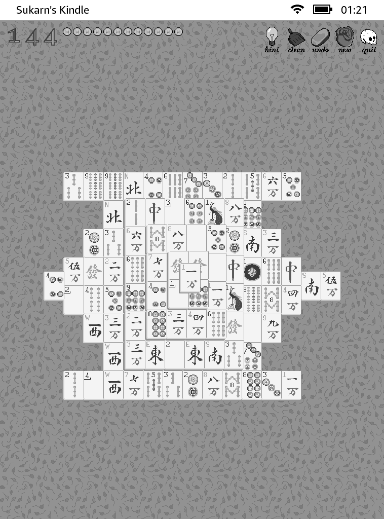

I can confirm that it is working and playable. I got to the end. I like where this thread is going.
But, it was difficult for me to play; almost headache inducing because I had to strain my eyes to play it. The tiles look too small on my PW2, the contrast looks very different in actual play compared to these screenshots, and I had to keep looking closely at the screen to figure out if there was a layer above another. These are NOT problems caused by your work.
So, I wanted to try a more optimal tile size for a PW2. As I couldn't find any obvious quick way to change the tile set through a config, I tried renaming dorothys.gif to gnome2_bigger.gif for a bigger tile set with good depth visibility. That did work, and the tiles were large as expected. Too large for the screen. Hence, the next step was to try resizing dorothys.gif to a smaller size to find the optimal size for my kindle.
That failed miserably. Images resized using GIMP and imagemagick both caused the game to fail to load.
If I can manage to resize dorothys without making the game crash, then I would be set. All game features are working fine. I don't even need to edit dorothys and make it dark on selection like the gnome2 tile sets as personally I prefer the way selected tiles are looking in dorothys compared to the tiles in gnome2 tile sets. Dorothys has good contrast, good depth perception, and is just slightly too big for my screen. One tile is getting partially cut off on each side.
The only thing I could wish for, would be a way to change screen backlight while playing the game, because leaving the game to change backlight and then coming back results in a new game. This might be beyond the scope of this port, though, so it's okay if this remains wishful thinking.

The only tileset I successfuly resized using GIMP was the gnome2 one, just make sure the width can be divided by 21 and the height by 4 ( w%21=0, h%4=0 ).
We could add different tilesets for every kindle and then choose the one to use from the start.sh script (just add "-t <tileset>" at the end of the command). I can test only on my KT2 which is 600x800.
For the other thing you asked, it would be possible to add a "save" function when Quit is clicked and a "load" funcion when the game is started, but I need to understand the game code better

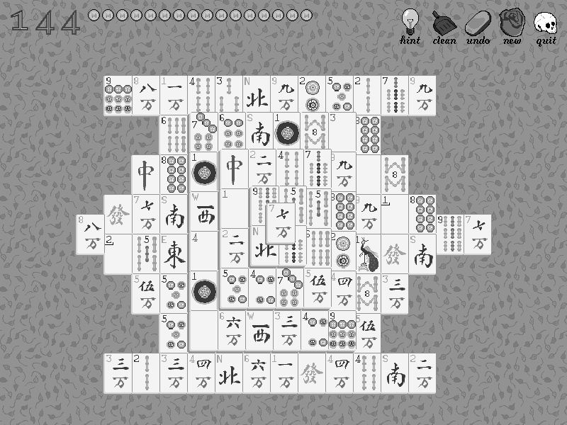

I removed the possibility to change the window name because on the Kindle it has to be in that strange format. I didn't knew about the landscape thing, so.. I've added a command line true/false switch "--landscape" and also set the landscape mode as the default one.
Then I found a way to check the screen resolution, the game will now use the "gnome2_bigger" tileset if the resolution is equal to 600x800, otherwise the default "thick" tileset will be used. We should collect data from all the different Kindles to choose the best tileset for each one but I need others to create/test and share tilesets since I only own a KT2.

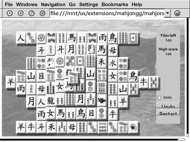

Has anybody noticed that there is an existing mahjong implementation in javascript, playable through the skipstone browser?
https://www.mobileread.com/forums/sho...d.php?t=196403
In addition to mahjong there's also: blockline, freecell, klondike, long, and pile.
These were for the Kindle Touch. I don't know if they would work on later models.

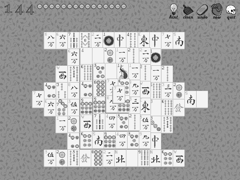

@knc1 thanks I've read the different resolutions in that thread but users still need to test tilesets on their Kindle to see how it looks. I've added a configuration file so anyone can choose what tileset to use without using the command line. Here is an example: https://github.com/sguerrini97/xmahj...re/kindle.conf

I've attached screen shots of both this and the older implementation. Taken from my KT3 (600x800 resolution). The tiles seem to look clearer in the older one?
