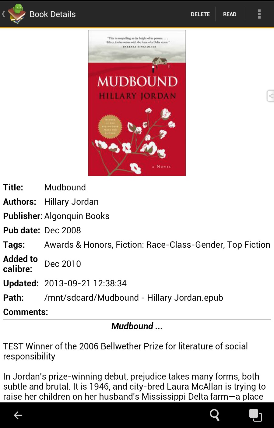

Charles, I just installed Calibre 1.4 and found the tweak for the compression level for covers sent to devices. I cannot get it to work.
First I tried level 90 and saw no difference in the Mudbound cover. I then put it at 99 and still couldn't see any difference. So I thought I'd test it at 50 just to see if the setting was having any effect, and I still couldn't see any difference. The cover always looks the same as it did before the tweak (when the level was 70). I cannot get it to look like the version you showed the other day.
I restarted Calibre after every setting change. What am I doing wrong? Is there another setting someplace else that also has to be changed? Is it my Nook HD somehow or ICS?
--Pat

Old 09-21-2013, 12:01 PM   #37
chaley
Posts: 12,529
Karma: 8075938
Location: Notts, England
Pat,
Covers are resent only if the metadata changes in some way (the last modified date changes). Changing the value of the device preference does not touch the last modified date, so probably nothing is being sent to CC.
You can test this with Mudbound by selecting the book, pressing E to open the metadata edit dialog, pressing OK without changing anything, then connecting CC. You should see it download metadata for at least one book, and the cover image should change.
After verifying that the cover did in fact change after you do the above, if you want to resend all your covers then you must change the last modified date on all books. There are several ways to do that.
1) When a device is not connected, press the down arrow next to the library toolbar button, choose Library Maintenance, Library metadata backup status, then press Queue all books for backup.
2) If you have a "column built from other columns" (a composite column), click on that cell for any book, press F2 to edit the template, then press OK.
3) Go to Preferences, Add you own columns. Choose any custom column, press the I button to open the column's properties, then press OK. Restart calibre.
Also, by "tweak" I assume you mean the setting in the smart device driver plugin. True?

Pat,
It's the drop-down menu that only appears at the top of the main window when you connect a device to calibre ... when you click the icon of the device. I selected "Configure this device" and then near the bottom of the window where it says "Cover thumbnail compression quality" I put in 90.
Is that not the right place?
I tried doing what you said, actually making a change in the comments section (see attached screenshot; I added the word "TEST") ... and still there is no apparent change in the quality of the cover.
Previously I had deleted the book entirely from CC, and resent the book and that also made no difference.
Is it perhaps my antique OS I am using, Windows XP?
--Pat
PatNY is offline   Reply With Quote
I don't believe I'm seeing a quality improvement either. To test I set the SmartDevice value to 99 and then added a very red cover to one of my test books in the calibre library which didn't originally have any cover. After doing a CC connect, I can see the new cover but it still looks pretty rough on the Details page.
You are both right. Sometime between when I ran my tests and when I submitted the code to Kovid, one critical line of code went walking -- the line that actually set the desired quality to what is in the configuration. The quality is stuck at 70.
I have no idea how I did such a stupid thing, but I did. As a consequence you won't see the improvement until next week, assuming I don't do something equally stupid again. Given my recent record, I won't ignore that possibility.

Just to make more nuisance, on a completely different topic, please can you explain the following:
In my calibre tweaks 'Control how dates are displayed' I have the following settings
gui_pubdate_display_format = 'yyyy'
gui_timestamp_display_format = 'dd-MMM-yy'
gui_last_modified_display_format = 'dd-MMM-yy'
On the CC Details page,
Pub date and Added to calibre are displayed as 'yyyy'
Updated and Read are displayed as 'yyyy-mm-dd hh:mm:ss'
The only one I'd prefer to display differently is Added to calibre where 'yyyy' is not really enough info to be useful. Am I missing a setting somewhere?
This is a bug that has been there since the birth of CC. I am surprised that you are the first to notice. CC is using the pubdate format instead of the timestamp format to display the "added to calibre" (the calibre "date" field). I fixed this. CC has the right format for both of them, it simply used the wrong one to display "date".
CC doesn't display calibre's last modified date. The date you are seeing is CC's last modified date, for which there is no format modifier.
