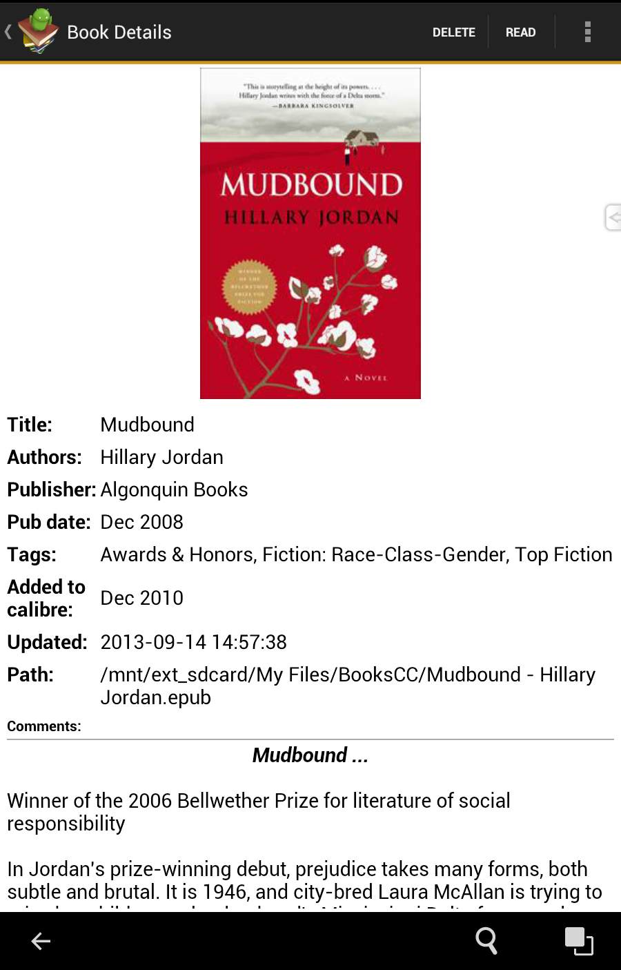

I have noticed that on a few thumbnails in the book details page, the color is very splotchy. It is ONLY apparent with covers with big areas of a bright red color. I don't notice it on any other colors, or even on darker reds/maroons. Just bright red. See attached screenshot of one such book.
Does android not like the color red?
Seriously, is there any way to avoid this? If the tradeoff were a much larger database or a slower import, I fully understand the preference to keep things the way they are. But perhaps there can be some tweak that doesn't negatively impact some other area?
I have my thumbnails set to large in the book details page. The book cover image is 1406 x 2104 pixels and is 274 KB. I have book covers on my device that are larger than that but don't notice any peculiarities in the thumbnails like with the red ones. And viewed at 100% on my computer it looks fine. If you'd like, I can send you the actual cover image.

CC does nothing special with covers. To be precise, when CC connects and asks for metadata:
0) You add a cover to calibre. I don't think that the cover is processed at all.
1) Calibre creates a cover "thumbnail", usually 320 pix by 320 pix, aspect ratio respected. Tool = imagemagick, format = jpg, compression quality = .7
2) Calibre sends that thumb to CC.
3) When needed, CC explodes the jpg into a bitmap with standard Android tools. Usually the image is sized down (made smaller), but it is possible that it might be sized up a bit.
My guess is that it is the step in calibre/imageMagick that doesn't like red, but I don't know that. If you send me the cover I will try to find out what tool is causing the problems.

OK, I see what is happening. As I mentioned, calibre uses a .7 compression quality index when creating the thumbnails. For this cover, it produces a size of 7,000 bytes. If I change the quality to .9 then the size goes up to 12,000 and the compression artifacts are largely gone. See the attached cover.
I will add a tweak (or something) to calibre to let you set the compression quality. The question is should this be by-device or calibre wide?
