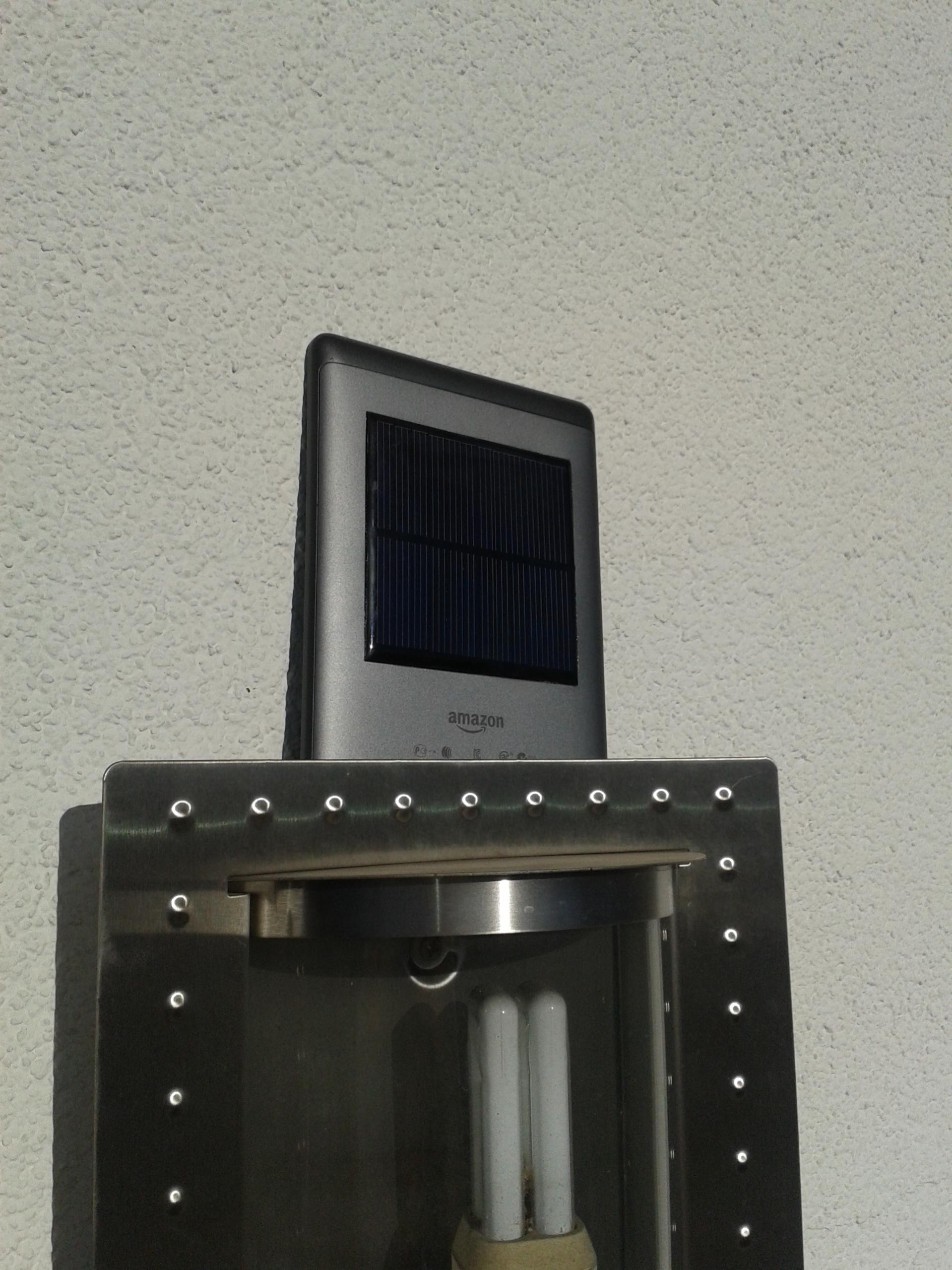

after one and a half years with my solar powered Kindle, I decided to build a new Version of it.. (Version 1 is now powering my mothers Kindle)
It turned out that especially in the winter season with short days and high air mass factors the thin-film solar cell I used is just to weak.
So I looked for another solar cell and found this one here:
http://www.ebay.de/itm/1x-6V-150mA-0...item3cc4c111d0
It should provide twice as much current as the one I used before. And beeing a poly solar cell I also hope for better perfomance with indirect sunlight...
The only problem: The cell is about 3mm thick, so I had to mill a hole in the back cover so it doesn stand out that much.
I also adapted the circuit slightly: The capacitor that smothens the voltage from the solar cell is now 10 uF instead of 1 uF. I hope that will bring me higher charging rates as the voltage won't drop that fast in low-light conditions. The idea is that the solar cell fills up the capacitor, after the threshold voltage for the circuit to start is reached, power is transferred to the battery..
Right now it is sitting outside in the winter sun, even under these conditions I get charge rates of 115 mA with WiFi enabled!

nick-tech, that is really cool what you have done. upset i did not see it sooner!
and the new and updated solar panel you found is super cheap, i would love to put one in my paperwhite, although i use a cover for mine and wouldn't want to go without it. hopefully in the future solar panels will be built into all screens, and not noticeable, haha.
although, if you are using this intermittently, 30 minutes every day etc, is it bad for the battery at all, to charge/discharge a lot without reaching the top or reaching the bottom, i imagine so...? (i'm not talking about battery memory etc, which does not happen with new batteries anymore, but, just generally.)
zxczxc is offline   Reply With Quote

Hi zxczxc,
no, LiIon batteries don't have that problem. It doesn't matter if you charge them every day by a few percent or completely ever other week or whatever. For LiIons its even better not to use the complete capacity, for example charge it to 80% and discharge to 60 % only.
Just to put it clear: I'm not using the internal charge logic. I use a special charge IC (Maxim 1551/1555) that is directly soldered to the +/- connectors of the mainboard (and thus connected to the battery)
This IC brings an own charge curve with 30mA for completely discharged batteries (which should never happen because the kindle software will turn the device of before), 280mA for normal charge (here the power from the solar cell is the limit), a reduced charge rate for nearly full batteries (i.e. cell voltage above 3.9V) and a charging stop at 4.18V
