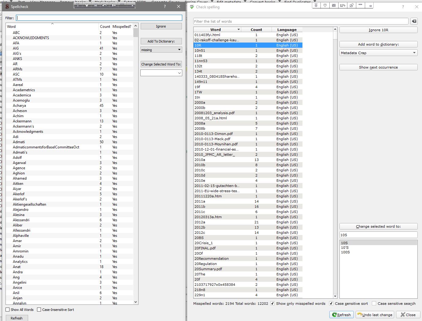

With regards to the settings you mention (talking about giving a finger...). Numbers are ignored by default, also with the Hunspell engine. However, words partially number, partially letters are not ignored and with reason. Often these are the result of OCR errors, one example which occurs often in Dutch is '2o' instead of 'zo'. Therefore I am doubting to make that an option. The same goes for Words in capitals, often these are smallcaps not identified correctly by the OCR process. The internet addresses might be possible, I will look into this. I might incorporate these options, but I am not sure yet.
Numbers are my main concern, I only mentioned the UPPERCASE and urls for 'completeness' sake.
I raise it because the spell checker in Sigil does ignore some words with numbers, but the spell checker in calibre doesn't ignore any - but both purport to use hunspell. If you're interested spellcheck this -- untitled.epub -- in sigil and calibre
The following is the same real book - sigil on the left, calibre on the right, with same dictionaries.
In the following index entry, Calibre reports 235n32 as a misspelling, but Sigil doesn't - and it is not because of semantic settings.
<a class="normal" href="../Text/Notes-1.html#page_235">235n32</a>
I raise it because the spell checker in Sigil does ignore some words with numbers, but the spell checker in calibre doesn't ignore any - but both purport to use hunspell. If you're interested spellcheck this -- Attachment 146820 -- in sigil and calibre
Attachment 146819
But for real books such as the one above I only convert them to DOCX for the purpose of iFilter based content searching. I would never spell check it in Word.
I have incorporated this, so my spelling engine uses the same settings as Word. However, I will also create a setting to ignore this for my specific procedure, as I feel that it would bypass several spelling mistakes. I will also set a strong warning about these settings in the manual.

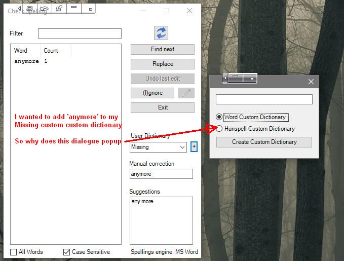

@Toxaris - How do I set the Hunspell dictionary - I was hoping I could 'use' the dictionaries I have in Sigil - that's the real dictionaries (dic and aff).
When I replace a word from the suggested list, I am then asked to confirm the replacement, can there be an option to suppress that.
I don't understand this:
The various spellcheck windows/dialogue-boxes appear at top right corner of monitor. If the taskbar is positioned vertically on right edge, as mine is, the windows/dialogue-boxes are under the taskbar, to use them they have to be dragged out. Given the last used positions are not saved I suggest it would be better to centre them.
