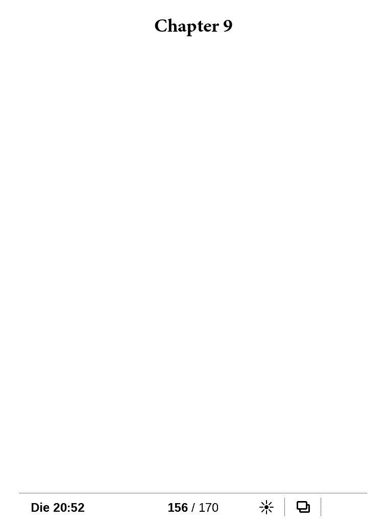

Unhappy FFDL 2.1.0 not stable on XP and other Bugs...
Hello,
Is ist possible to get somewhere the version 2.0.10 or older, because the current 2.1.0 does not work for me on XP with Calibre 1.48 , it crasches with the following error:
"calibre worker process hat ein Problem festgestellt und muss beendet werden."
"caliber worker process has encountered a problem and needs to close."

on Win7 with Calibre 2.12.0 it runs whitout the crash, but it sometimes makes epubs that are unreadable on an Pocketbook PB626 with FW4.4.
As for the new added chapters there is only the title visible an the rest of it seem blank, when i use thry to go to the next page it goes to the next chapter which is some pages away (see the pics and the ePub).
The problem is regardless of whether you use the AdobeViewer or the fbreader.
In the build-in reader of Calibre it shows fine.
In the MOBI with the fbreader format it works.
Attached is 2.0.10. It is *not* a new version.
I won't have time to look at this issue in any detail until tomorrow evening at the earliest. And even then, I can only look at calibre 1.48 on newer versions of windows.
thanxs, this version works good, and the ePub is "readable"...
