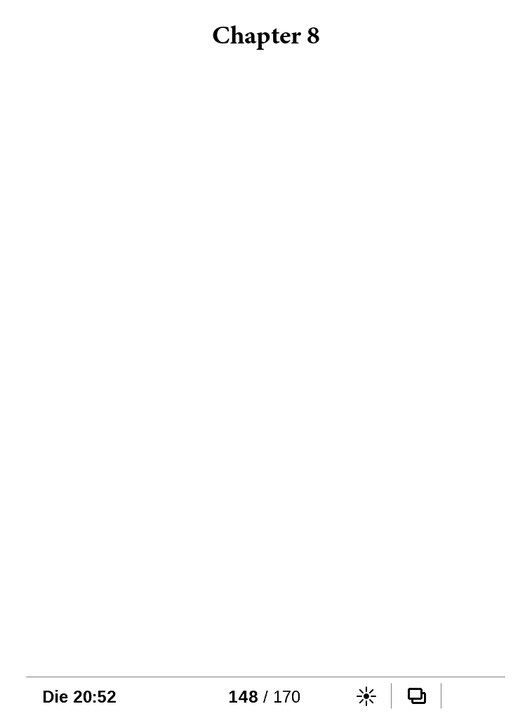

Hello,
Is ist possible to get somewhere the version 2.0.10 or older, because the current 2.1.0 does not work for me on XP with Calibre 1.48 , it crasches with the following error:
"calibre worker process hat ein Problem festgestellt und muss beendet werden."
"caliber worker process has encountered a problem and needs to close."
here is what calibre shows on the fail:
FanFiction-Buch herunterladen
FFDL:INFO:calibre_plugins.fanfictiondownloader_plu gin.jobs(36):FanFictionDownLoader v2.1.0
FFDL:INFO:calibre_plugins.fanfictiondownloader_plu gin.jobs(40):Adding jobs for URLs:
FFDL:INFO:calibre_plugins.fanfictiondownloader_plu gin.jobs(42):http://www.hpfanficarchive.com/stori...y.php?sid=1249
FFDL:INFO:calibre_plugins.fanfictiondownloader_plu gin.jobs(78):Logfile for book ID 3381 (260 Going on 16 Uncensored)
FFDL:INFO:calibre_plugins.fanfictiondownloader_plu gin.jobs(79):url:(http://www.hpfanficarchive.com/stori...y.php?sid=1249) id:(3381)
FFDL:DEBUG:calibre_plugins.fanfictiondownloader_pl ugin.jobs(131):cookiejar:<_LWPCookieJar.LWPCookieJ ar[<Cookie PHPSESSID=32c9b00a28f1e3044d4d9db3c016fae3 for www.hpfanficarchive.com/>]>
FFDL:DEBUG:calibre_plugins.fanfictiondownloader_pl ugin.fanficdownloader.adapters.adapter_hpfanficarc hivecom(82):URL: http://www.hpfanficarchive.com/stori...y.php?sid=1249
FFDL:DEBUG:calibre_plugins.fanfictiondownloader_pl ugin.fanficdownloader.adapters.base_adapter(292):# ####################################
pagecache MISS: http://www.hpfanficarchive.com/stori...y.php?sid=1249
Python function terminated unexpectedly
'NoneType' object has no attribute '__getitem__' (Error Code: 1)
File "site.py", line 132, in main
File "site.py", line 109, in run_entry_point
File "site-packages\calibre\utils\ipc\worker.py", line 195, in main
File "site-packages\calibre\utils\ipc\worker.py", line 139, in arbitrary_n
File "calibre_plugins.fanfictiondownloader_plugin.jobs" , line 83, in do_download_worker
File "calibre_plugins.fanfictiondownloader_plugin.jobs" , line 83, in <lambda>
TypeError: 'NoneType' object has no attribute '__getitem__'
on Win7 with Calibre 2.12.0 it runs whitout the crash, but it sometimes makes epubs that are unreadable on an Pocketbook PB626 with FW4.4.
As for the new added chapters there is only the title visible an the rest of it seem blank, when i use thry to go to the next page it goes to the next chapter which is some pages away (see the pics and the ePub).
The problem is regardless of whether you use the AdobeViewer or the fbreader.
In the build-in reader of Calibre it shows fine.
In the MOBI with the fbreader format it works.
Mfg. McHunter@gmx.net
Attached is 2.0.10. It is *not* a new version.
I won't have time to look at this issue in any detail until tomorrow evening at the earliest. And even then, I can only look at calibre 1.48 on newer versions of windows.

Device: PB TL2 /PB TL3 (M) STOLEN/ PB SURFpad 3 (7.85") / thl T11
thanxs, this version works good, and the ePub is "readable"...
