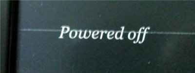

    (mod should display an automatically detected scanline for standby)
    Attachment 151716
  5. let the device power off (by either setting timeout, or holding power button)
    (mod should display an automatically detected scanline for poweroff)
    Attachment 151717
    --- ScreenSaver should now be fully operational ---

Hello! I just got my Kobo Clara HD, and I tried this hack to the letter, as far as I can tell. My issue is that although I can tell the device is registering the PNG files as I see them as "books", I can't get them to appear as a power off or sleep screen.
My process was:
1. Downloaded the KoboRoot-ScreenSaver-20181216 zip file.
2. Extracted the files
3. Renamed the KoboRoot-ScreenSaver-20181216.tgz to KoboRoot.tgz
On the Kobo:
4. Turned off the Show Current Read option
5. Mounted the device and the file explorer opened up
6. Went into the .kobo file and pasted the KoboRoot.tgz file
7. Ejected the device and unplugged when the notification for removing safely appeared
8. The Kobo did reboot, but I didn't see the line that you describe, I don't believe
9. Remounted the device and found the .addon file
10. Pasted in my choice image as a PNG file amongst the existing options
11. Uninstalled that configuration using Notepad++ like recommended
Like I said, I can see the images in the books section as PNG files, but my power off and sleep screens still read "Power off" and "Sleeping".
Do you have any tips you could offer as to what I may have missed?
momo3513 is offline   Reply With Quote

You missed this
Originally Posted by frostschutz View Post
Please note this is a built-in feature since Firmware 4.13 according to @davidfor
---> https://www.mobileread.com/forums/sh....php?p=3868795 <---
The mod hasn’t been updated because it’s no longer needed. Kobo implemented it.
My process was:
On the Kobo:
Place your screensaver images in a directory called screensaver inside the .kobo directory. Please note that the directory name is case sensitive. I suggest using images close to the screen size of your Kobo (I modified my image choices to match the screen size and gray scaled them at the same time using ImageWorsener).
Under Settings => Energy saving and privacy, I have Show current read and Show book covers full screen checked.
