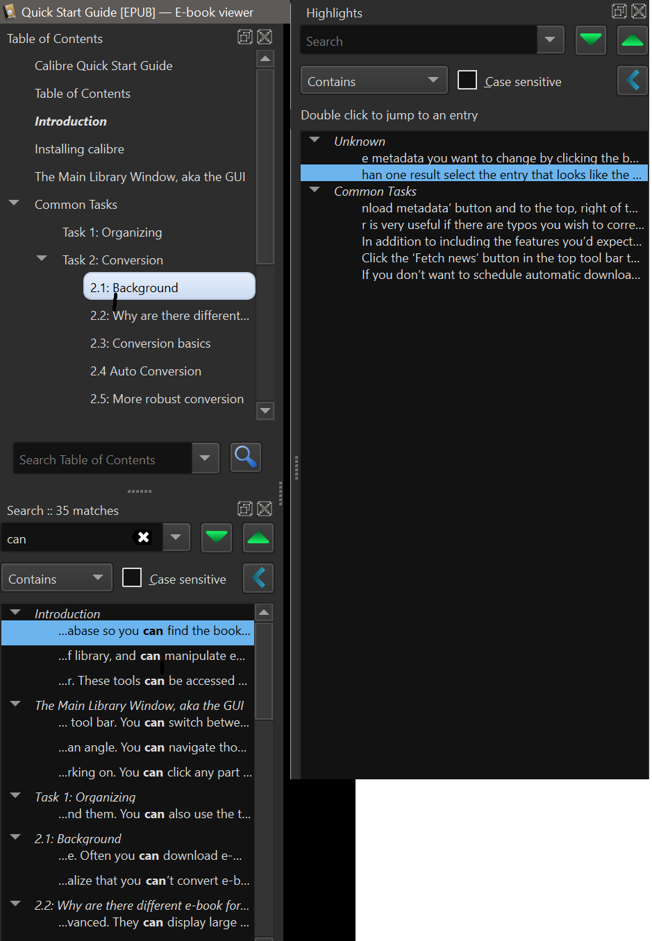

@kovid
1) It is deliberate, there is too much segmentation if you use the full toc tree. One then has to drill down through multiple sections to get to the actual highlight.
Could it be an option to toggle on/off? I don't think I would mind having to drill down, we already do so in the actual TOC and in the Authors, Tags, etc... panes in the main window.
In fact, as can be seen in the screenshot below, the Search in Book function has results segmented down to at least 3 levels, but they aren't nested. It simply displays with all expanded. I'd love to see the same for highlights, except nested (and perhaps nested as well for Search in Book).
A further suggestion: Perhaps even have an expand/collapse all button in each pane?

3) I dont see what's special about the highlights list. All tree views in calibre are like this. Adjusting individual trees by a pixel or two is just a recipe for chaos.
Where else is there a narrowly spaced list like this? As can be seen in the screenshot above, the TOC and Search Results panes have nearly double-spacing. So, I'd actually modify my original request from a couple pixels to 10+, or whatever is used in those panes - they're MUCH easier to read than the Highlights Pane.

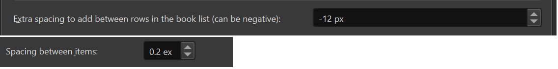

I've even just discovered two different features to change spacing in between rows in the book list and tag browser!
Name:	row spacing.png
So, perhaps the solution is what it has been for most of the annotation features - make it user customizable, like above?

@nixsee: Its the default spacing for item views. Pretty much any item list that has not been specially customized will have that spacing. For an example look at the search panel you yourself reference.
I have looked at the search panel... I included a screenshot that clearly shows that there is nearly twice as much spacing in the Search and TOC panels than the Highlights panel. I have attached the same screenshot again for reference.
To my knowledge, I haven't changed anything for them to appear that way. So, I would love if the default spacing for Highlights matched the default spacing for TOC/Search.
Name:	Calibre Segmented Sections.png

@Ridcully: Do a bit of searching and you will find tons of bug reports about calibre 4 not working on windows 7 because of qt webengine. Since calibre 4 was released while windows 7 was still officially supported by Microsoft, I allowed calibre 4 to run on win 7 that is no longer the case with calibre 5 and given that it has a further updated version on webengine,it is likely to fail on even more win 7 computers.
@nixsee: that is because there is space in the search panel entries to display icons, since I added a display of highlight stye as icons in the highlights panel as well, it will now be identical.

2) The viewer highlights panel now shows the style of each highlight
next to the entry and the grouping is by the lowest level in the ToC,
not the highest.
