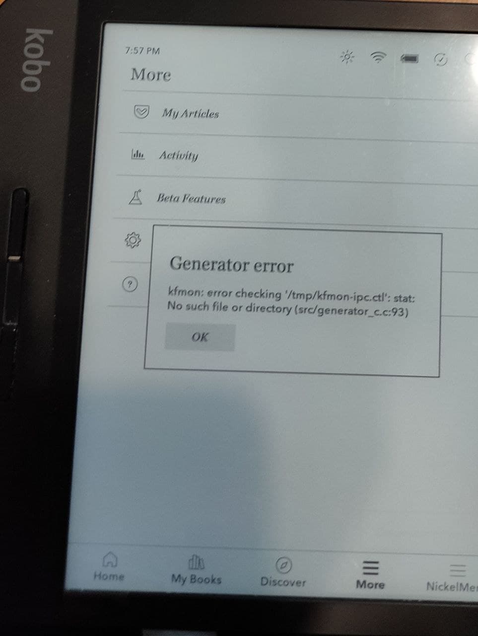

After installing the latest Kobo firmware update, when I went to start KOReaer, I got an error message I did not see after the only other firmware update I've installed since starting to use KOReader. Do I have to reinstall KOReader from scratch, and will I lose all my settings?

You need to reinstall kfmon, not KOReader.
Anyways, reinstalling KOReader is safe. Your settings are not contained in releases so there's no risk of overriding them.
When in doubt use NiLuJe installers for Kobo.

How do I install kfmon? I used the one-click KOReader installer originally. A big part of the appeal was the idea of having it persist through firmware upgrades, which it did not do this time.

The OCP script handles the KFMon install package just fine for that very reason .
NickelMenu/KOReader/Plato persist through updates just fine.
KFMon doesn't, for safety reasons (an unexpected behavior change in Nickel could otherwise result in a boot loop).
You can either:
* Run the OCP install script on one of the full packages again, as reinstalling KOReader/Plato is effectively harmless.
* Run the OCP install script on the KFMon install zip archive only.
* Switch to a pure-NM setup (the config files are installed in the .nm folder, with the relevant entries commented out).

Thanks. A couple of questions, especially as I have been thinking of doing a full NM install recently:
Is there a 1-click NM install?
If KFMON does NOT persist through firmware upgrades and because of that my KOReader is inaccesible after a firmware upgrade, do the settings and customisations persist, and is is this also true of NM?

All the OCP packages bundle NM, and any and all custom configs are unaffected by anything short of a factory reset .
