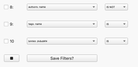

Hello,
I installed MCS and when i tried to use it, i found that in certain parts of MCS the font is so small that i am not able to read it.
See the attached pic...
Is there any way to change that?
Thanks very much!

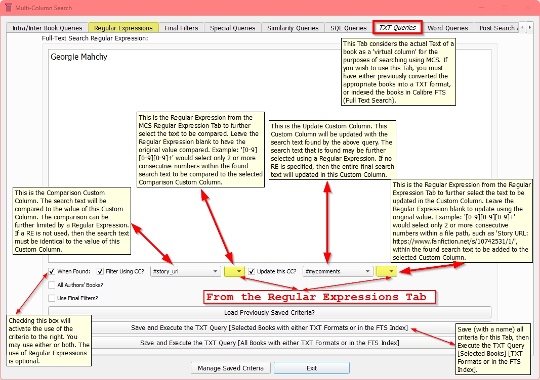

Version 1.0.90 TXT Queries Tab: Add searching of Calibre's FTS DB
Version 1.0.90 - 30 October 2022 TXT Queries Tab: Add searching of full-text-search.db if a format of .txt does not already exist.
Many Fan Fiction users download their stories in TXT format, and also use the TXT Queries Tab option to update Custom Columns based on their Queries.
See the attached image.
Added: Examples of Custom Column "Types" that this Tab was designed to update based on their Queries is shown in another image below. So, any "textual" Custom Column may be used: Comma Separated (Like Tags); Ampersand Separated (Like Authors); Comments (Short Text or Long Text).
For simple textual values to be updated, and that do not need to be in the Tag Browser, choose "Comments Like Short Text (e.g. a Title).
To test your regular expressions before you try to update anything, I recommend: https://pythex.org/

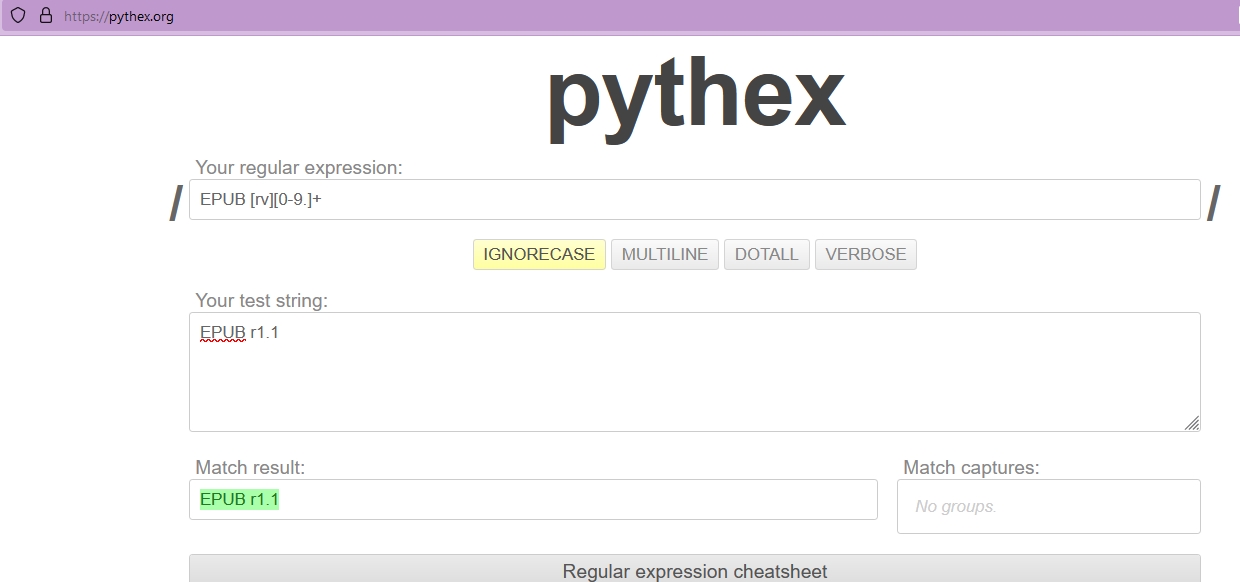

3 different regexes possible (only #1 is required)
See the 2 images at the bottom of: https://www.mobileread.com/forums/sh...8&postcount=24
Read the ToolTips in the image of the MCS Tab.
In MCS in the TXT Query Tab, there are actually 3 different regexes possible (only #1 is required):
[#1] Your (e|E)(PUB|pub|Pub)\s(v|r)(\d\.\d) which is the TXT Query itself.
[#2] The "Filter Using Custom Column" regex, which you do NOT need here.
[#3] The "Update This Custom Column" regex, which looks at the text returned by your #1 above: "(e|E)(PUB|pub|Pub)\s(v|r)(\d\.\d)". So, #3 must take the text like "ePub r1.3" and extract only the "1.3".
Your #revision Custom Column must be textual, not numeric or any other Type. Refer to the 2nd image in https://www.mobileread.com/forums/sh...8&postcount=24
The answer to your question of "What regex #3 should I use?" is shown with its test case in an image below: [0-9.]+
Personally, I would not have used any capture groups since the MCS function looks at all of the returned text, and not any single group results. You cannot specify in MCS which group to use. All of it is always used, so your regex must not require a specific group be used. See the 3d image below for a simpler regex to use instead of your grouped #1. "EPUB [rv][0-9.]+" using IGNORECASE.
The MCS TXT Query regular expression function always compiles with IGNORECASE. Makes things much simpler. The Python regex compile is:
re.escape("\\")
p = re.compile(re_string, re.IGNORECASE|re.DOTALL|re.MULTILINE)
match = p.search(s_string)
Note that since it uses MULTILINE and DOTALL, in some cases it would be necessary to specify where the selected text ends, such as with a trailing \s* . Search the web for: "regular expressions how to stop selection of characters at new-line".
Also see the related image here: https://www.mobileread.com/forums/sh...21&postcount=2
