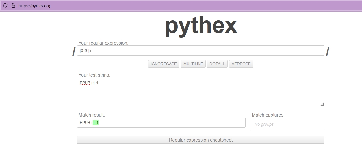

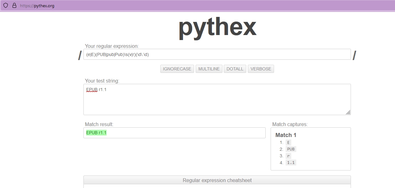

3 different regexes possible (only #1 is required)
To test your regular expressions before you try to update anything, I recommend: https://pythex.org/
See the 2 images at the bottom of: https://www.mobileread.com/forums/sh...8&postcount=24
Read the ToolTips in the image of the MCS Tab.
In MCS in the TXT Query Tab, there are actually 3 different regexes possible (only #1 is required):
[#1] Your (e|E)(PUB|pub|Pub)\s(v|r)(\d\.\d) which is the TXT Query itself.
[#2] The "Filter Using Custom Column" regex, which you do NOT need here.
[#3] The "Update This Custom Column" regex, which looks at the text returned by your #1 above: "(e|E)(PUB|pub|Pub)\s(v|r)(\d\.\d)". So, #3 must take the text like "ePub r1.3" and extract only the "1.3".
Your #revision Custom Column must be textual, not numeric or any other Type. Refer to the 2nd image in https://www.mobileread.com/forums/sh...8&postcount=24
The answer to your question of "What regex #3 should I use?" is shown with its test case in an image below: [0-9.]+
Personally, I would not have used any capture groups since the MCS function looks at all of the returned text, and not any single group results. You cannot specify in MCS which group to use. All of it is always used, so your regex must not require a specific group be used. See the 3d image below for a simpler regex to use instead of your grouped #1. "EPUB [rv][0-9.]+" using IGNORECASE.
The MCS TXT Query regular expression function always compiles with IGNORECASE. Makes things much simpler. The Python regex compile is:

Name:	regular expression number 1.jpg
ID:	197528   Click image for larger version
Name:	regular expression number 3.jpg
ID:	197529   Click image for larger version
Name:	simpler regex 1.jpg
