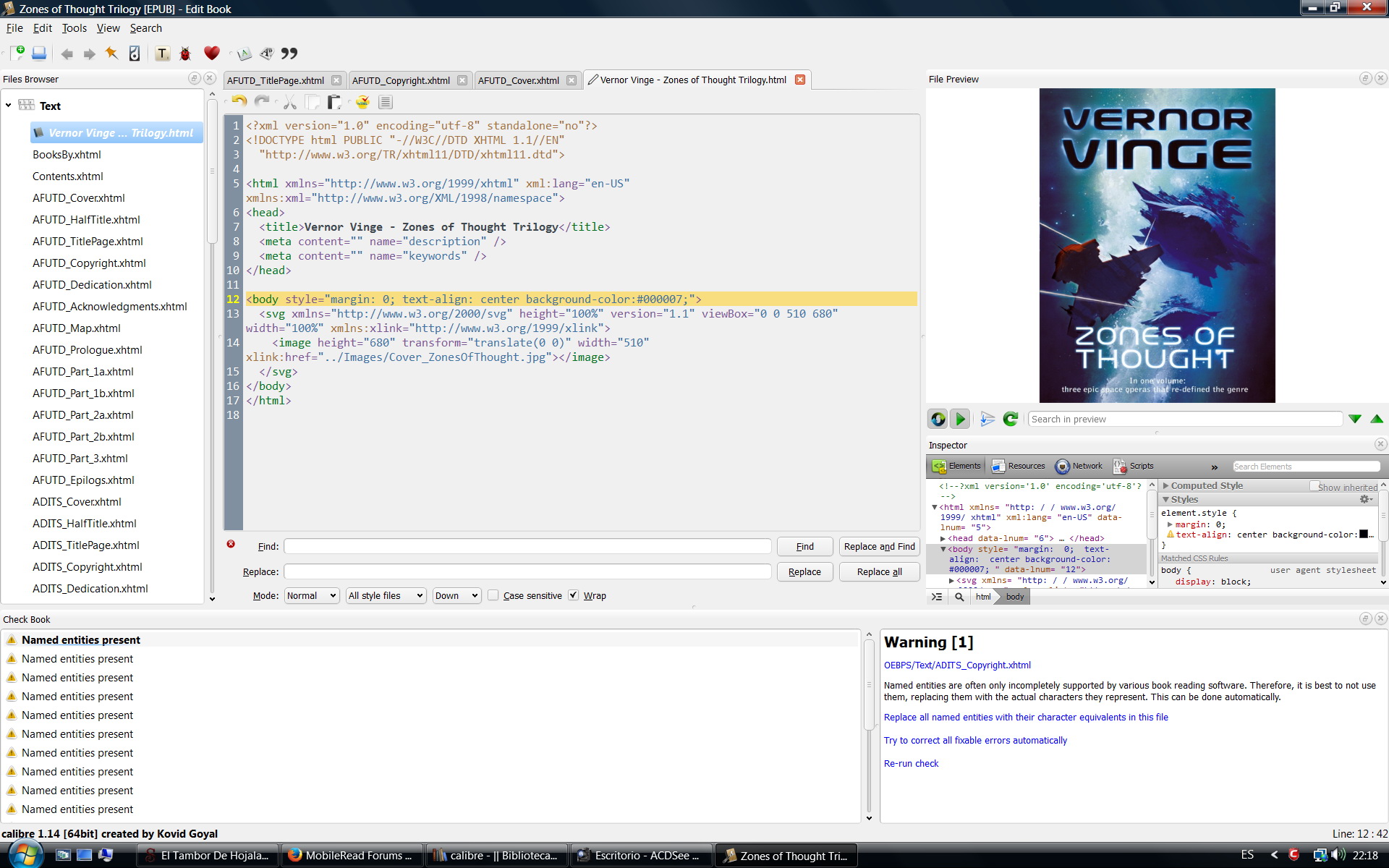

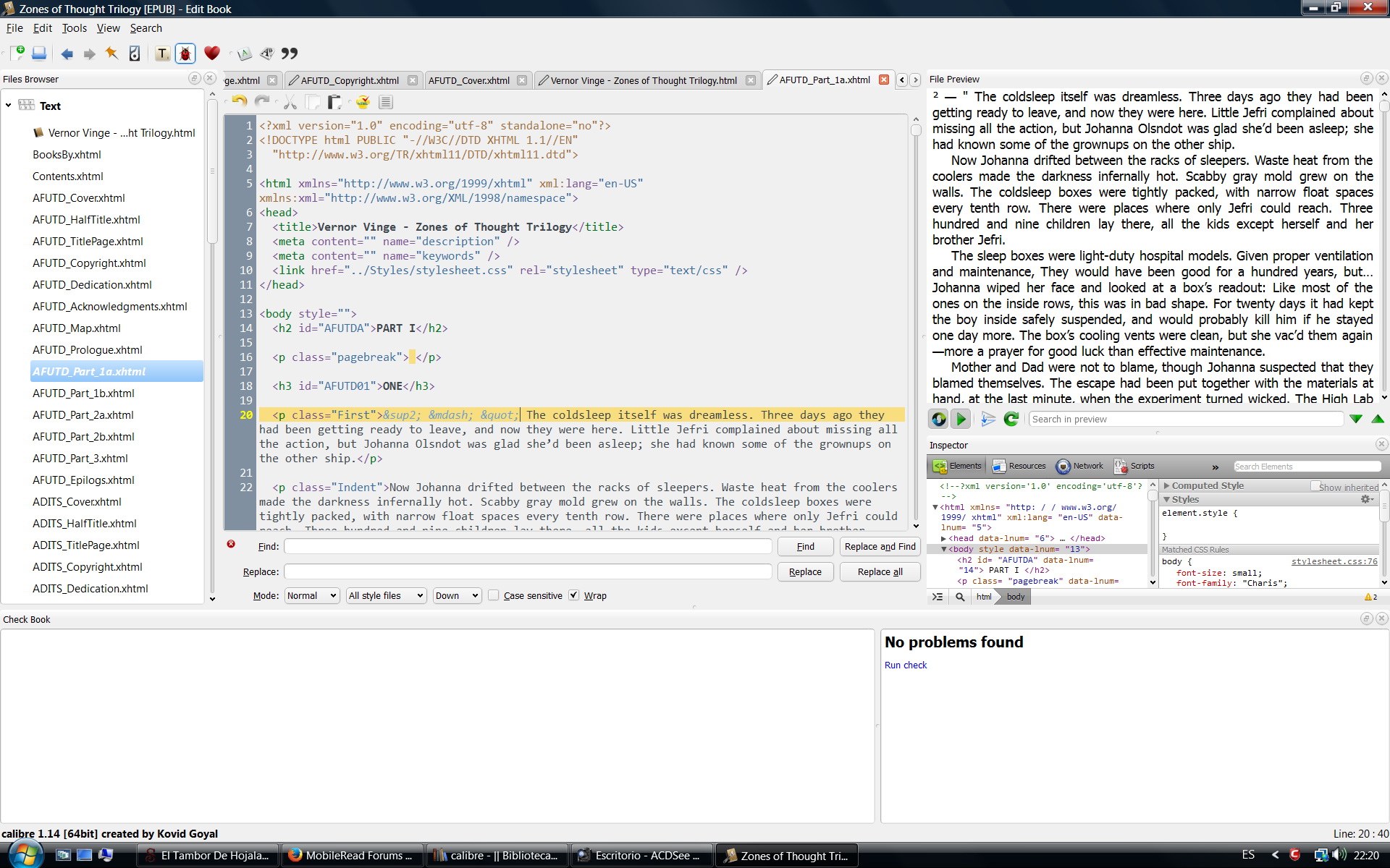

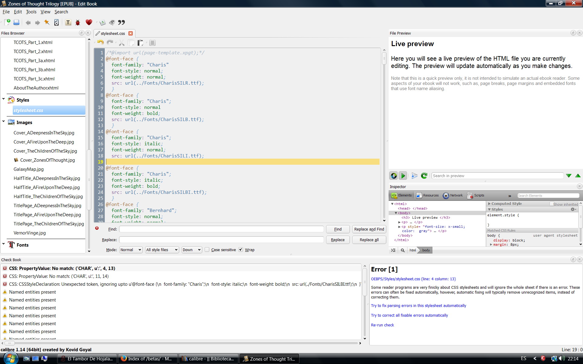

Originally Posted by arspr View Post
  • I know that you are going to ignore entities like   which is probably the best thing to do. But nevertheless, why   generates a warning/error but, as example, — or ² don't? Irrelevant? Or the symptom of another possible hidden issue?
Kovid, this issue is still present. I attach a screenshot ("Ignored entities.jpg") with some example entities in the beginning of line 20. No warning about them, but I get the warning with  . Intended? In that case, why is there a distinction between   and other ones?
1) Check Book now checks CSS as well, in stylesheets and inside <style> tags
Don't kill me, please
You forgot about styles inside tags... I attach a screenshot ("You forgot CSS inside tags....jpg") of a real book where I have deleted a ";" in the middle of it. (Line 12 between "center" and "background-color").
And then even another suggestion request (no real hurry about it). The next screenshot ("CSS Warning Texts.jpg") shows errors because of deleted ";" (lines 3 and 10) and a deleted "}" (line 19). I really, but really really, think that the error texts are completely UNfriendly. If you could somehow "translate" them to common world information, it would be really welcomed.

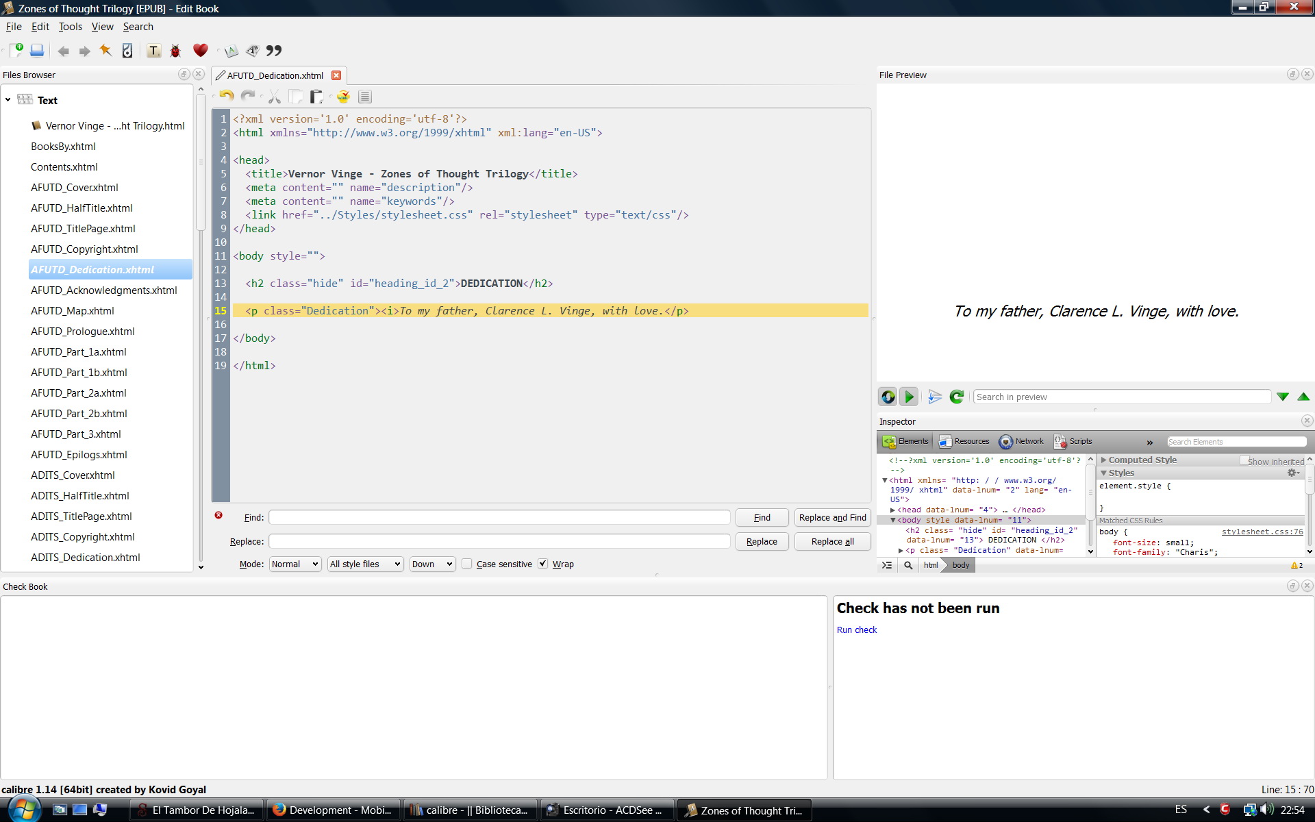

EDITED ----
And another possible issue. Please check "Before.jpg" and "After.jpg" (a Beautify action). I've deleted the ending </i> in line 15. When Beautify (or Fix HTML) is launched an extra pair of "<i> </i>" appears outside the paragraph (lines 17 - 21).

@Divingduck: Those are all non-standard css properties. You will be warned about any property not in the CSS 2.1 standard (plus a few from CSS 3). Extra CSS properties are usually harmless, so just ignore the warning, if you dont want to delete them.
@arspr: If you have modified text in an editor, all entities are automatically converted to unicode before checking, which is why you will not get message about them. Close and re-open the editor and you will see that.
I'm afraid the error messages come from the cssutils library, I really dont have the time/interest to make them more friendly. Patches are welcome.

The HTML 5 spec requires unclosed <i> tags to render the remaining text in italic, which is why you get an extra pair of <i> tags. It's a silly requirement, but it's in the spec, probably for legacy compatibility requirements. Try viewing the following html snippet in a modern browser,
<!DOCTYPE html>
<html>
    <head>
        <title>test</title>
        <meta http-equiv="content-type" content="text/html; charset=utf-8"/>
    </head>
    <body>
    <p>some <i>italic</p> after text  will also be italic
    </body>
</html>
