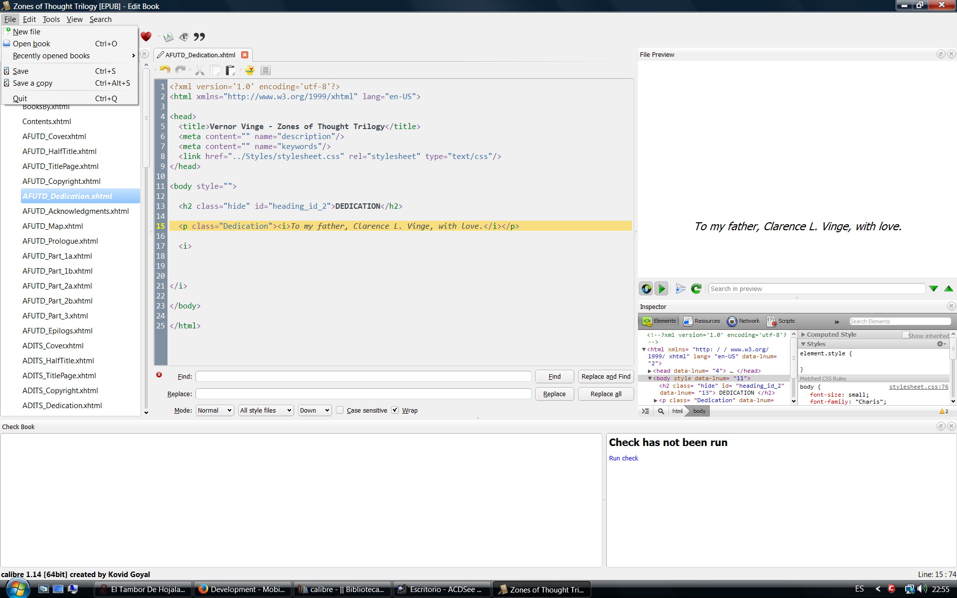

Is there a way to insert a new image? I can see how to delete or replace an existing image. Have I missed something?
jackie_w is offline
Old 12-12-2013, 11:26 AM   #313
Posts: 46,583
Karma: 29634066
File->New file
kovidgoyal is online now
Old 12-12-2013, 11:35 AM   #314
jackie_w
Posts: 6,354
Karma: 16800000
Ah, logical enough. I'd assumed that meant open a new epub!

I have changed the menu entry to read "New file (images/fonts/HTML/etc)"
