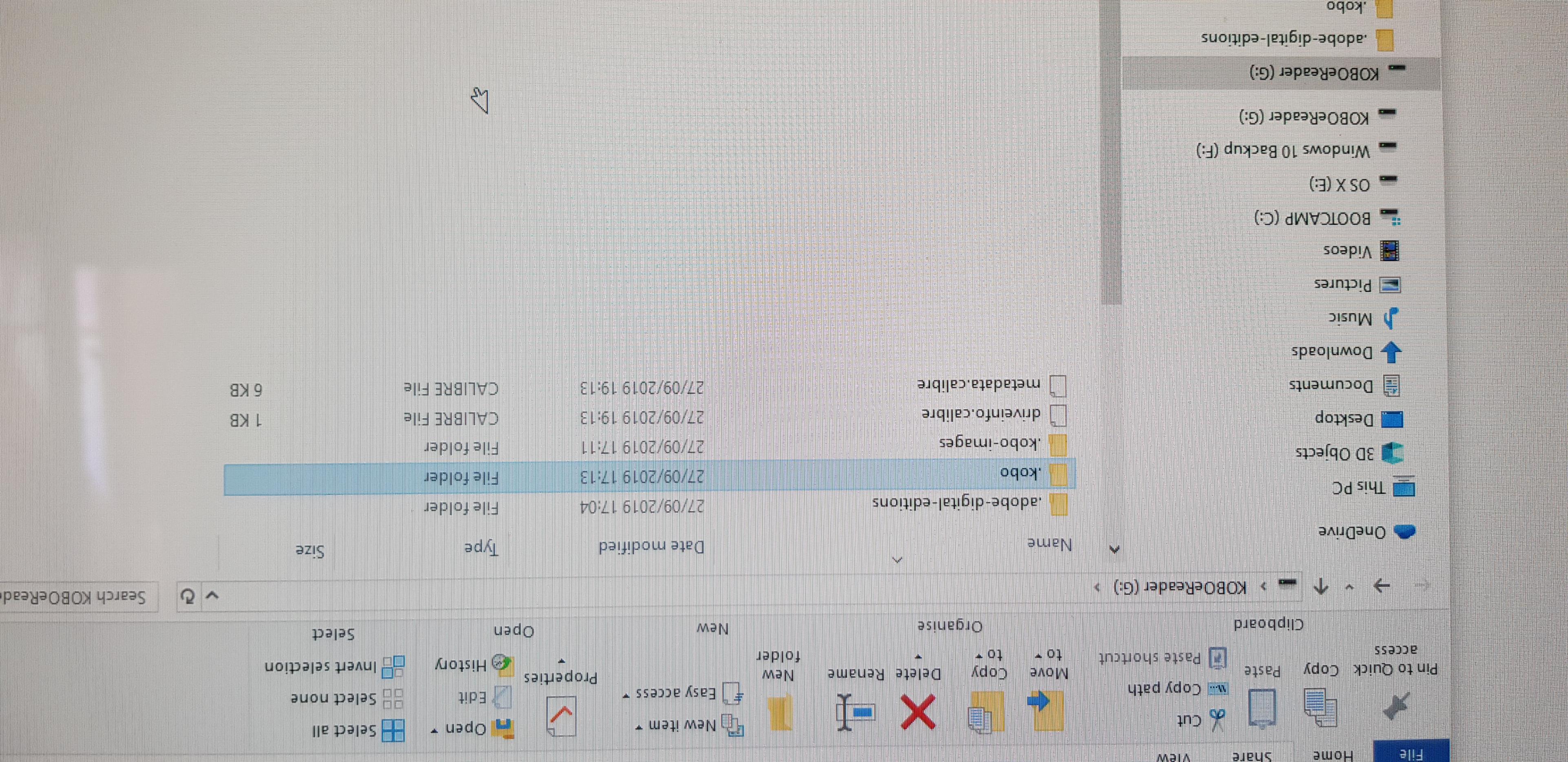

Something not right here, I did a factory reset and the clock is displayed but the files a missing as expected from a reset, see pics.

Parts of the mod need to live somewhere a quick factory reset won't get to. Only a full factory reset to the factory firmware will. I don't recall what triggers which exactly as that changed recently.

There's nothing in this (or any other) addon that makes it survive factory resets. Sounds like in your case only the user partition was formatted, but addons are installed to the system partition. That's not a factory reset (one that also reverts to factory firmware).
Also there's no need to factory reset just to get rid of an addon. Just uninstall it.
