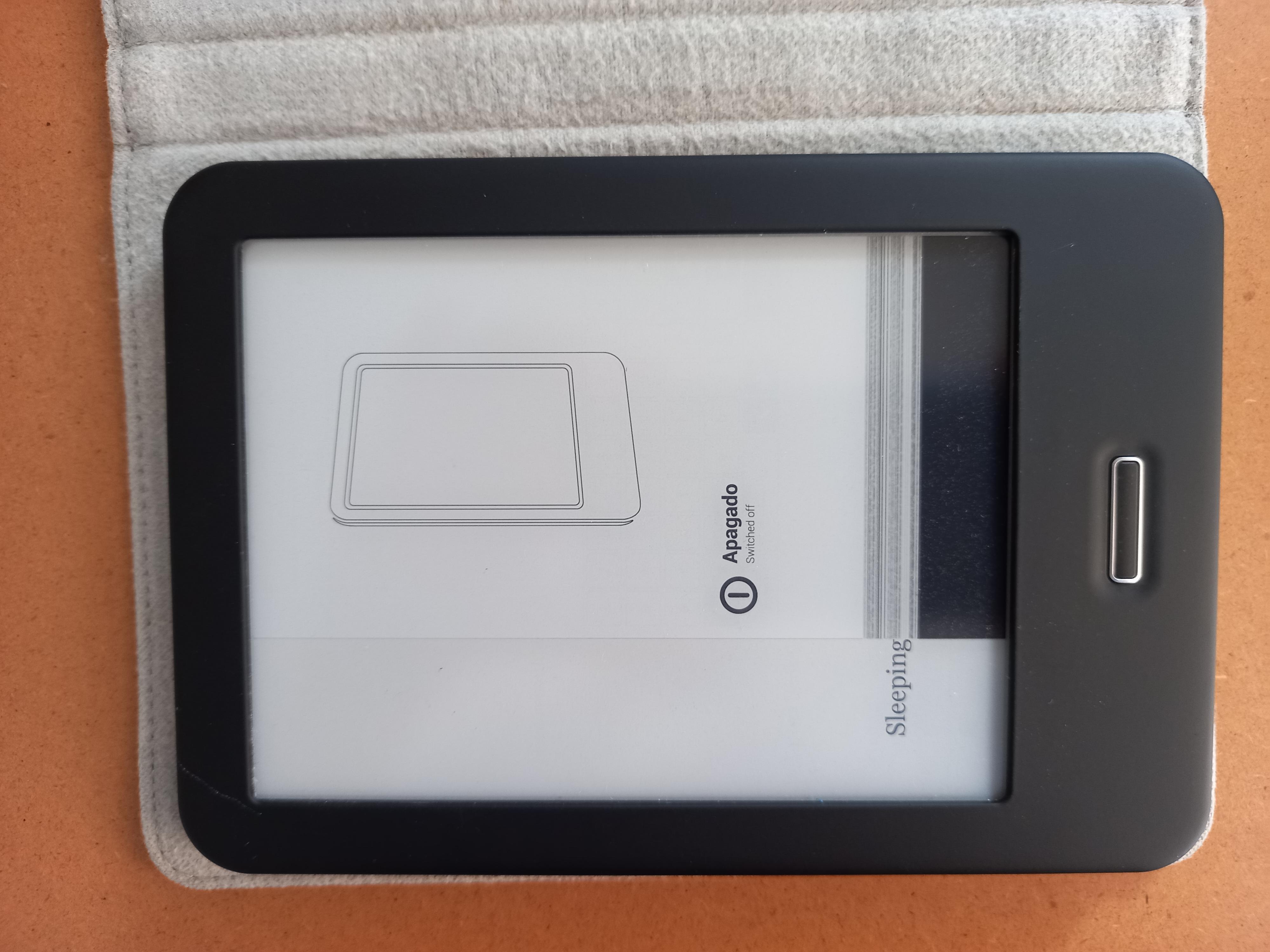

Originally Posted by daniel bastida View Post
I think it's too much for me
This is the main board
Nice pic. I don't see any obvious option settings. Likely it's a parameter written in the boot section of flash memory.
Double check the socket for dirt / fluff / hairs and reconnect the ribbon.

A broken substrate is noted for curved lines. Controller/cable issues are noted for straight lines.
To your previous question,
Yes, the screen arrived in sleep mode.
I've reconnected the two flat cables.
The image remains the same, reduced in one corner, and in that useful area it looks perfect... the touchscreen is still fine and still in full screen.
The only thing that's changed is the pattern of horizontal lines in the lower area that's "off-screen."
Now, perhaps what I'm interested in is knowing which e-book models can use this ED060KC1 screen model.

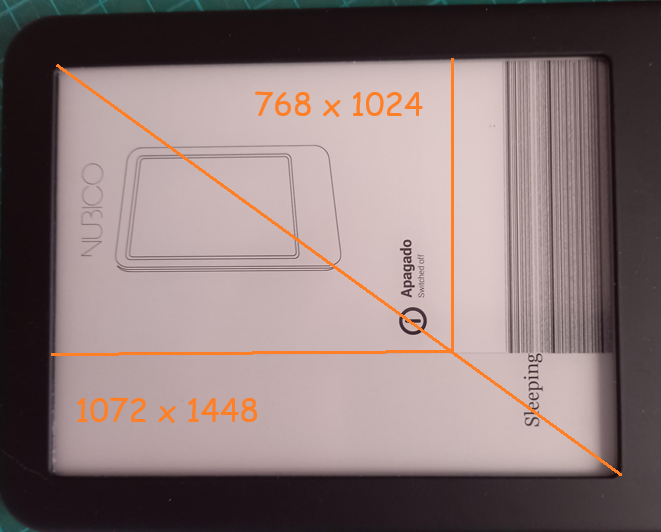

Any help?
Yes. I think that it's just misconfigured, possibly from misreading the identity of the panel.
Why did you replace the panel? General failure?
This is Android, right? Do you have ADB enabled?
If you have a problem reconciling touch you can use a mouse if this supports it.
(That's just to get you through testing, not a solution!)
The native display is landscape with the origin in the upper left in your photo, so it looks like it's working fine.
I would have expected that startup would have wiped the entire screen as that stuff is pretty hard coded.
This device, iMX6 is similar to older B&N Nooks.
If you get ADB working, try:
C:\>adb shell
$ wm size
$ wm density
$ wm size reset
$ wm density reset
If it gives you funny numbers on size you can try
$ wm size 1072×1448
But always use bigxsmall or smallxbig whichever you got the first time.

I think that it thinks that the display is 768 x 1024.
I thought the same, but the resolution of the ED060KC1 screen and the book is 1072x1448
Yes, they are both the same.
But your device thinks that it's connected to a 768 x 1024 display.

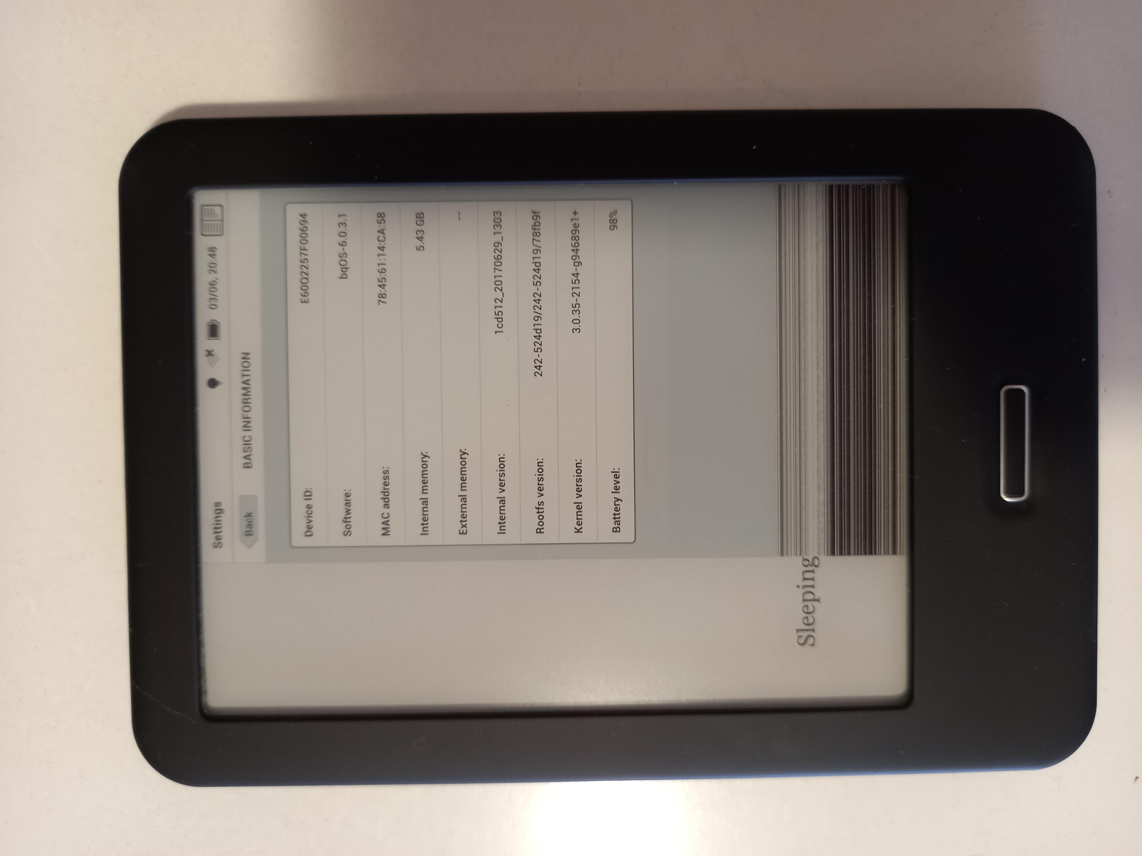

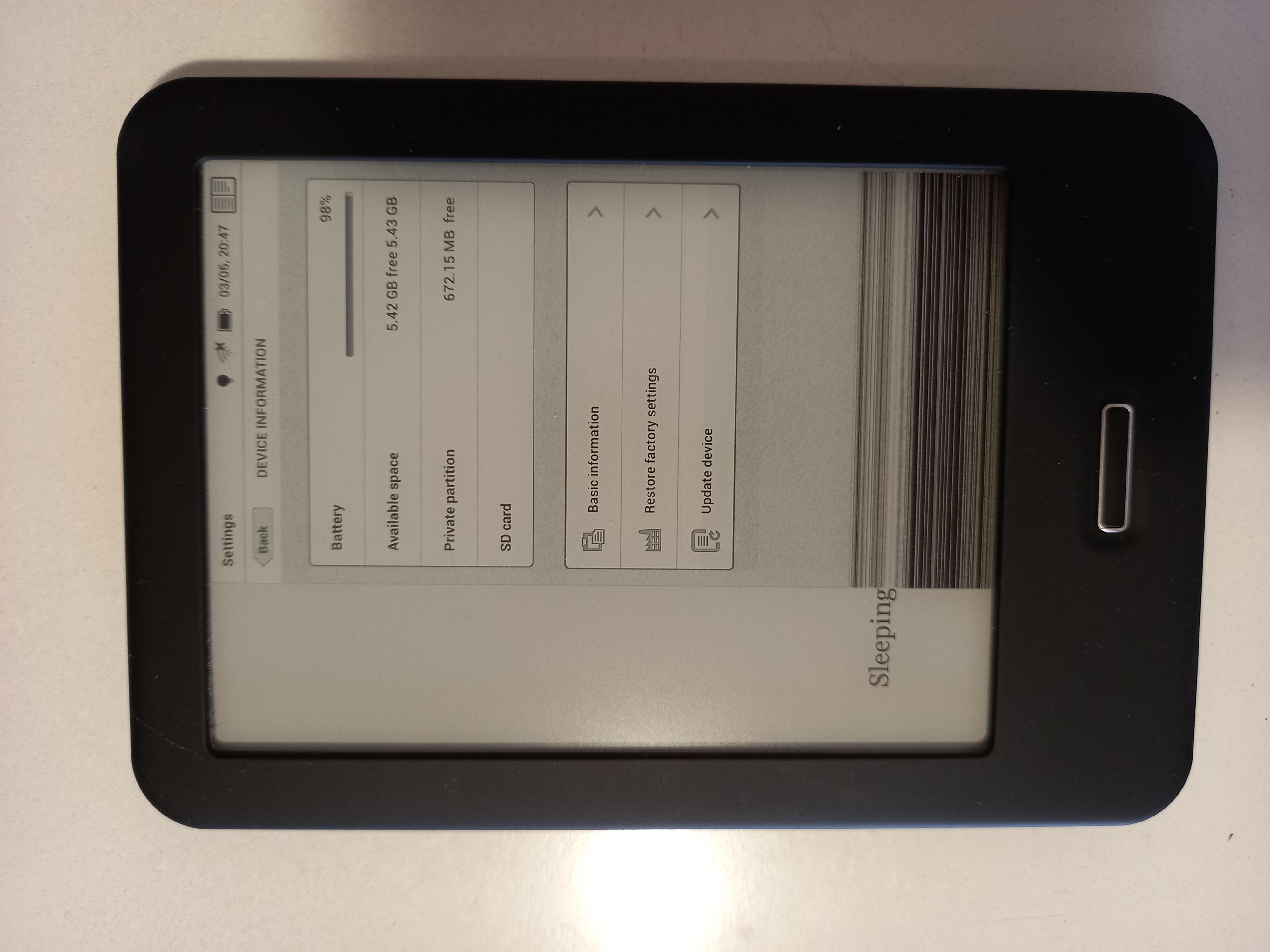

I've only been able to install ADB on the PC.
I don't see a "build number" on the e-reader.
Can you see it in the attached photos?

Try tapping on the "Software"
I presume that your touch is scaled by 0.7 and you have to tap wide to hit the correct thing?
Try tapping everything on that page.
Old 06-18-2025, 11:03 AM   #30
daniel bastida
daniel bastida began at the beginning.
Posts: 29
Join Date: Jun 2025
Device: BQ Cervantes 3
I have touched (7 touches) on software (the number) and on the other numbers... without result.
I use a 0.7/1.41 template for a rough approximation.
