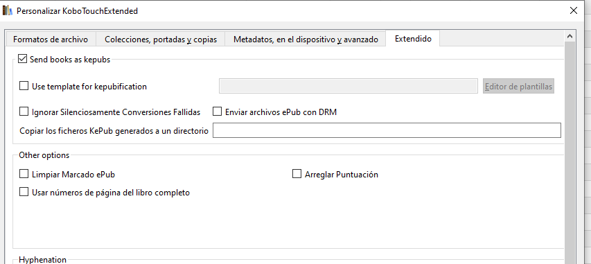

One question, in the pictures ownedcat has uploaded, I'm missing some options in the extended tab (see picture). Are they at another place? I'm not using them but just in case...

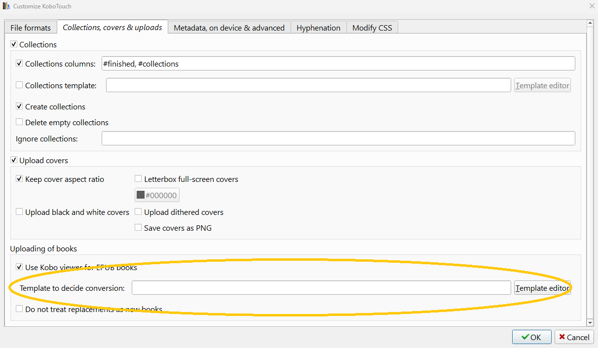

I'm using some of them and I do need them to keep my work flow the same as it is now. This will not do until these options are restored. I do need the option Use template for kepubification. Without it I cannot use Reading List properly all the time. This option can go in the Uploading of books section. That would be the appropriate place for it.
What's your workflow? I trying to figure out why the template is needed for reading list.
I use Reading List to add the books I want to add to my Kobo next time I connect it to my library. Most are ePub. Occasionally I will send a KePub. With the custom column, I just mark it as Y and then Reading List runs, it sends the books to my Kobo. The ones I want as KePub get sent as KePub and the ones I want as ePub get sent as ePub. The template decides which books areePub and which are KePub.
As it stands now, I would have to send all ePub with Reading List and manually send the KePub. That means I have to remember what it is I want to send as KePub. I'm not always so good with that. As it stands now, I don't have to remember what I want to add to my Kobo. And I can easily look to see what it is I am going to be adding.

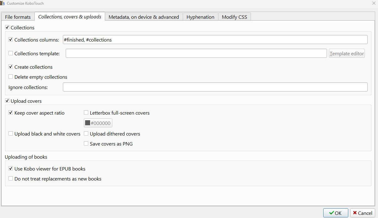

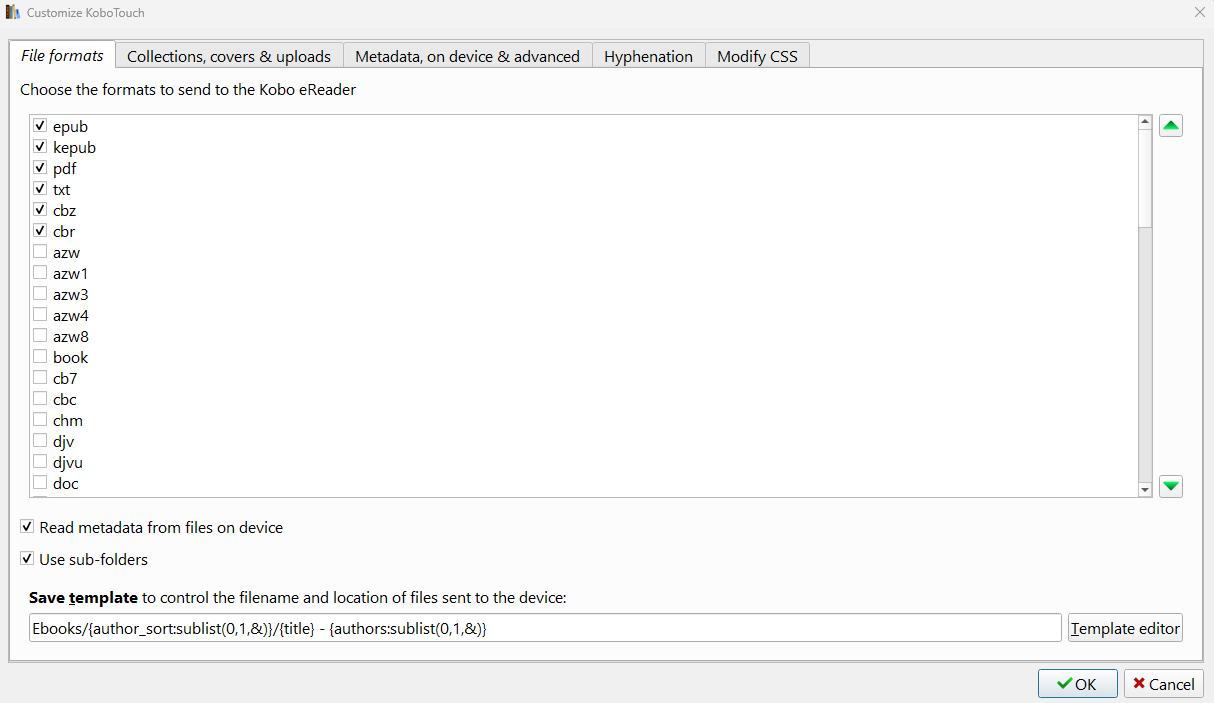

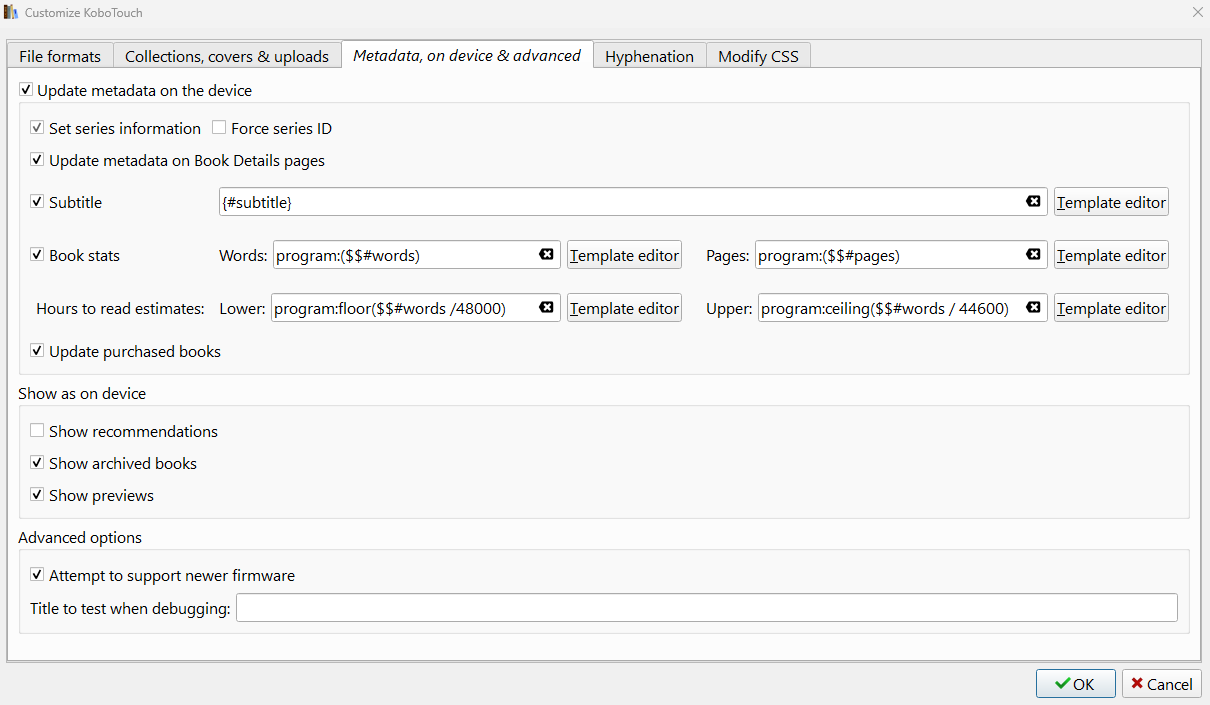

When I looked at the Kobo Touch Driver settings which I probably should have done when I updated , all my setting from my old setup carried over. The hyphenation and CSS are empty since they are new to the KoboTouch driver and checking my old KoboTouchExtended setup, they were blank there.
Hyphenation does not matter to me since I read ragged right (left justified) and since I edit my ebooks, any CSS modifications are done at that time.
Name:	Screenshot 2025-02-27 151338.png
ID:	213932   Click image for larger version
Name:	Screenshot 2025-02-27 151357.png
ID:	213933   Click image for larger version
Name:	Screenshot 2025-02-27 151416.png

Thank you very much! I really appreciate this.
https://github.com/kovidgoyal/calibr...36d7bfc02dc2fe

This match what you were wanting, Jon?
Name:	Screenshot 2025-02-27 204633.png
