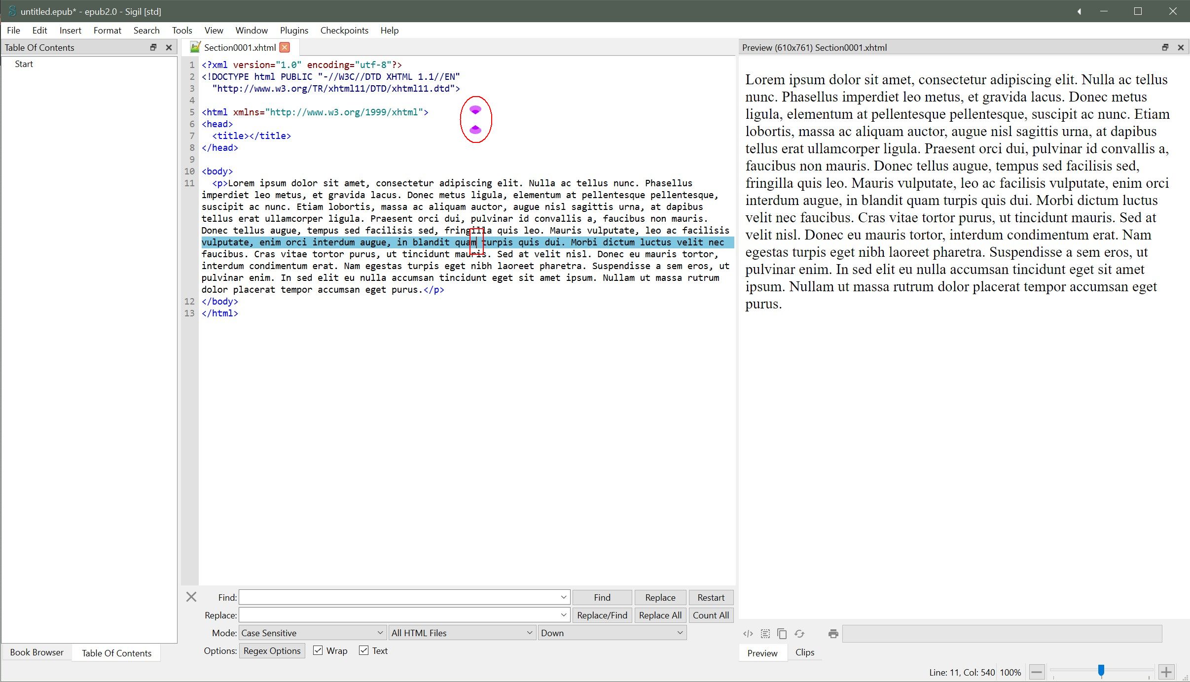

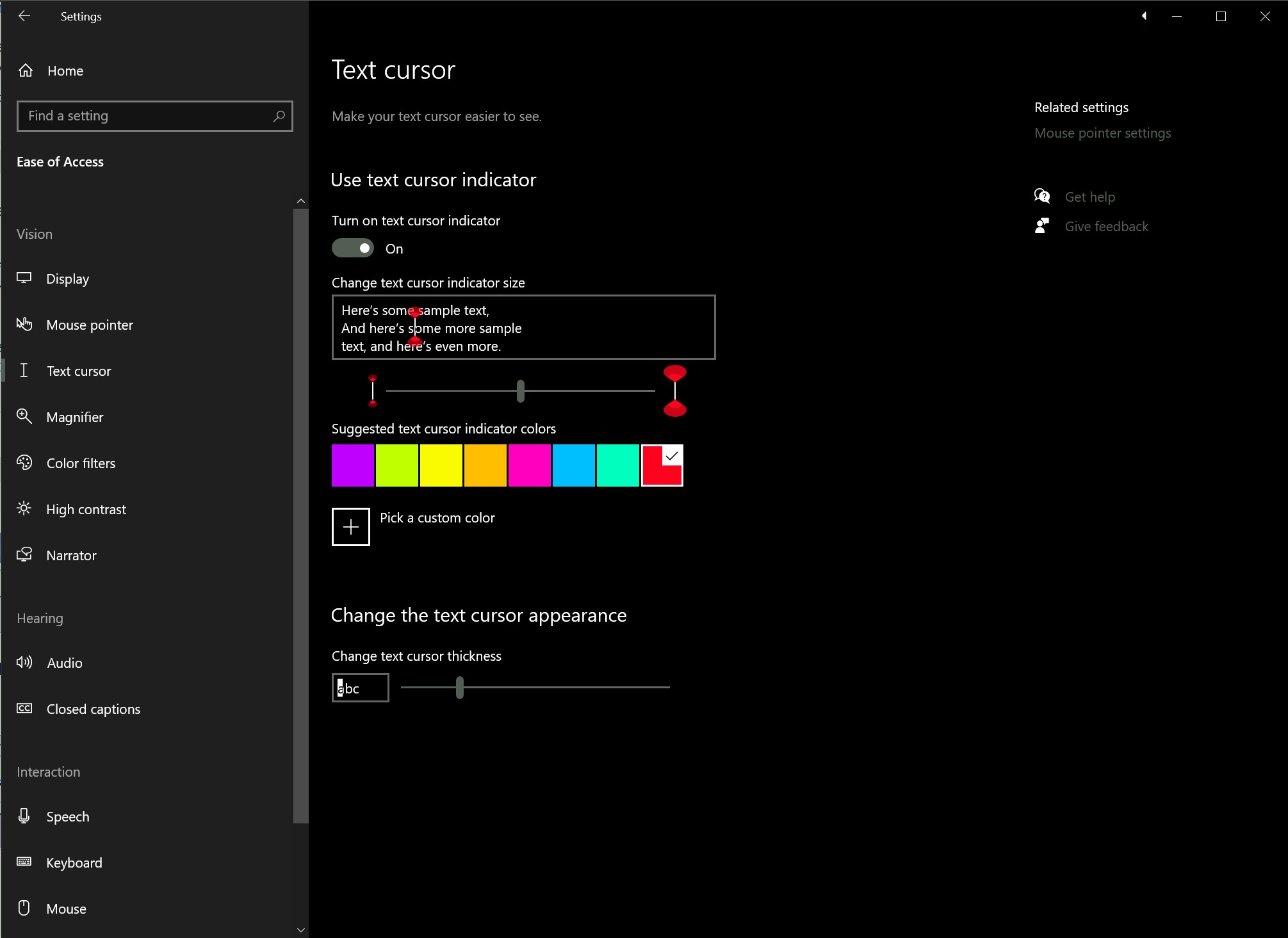

@KevinH - I had an interrupt, and hadn't posted this.
FTR: On Windows 10, BeckyEbook's border tweak doesn't appear in CodeView or Preview windows, in both Dark and Light modes, it appears everywhere else… I think.
My "IMO it should be a built-in preference in all Qt apps…" was meant to be read as "In an ideal world it should be a built-in preference in all Qt apps…".
So, I suggest - do nothing.
FWIW: I don't have a problem with using EnvVars
I stumbled into a Windows Ease of Access setting that I didn't know about - Text cursor indicator. It's useful sometimes.
It isn't being handled as it should be in Codeview. Because I can see the same behaviour in the calibre editor codeview window, there's no doubt it's a Qt issue. I've attached some relevant screen shots.
There's no problem with single line text boxes, but things go awry in multiline text boxes line. The indicators appear, but they're detached from the cursor, I'd rather they didn't appear at all… as is the case in Notepad++.
Kevin, Perhaps you could nudge Qt, maybe it's already been reported. I have reasonably convenient way to turn the indicators off/on.

@BetterRed
I just pushed a fix for Preview to show the red outline but it requires a clean new checkout and build of Sigil, setting that environment variable and removing BeckyEbooks code from your qt_styles.qss file.
FYI, CodeView has no border to highlight as that caused issues with Dark mode on Windows. Luckily CodeView always shows the current line highlighted when it has focus. So it is easy to see focus. And you control the CodeView highlight colour palette in Sigil Preferences.
As for your Windows only Ease of Access issue, I have no idea about it, and as I do not even own a Windows box, I can not recreate it.
So I can not create a simple example standalone bug reproducer program required for bug reports.
And I have no way to test it. So I won't be the one to file a bug report with Qt. Perhaps you can convince Kovid to.

I assumed this Text cursor indicator feature was fairly new, it's been in Windows for almost 4 years (earlier in preview releases) - why wasn't I told
@BetterRed
I googled Qt and "Windows Ease of Access" and they said to double check that the font size set by Windows Ease of Access" exactly matches the font size used in the text editor (ie. CodeView font size that you control in Sigil Preferences). Otherwise the cursor location becomes out of sync in multiple lines situations.
I have no idea what "…the font size set by Windows Ease of Access (EoA) exactly matches the font size used in the text editor" might mean, the Font size adjustment in EoA is for the Windows interface - it has no effect on applications like Sigil… nor should it!
There are also ways to set a cursor shape for most Qt apps. Perhaps styling a larger cursor in qss might help.
AFAIK Qt has never paid much heed to the Windows Ease of Access features - the setting for text cursor thickness has been there for decades, Qt blithely ignores it. But in that it's not alone, Notepad++, and Firefox are the same for multiline text boxes.
If anyone knows of a qss tweak I can use to 'enhance' the text cursor, maybe they can give me clue - width and color maybe.
