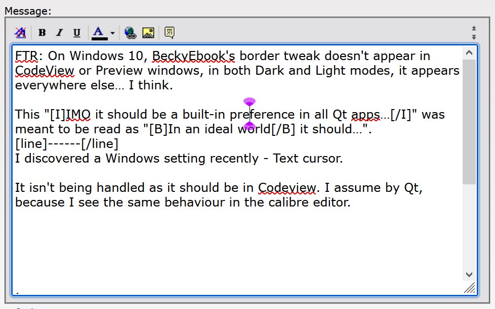

@KevinH - I had an interrupt, and hadn't posted this.
FTR: On Windows 10, BeckyEbook's border tweak doesn't appear in CodeView or Preview windows, in both Dark and Light modes, it appears everywhere else… I think.
My "IMO it should be a built-in preference in all Qt apps…" was meant to be read as "In an ideal world it should be a built-in preference in all Qt apps…".
So, I suggest - do nothing.
FWIW: I don't have a problem with using EnvVars
I stumbled into a Windows Ease of Access setting that I didn't know about - Text cursor indicator. It's useful sometimes.
It isn't being handled as it should be in Codeview. Because I can see the same behaviour in the calibre editor codeview window, there's no doubt it's a Qt issue. I've attached some relevant screen shots.
There's no problem with single line text boxes, but things go awry in multiline text boxes line. The indicators appear, but they're detached from the cursor, I'd rather they didn't appear at all… as is the case in Notepad++.
Kevin, Perhaps you could nudge Qt, maybe it's already been reported. I have reasonably convenient way to turn the indicators off/on.

@BetterRed
I just pushed a fix for Preview to show the red outline but it requires a clean new checkout and build of Sigil, setting that environment variable and removing BeckyEbooks code from your qt_styles.qss file.
FYI, CodeView has no border to highlight as that caused issues with Dark mode on Windows. Luckily CodeView always shows the current line highlighted when it has focus. So it is easy to see focus. And you control the CodeView highlight colour palette in Sigil Preferences.
As for your Windows only Ease of Access issue, I have no idea about it, and as I do not even own a Windows box, I can not recreate it.
So I can not create a simple example standalone bug reproducer program required for bug reports.
And I have no way to test it. So I won't be the one to file a bug report with Qt. Perhaps you can convince Kovid to.

Posts: 22,890
Karma: 34252744
I assumed this Text cursor indicator feature was fairly new, it's been in Windows for almost 4 years (earlier in preview releases) - why wasn't I told
@BetterRed
I googled Qt and "Windows Ease of Access" and they said to double check that the font size set by Windows Ease of Access" exactly matches the font size used in the text editor (ie. CodeView font size that you control in Sigil Preferences). Otherwise the cursor location becomes out of sync in multiple lines situations.
I have no idea what "…the font size set by Windows Ease of Access (EoA) exactly matches the font size used in the text editor" might mean, the Font size adjustment in EoA is for the Windows interface - it has no effect on applications like Sigil… nor should it!
There are also ways to set a cursor shape for most Qt apps. Perhaps styling a larger cursor in qss might help.
AFAIK Qt has never paid much heed to the Windows Ease of Access features - the setting for text cursor thickness has been there for decades, Qt blithely ignores it. But in that it's not alone, Notepad++, and Firefox are the same for multiline text boxes.
If anyone knows of a qss tweak I can use to 'enhance' the text cursor, maybe they can give me clue - width and color maybe.

@BetterRed
I have looked into somehow highlighting the blinking text insertion point (caret) in a cross platform manner.
It does not appear doable without just growing the font size. Recent versions of qt can use qss caret-color property to set it to some other color but I can't see a way to change its height or thickness as those are tied to the font being used. A very thin blinking red line can be as hard to see as a very thin blinking black line.
It might be possible with setting QStyle controls but I could not find it in the Qt docs.
That just leaves system level Accessibility controls. On Windows it is "Ease Of Access" but as you pointed out that is broken. On macOS, you can change cursor size but not caret size as it is tied to the font size. There is a tool on macOS to show a zoomed in hover of the text near the caret but it is awkward to use.
So unless there is some qt codebase that draws insertion point caret's someplace, I do not think that is possible.
That leaves either zooming the screen (using lower dpi settings on display) or setting a larger font size.
So no luck with any of that.

Kept looking and there is a setCursorWidth() routine in QPlainTextEdit which is what CodeView is made from.
If we can change both the caret-color and double the width, that should help. I will give that a try tomorrow.
Well that was a dead end. Under macOS using setCursorWidth in CodeView had absolutely no impact on either the blinking insertion point or the cursor itself.
So it appears the blinking insertion point is not controllable at all under Qt6 using setCursorWidth no matter what the docs say.
