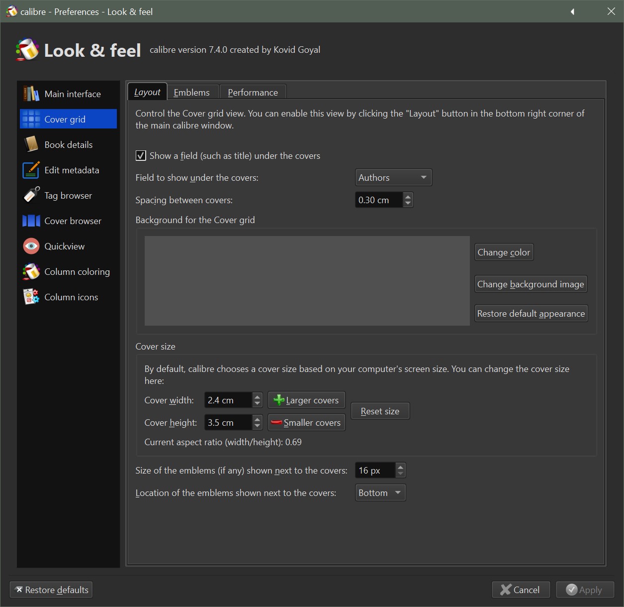

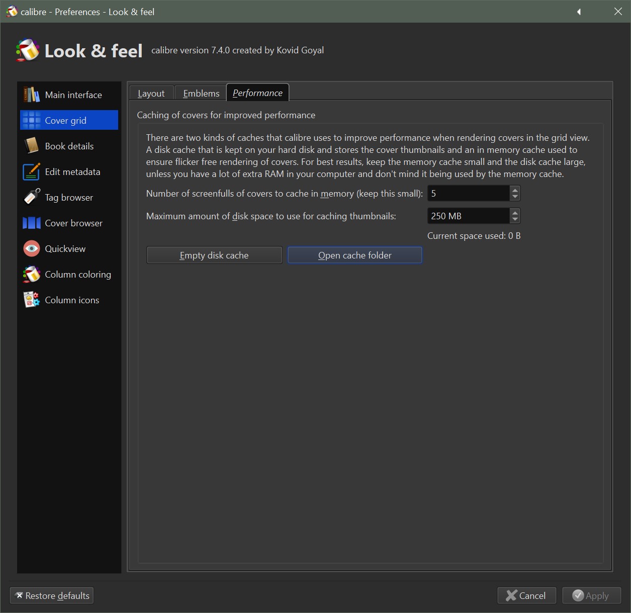

Hmmm - if I delete %appdata%\calibre\Cache\gui-thumbnail-cache before starting calibre the problem does not manifest at startup, but it comes back again on a library switch - by which time the gui-thumbnail-cache has been created and had a some data added.
I've attached screen shots of my L&F-Cover grid settings, the Emblems tab is empty.
Name:	Screenshot 2024-01-23 163129.jpg
ID:	205985   Click image for larger version
Name:	Screenshot 2024-01-23 163427.jpg

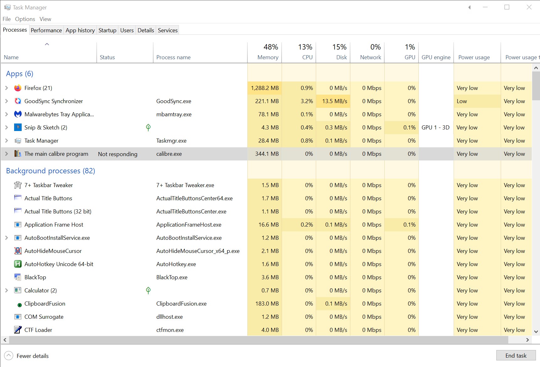

Also when it hangs what does task manager say?
"calibre.exe is not responding"

@BR: I meant is the CPU usage high? That is, is calibre.exe in some kind of loop or just stuck.
Old 01-23-2024, 02:36 AM   #25
Posts: 22,693
Karma: 33011292
It's stuck, wedged in my vernacular
