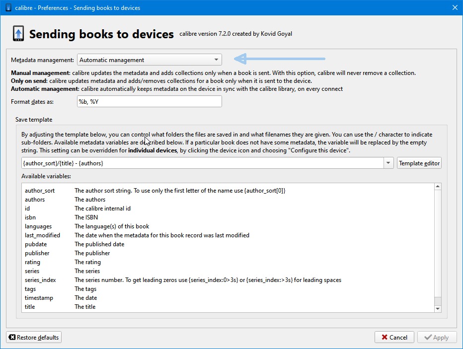

It sounds like calibre isn't updating the authors, perhaps because you haven't enabled sending metadata in the Kobo driver either/or set "Metadata Management" to automatic. This would force the L2 to read metadata from the OPF and authors wouldn't be fixed on the next connect. Also, if calibre is sending metadata and your authors are LN, FN then without the plugboard the authors on the L2 would be wrong, at least sorting incorrectly.
ID:	205567   Click image for larger version

Calibre is updating authors when I run polish, but in this particular problem case Calibre didn't remove an author that wasn't even exposed in Calibre. The L2 then used this author.
Metadata management is set to automatic.
I don't have the plugboard so for most books my L2 only shows the first author shown in Calibre, and I'm fine with that.

Under 'Sending books to devices', metadata management is set to Automatic.
It is in the driver preferences. If you have Kobo Utilities installed, go to its menu, select "Driver", then "Configure current driver". The setting is on the third tab, "Metadata, on device & advanced".
If you don't have KU installed or if you prefer, go to calibre Preferences / Plugins and search for kobotouch.
Note that if it isn't set, then setting it might really mess up your authors on the L2 unless you set the plugboard. If it is set then I am confused.
