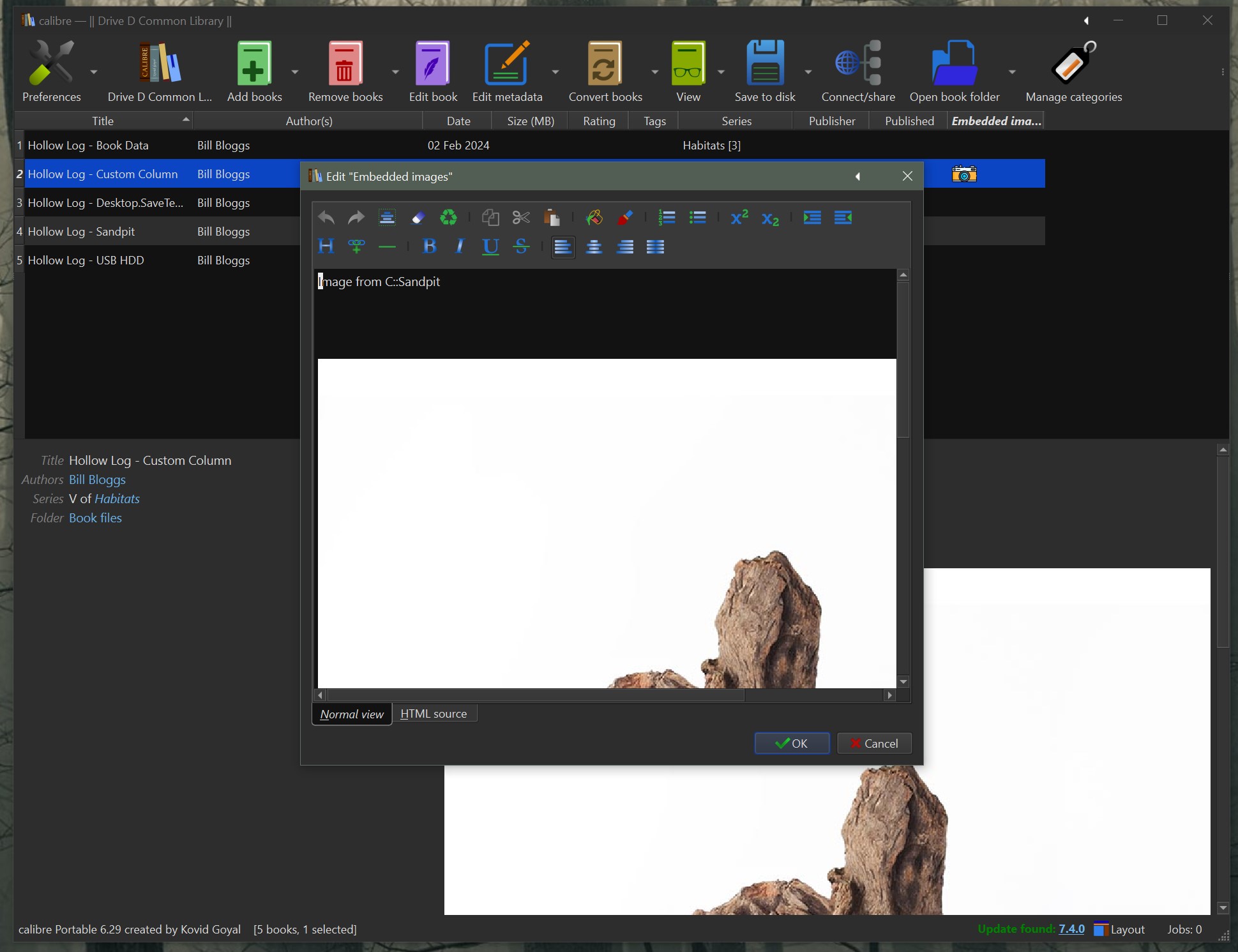

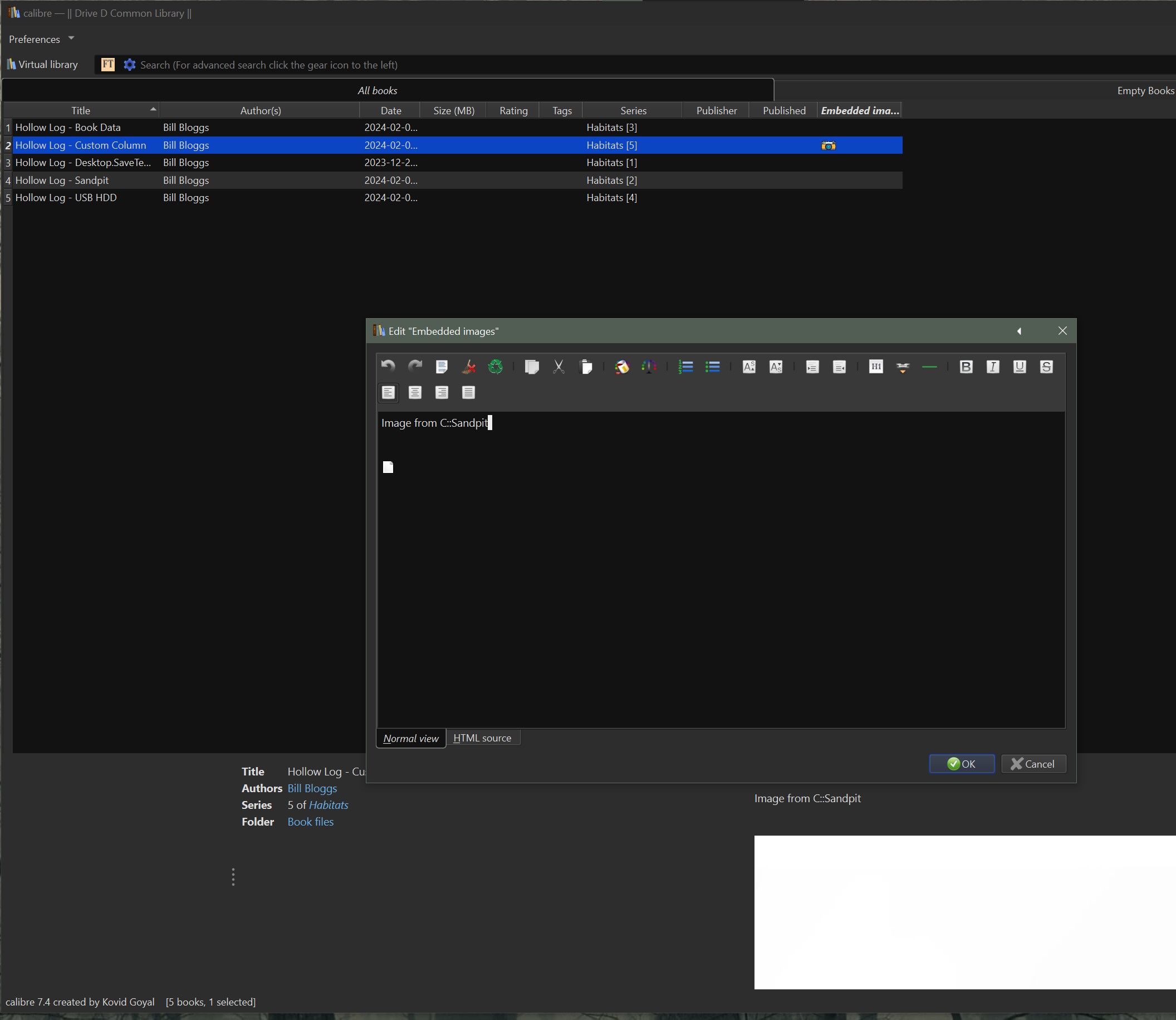

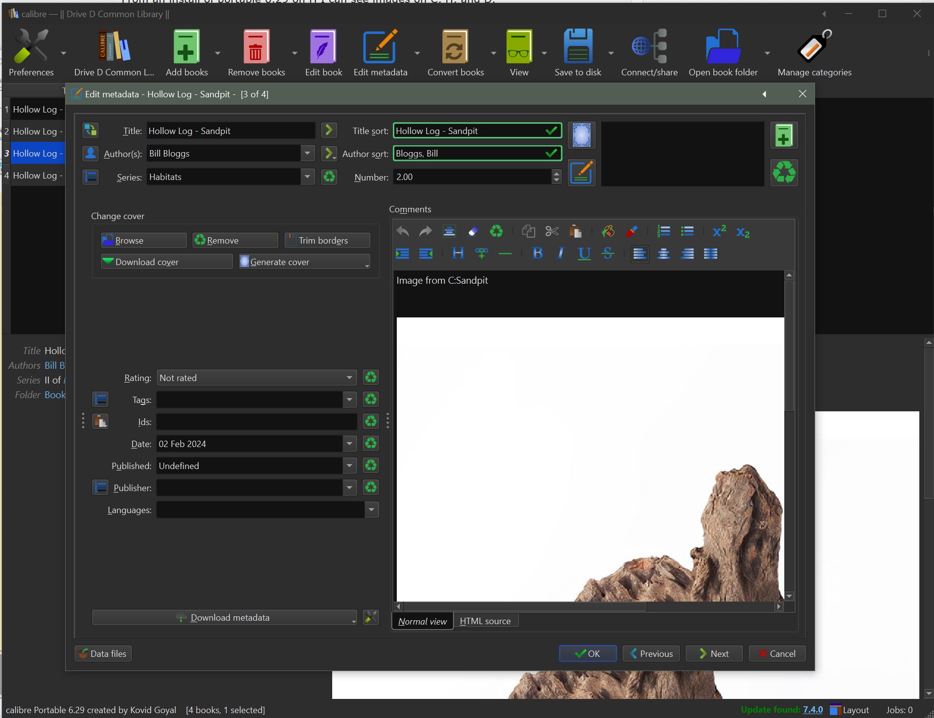

@Kovid - Just noticed a major difference between 6.29 and 7.4, which I'm assuming is related to the original issue:
In 6.29 I can always see the image that is embedded into Comments in Metadata Edit in the Normal view, viz
In 7.4 I can never see the image that is embedded into Comments in Metadata Edit in the Normal view, including books where I can see the image in Book details.
I'll have a look at what happens in a custom long text column.
Added: Similar:
In 6.29 I get the image in Normal view when I edit the cell:
Name:	6.29 custom column .jpg
In 7.4 I get a small white square in Normal view when I edit the cell:
Name:	7.4 custom column .jpg

I can reproduce the issue with the comments editor that will be fixed. Not seeing the issue with book details however.
