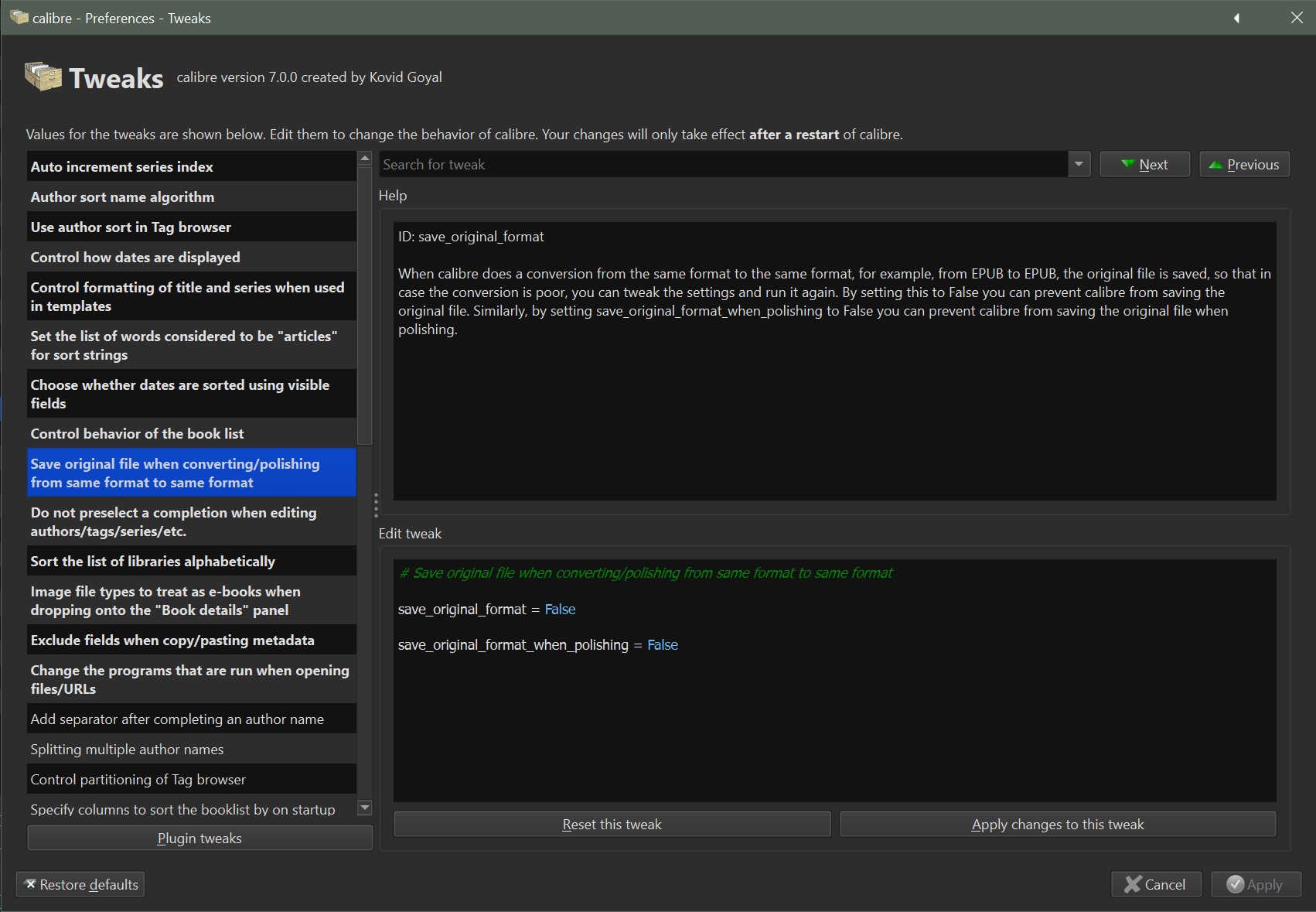

My perception of ORIGINAL_XXXX is consistent with the description of this tweak:
Name:	Screenshot 2023-11-20 201032.jpg

That makes sense. It does seem useful when I want to test out various different conversion options, as the EPUB file is overwritten each time. Maybe the problem is that it is unclear from anywhere but tweaks that original_EPUB will be used as the conversion source.
I think my specific issue was that original_EPUB is also used when going from one source to a different source too, which is not described in the Tweaks description. When going from EPUB to PDF, if original_EPUB is present then it will be used.
