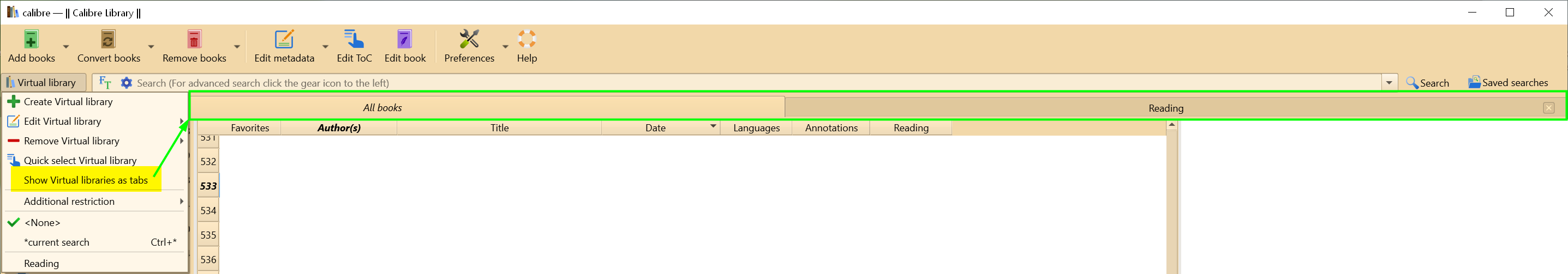

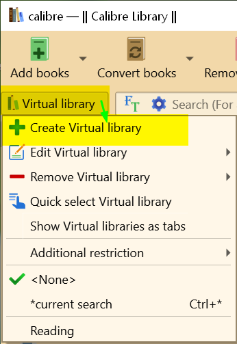

I just add a "Currently Reading" tag to any books I am currently reading and then have a virtual library set to the tag. Then I have set my virtual libraries as tabs so all I have to do is hit the "Currently Reading" tab.
https://manual.calibre-ebook.com/virtual_libraries.html

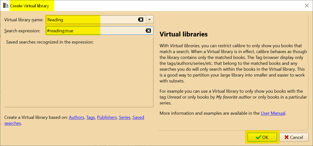

That sounds like a nice idea. I've managed to create a virtual library, but cannot figure out how to add only titles that have Reading column value set to Yes. Is that even possible, pls?

What is the lookup name of your Reading column?
P
Here is my reverse of your goal (Have Read) to give you the Idea
#finished:true and formats:True
The reason for Formats is I also use Calibre to document my dead tree Library
That is the saved search. The VL is based upon that saved search.
How can you have made a VL without a (search) criteria?
AFAIK there is no (reasonable) limits on how many VL you can have on a Library.
THANK YOU! That did the trick, phew...
I have created the VL with a bad search :-( I used just "#reading", but you showed me I should have used "#reading:true" which finally did the trick. (reading being the lookup for the column)
I really like this VL as tabs idea. I may use it for my 2read or favorites as well. It's very fast to navigate. Definitely will explore more.
Best regards
P

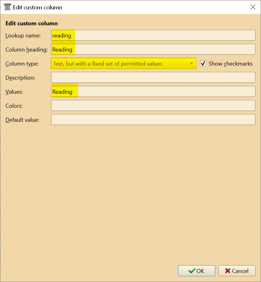

thanks for replying
as you've seen in the message above, finally solved :-)

visual summary
I thought I might share my screenshot notes depicting the solution I've used based on all the advice here. Perhaps they may help someone who searches into this thread. For more info, just read this thread-it's all here.
P
