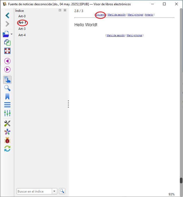

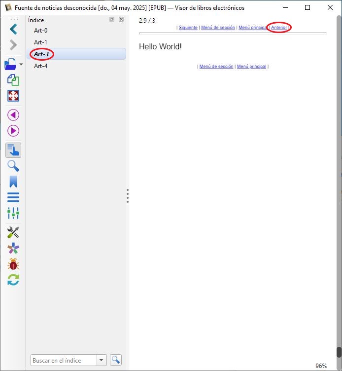

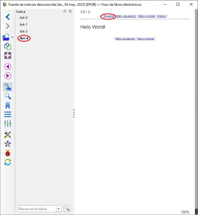

You may not be clicking on the correct article.
This epub file fails on Art-1 -> Next and Art-3 -> Previous (and Art-4 -> Next).
This should be problematic regardless of the operating system (Windows, Linux, Android) or viewer/reader.
However, the behavior depends on the viewer/reader. In the case of the Calibre viewer, you will see the missing file screen.
ID:	215472   Click image for larger version
ID:	215473   Click image for larger version
ID:	215474   Click image for larger version

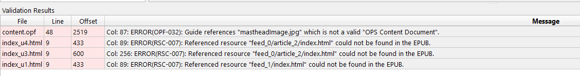

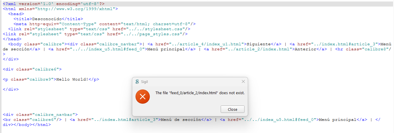

Sorry but I was testing the ePub you attached in message #8 in this thread. It does not fail using Thorium under Windows but did have issues using calibre's viewer. This issue was corrected by Kovid Goyal in the patch mentioned in his message #16 and no longer fails under calibre's viewer. I disregarded any references to attempts to link to files not in the ePub.
I looked at your missing articles from the .zip file linked in message #17 in this thread and the issue there is very simply that there are links to non-existent files. I opened the epub in Sigil and yes, I got errors. Perhaps that your reference to "<a href="../article_2/index.html" doesn't work since there article_2/index.html is not be be found in the ePub since only article_0, article_1, article_3 and article_4 exist in the epub. The same for <a href="../../feed_1/index.html"> since feed_1/index.html does not exist. Complaining that links to non-existent locations does not work is not going gain you much sympathy.
While I had the file open in Sigil, I ran epubcheck on it and that showed 4 errors and I have attached the image of the error messages and the files as shown in Sigil's file browser.
In future, I would suggest checking your ePub using epubcheck in calibre's editor before complaining about issues.

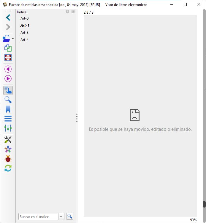

The patch in message #21 now has calibre's viewer popping up an error message about the file not being found.
The problem with #4 is that you are asking for calibre's ebook-viewer to decide what to display when a link to a non-existent file is followed.
This type of situation is one the main reasons that I do not send epubs to my ereaders until I have checked and corrected any errors. Garbage In, Garbage Out. I tend to be a bit OCD with how I want epubs to look so I am happy to spend the time to correct issues.
OTOH, those links used in your ePub look like a web page from decades back and is not something that I've seen in quite a while on a web page never mind an ePub ebook. A ToC would be a better solution.
