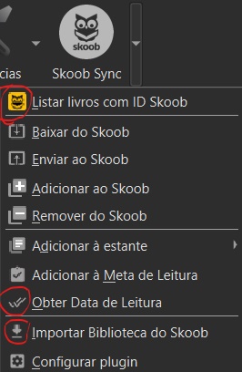

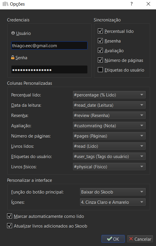

I've just noticed that my plugin icons are being drawed with a lower quality then before. Also noticed a shadow on some checkboxes (why not all? ).
5.34 / 5.99(Beta)
Name:	5.34 - Menu.png
ID:	191233Click image for larger version
Name:	5.99 - Menu.jpg
Name:	5.34 - Config Window.png
ID:	191235Click image for larger version
Name:	5.99 - Config Window.jpg
There are also some separators missing on the beta, although using the same code (m.addSeparator()) for all of them.

This will fix the drop/hover event errors: https://github.com/kovidgoyal/calibr...c60100810b09e5
@thiago.eec: No clue about your icons, most likely a DPI thing. Try using larger icons.
Strange, since it renders ok on calibre 5.34 and older versions.

thiago.eec
Posts: 1,385
Karma: 1589505
Join Date: Dec 2016
Location: Goiânia - Brazil
Found the solution on their porting guide.
Qt 6 changes the default scale factor rounding policy from Qt::HighDpiScaleFactorRoundingPolicy::Round to Qt::HighDpiScaleFactorRoundingPolicy::PassThrough in order to track operating system DPI settings accurately. Applications that use Qt Widgets may encounter graphical glitches at non-integer scale factors, for example on Windows with a display configured for 175%. In that case, set the rounding policy to Round to restore Qt 5 behavior.
Since I use a non-integer scale factor on my windows machine, this was causing the problem. So, to correct it, i restored Qt 5 behavior setting the policy to Round:
QApplication.setHighDpiScaleFactorRoundingPolicy(QtCore.Qt.HighDpiScaleFactorRoundingPolicy.Round)
thiago.eec is offline   Reply With Quote

Old 01-01-2022, 10:55 PM   #26
Posts: 46,595
Karma: 29634066

That doesnt explain why it affects only plugin icons though. Is it because they are too small?
I'm guessing* this is it.
Anyway, my fix backfired, since it sets the Policy for QApplication, messing with whole calibre. I guess I'll have to change all my icons for larger versions.
P.S.: The shadow on checkboxes borders happens on main calibre either.
* Confirmed. Using larger images fixes the problem.
