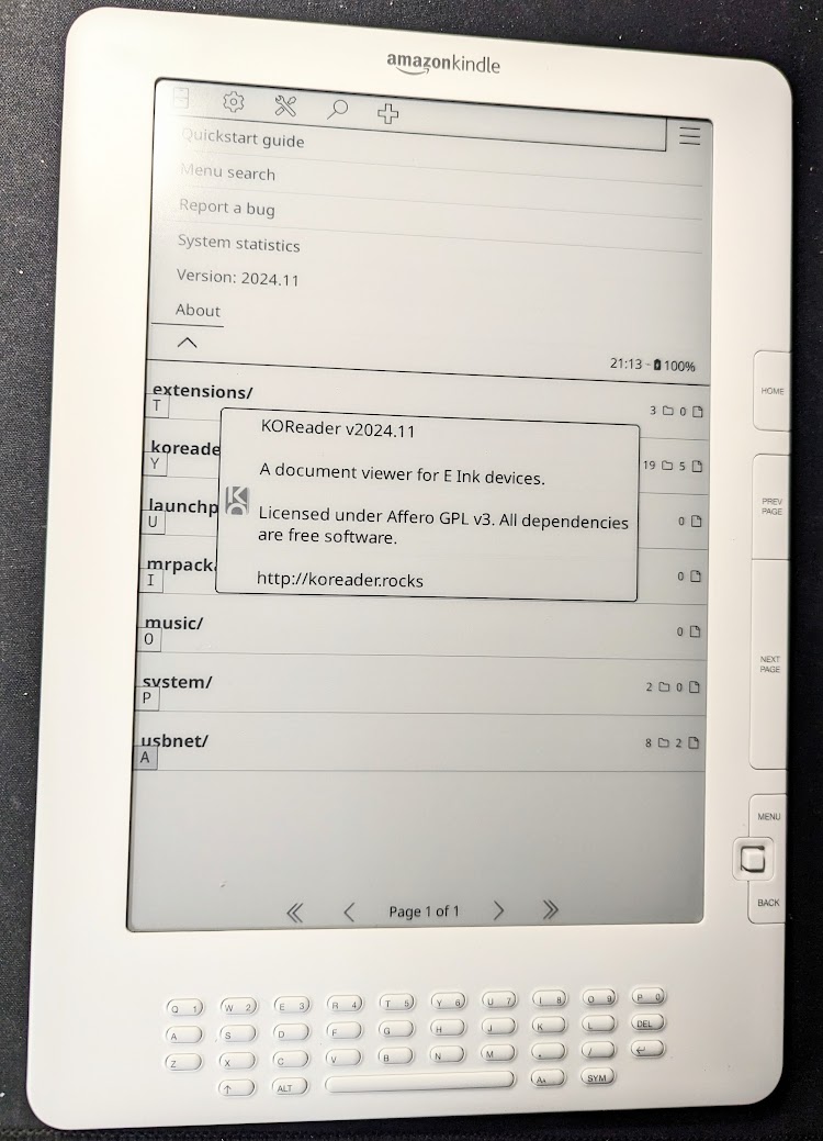

here is the bed boy running latest KoReader 2024.11
