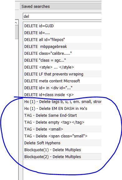

Originally Posted by phossler View Post
The Saved Searches list box is really one dimensional. I wish that there was a way to make it into an expandable 'tree' to improve the organization structure.
There is a very handy way to find what you need in the saved searches window.
You can call saved searches according to their names. Say, you just type "w" in the top "filter" field, and you just see all your saved searches which have a "w" in their name. So, it's up to you to just name your saved searches in a custom way.
Old 11-24-2020, 09:52 PM   #22
phossler
Posts: 1,098
Karma: 447222
Device: Kindle Paperwhite
I haven't been taking full advantage of the filter
I have been using my own convention to give the first word a 'key' and grouping the saved searches that I typically run together next to each other, like DELETE, TAG, and Hx
One thing -- I'd prefer that filter started matching just from the left, and not anywhere in the string (personal opinion)
