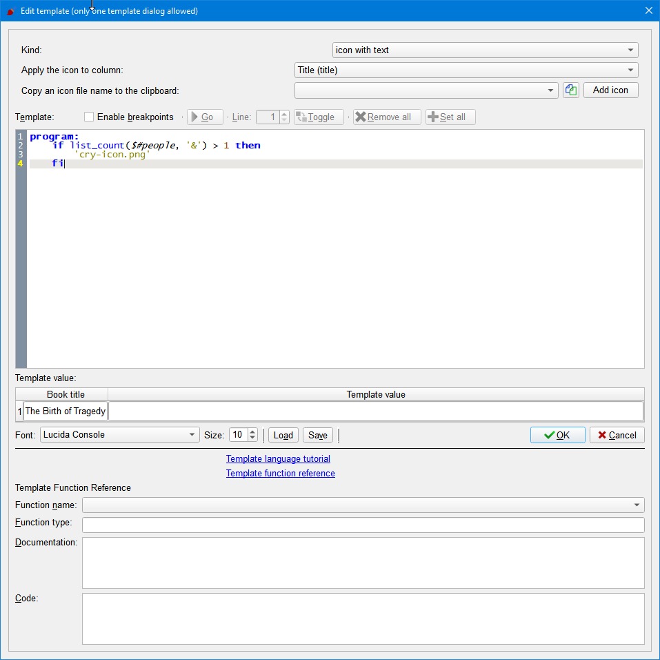

Use an advanced rule, changed to use the icon you like, the right column (#series_authors), and the column where you want to put the icon.
The template is:
program:
	if list_count($#people, '&') > 1 then
		'cry-icon.png'
	fi
The dialog is:

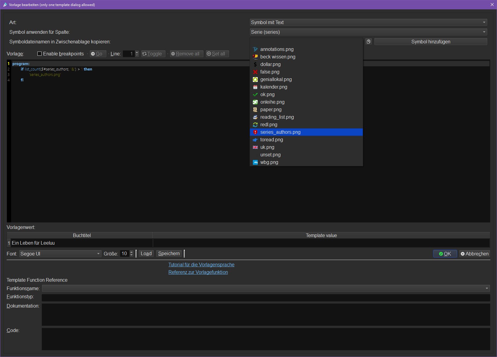

The icon works, because I was able to show it on my #symbols column for all series
The book shown in the setting is part of a multi-author series.

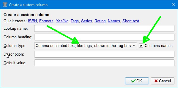

What kind of column is #series_authors? In particular, is it like this, including "contains names" being checked?
If "Contains names" is not checked then the template must use ',' as a separator instead of '&'

',' for the world!
btw., it's a column from your post here https://www.mobileread.com/forums/sh...3&postcount=95
