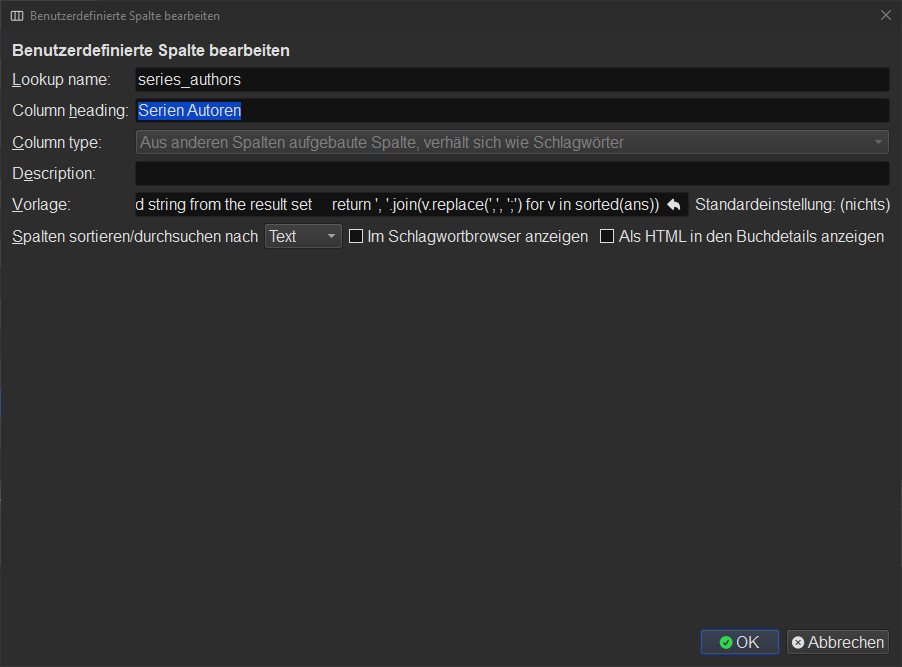

What kind of column is #series_authors? In particular, is it like this, including "contains names" being checked?
If "Contains names" is not checked then the template must use ',' as a separator instead of '&'

',' for the world!
btw., it's a column from your post here https://www.mobileread.com/forums/sh...3&postcount=95
