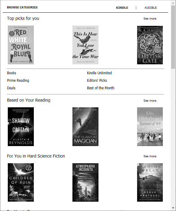

I expect the "experimental browser" is pretty much what's used by the on-device Kindle Store as well. It's very basic but it's not gonna screw up a simple HTTP GET without a reason (typically wifi-related).
Indeed, there's a directory on the Kindle that contains a cached version of the store's front page at /.active_content_sandbox/store/resource. Loading that into Chrome shows the main page of the store. I assume the rest of the store is also displayed via the browser.
