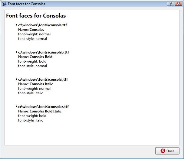

And how is calibre supposed to give you more information about a font that has not been embedded, since the only information it has is the information already visible to you in the CSS rules?
In the editor, when you double-click on a font in the "Manage Fonts" dialog, you get something like the first attachment, which shows four font files and information about the fonts in those files. This information has been retrieved from the font files, not my CSS, which has only:
.text-monospace {
	font-family: "Consolas", "Courier New", "Courier Std", "Courier", "DejaVu Sans Mono", monospace;
	font-size: 0.80em;
On the other hand, if you go to Preferences->Conversion->Common Options->Choose Font Family, clicking on a font there gives you more information about it. Not for Consolas, which is a relatively simple font, but something that has a font-stretch that isn't "normal", is one thing extra that does show up.
So, what I was asking was for you to show that same info in the dialog that pops up from the editor.
As for the rest, stop caring about what is in the CSS and just let us embed a font by choosing a file. Put the font file in the right place in the ebook, add a perfectly-matching @font-face rule for that font file, and then let us worry about writing selectors that match the @font-face rule. That would end the issue about trying to "match" the CSS selector to the font files on disk, which is what causes all the questions here in the first place. It would also allow people to embed fonts that they know they need, but may not have a specific selector that matches yet.
For example, I might want to make sure I embed all 4 versions of a font, even though there isn't an exact match in the ebook CSS selectors for the "Bold Italic" version, because there might be a user stylesheet or renderer stylesheet that makes something render that way (e.g., by adding bold when a word is selected for defining).
Even without that, we also need to be able to just embed less than "All fonts". For example, my selector above is a somewhat generic one for monospace, and covers pretty much all the fonts in the order I would like that selector to display. Because of that, I don't want to embed any of those fonts in the book, but in order to get the really special font embedded, I have to put all those in the book, too, then remove them.
There is no such thing as font-weight: medium
Doh! I was looking at "font-weight" and clicked "font-size" at that same reference.

@Divingduck: As I suspected, that is not a regular font file. It's the light variant of calibri, the required css rule for embedding it is:
font-family: Calibri
font-weight: 300
change the css in your document to that and it will be embedded.
There is no way for calibre to get that information from the docx since as you can see from fontTable.xml the family name is given as "Calibri Light" and there is no information on the weight. As I said to hidden.platypus, the only way for calibre to get that information is to scan for the fonts on the system while running the docx input plugin, and I dont want to do that as it fragile, slow and gives different results depending on what system it is run on.
What I can do, is implement a basic fallback mechanism for when a font is not found, so that the matcher tries to find the "closest" available font, which will hopefully be the right one most of the time. However, this is a lot of work to implement.

@nabsltd: Umm if you just want to directly embed a font file, simply use the File->New file->Import font
The purpose of the *Embed fonts tool* is to try to *automate* embedding of existing referenced fonts.
And once again, information for a font can only be shown if calibre knows what font file is involved, which it does not if it could not find a matching font file in the first place. In the case of Choose Font Family you are choosing a font family from all existing files on the system, so calibre has all the information from the font files. In the case of Embed referenced font, calibre has to go from a CSS font spec to a font file. When that process fails, there is no font file to get information from. I dont know how to put it any clearer than that.
That doesn't embed the font...it merely imports the file. How about the CSS @font-face rule that matches it? Calibre should also add that.
Right, but all that has to match is the name. That's good enough to get to the file for most people, but Calibre still won't embed the font unless we make the CSS selector an exact match, which is what the pain is all about.
No font file to get information from? Oh, really? Try the following selector:
.testing {
font-family: "Arial";
font-weight: 200;
It will fail miserably to embed any font. Yet, if you double-click on "Arial" in the "Manage Fonts" dialog, you get a list of every font named "Arial" installed on your system, and some information about each font. Where did Calibre get that information? From the font files, right? And, all it needed to make the match was the font name, which we always have.
All I'm asking for is that dialog show every piece of information required to make the CSS match the font file. Hell, you could show a copyable CSS selector, if you wanted.
nabsltd is offline   Reply With Quote
Add it where? And given the way that @font-face works in CSS, adding ti manually is trivial. By that I mean that regardless of what you put in the rule, as long as you get the file name correct, the rule will work.
No it most definitely is not enough to get a file. Font selection, operates on four keys, name (of which there are actually half a dozen varieties in font files), weight, style and stretch. Read the CSS spec on fonts sometimes.
See my previous post. You really need to read what I actually say instead of jumping up and down and repeating yourself endlessly. Quoting myself, from one day and 14 posts before:
I suppose I could have the embed font button popup a report that shows why fonts with matching family names did not match fully.
