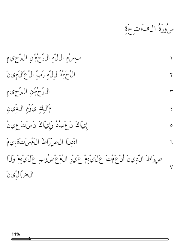

Doitsu,
I replaced the font, used your azw3 file, but got the same result.
In the font-hack folder of the kindle, there is a text file named info.txt, which reads:
$Id: info.txt 8953 2012-11-15 23:23:21Z NiLuJe $
Hello! If you're wondering what all this weird stuff on your Kindle is,
I'm a fonts hack! There's a good chance that I came from here:
https://www.mobileread.com/forums/showthread.php?t=88004
I'm at version 5.6.N, so, if you wish to uninstall me, you'll at least need
the uninstaller from that version.
-- NiLuJe
As I got this k4nt as it is, I have no idea if the font-hack it has is the most up-to-date version or not.
(I used the same mobi and your azw3 file on Kindle app on Android and iOS. Interestingly, the Android app works correctly while the iOS app is not.)

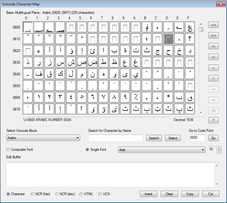

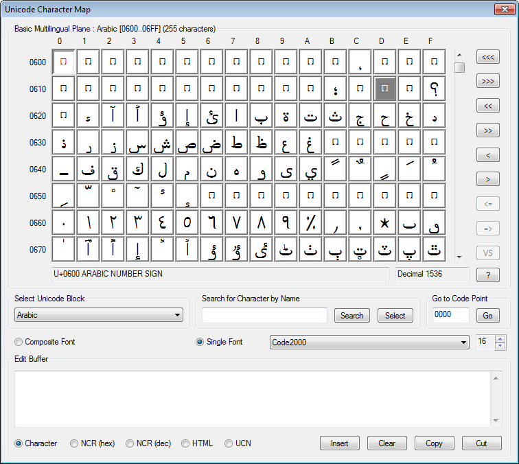

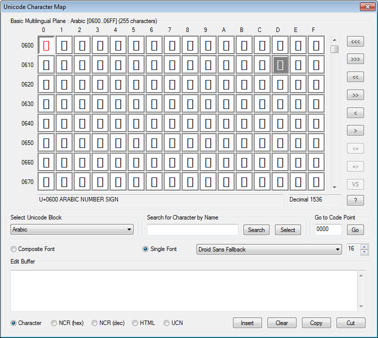

Questions for NiLuJe:
The font hack mainly uses I18N.ttf and code2000.ttf to handle Arabic. But these 2 fonts have valid glyphs for Arabic Unicode range (x0600---x06XX). Now my question is from which other font do the squared fallback glyps come? I checked almost all of the fonts on this font-hack folder and they either have some valid Arabic glyphs there or nothing at all (empty), but not any square-coded fallback glyphs.
ID:	136057   Click image for larger version
ID:	136058   Click image for larger version

Location: Paris, France
First, that font-hack is gloriously outdated, so that probably doesn't help ^^.
And the out-of-unicode-coverage glyphs should definitely come from code2000 (i.e., -> I18N.ttf), IIRC.
Keep in mind that there's an extra configuration step involved for the font-hack to affect KF8 (i.e., .azw3) files (something along the line of Browser/KF8 handling in KUAL). But first, upgrade, I'm not even sure your current version actually handles KF8 at all.
I'm a bit short on time right now, and my K4 is currently the only device *NOT* running the fonts hack, so it may take a while for me to get back to you on this .
The good news is, looking at the code, the KF8 handling definitely puts everything custom ahead of Code2000, so I'm pretty sure you'll get glyphs from custom fonts. The only remaining issue is whether they'll be properly shaped or not for complex layouts...

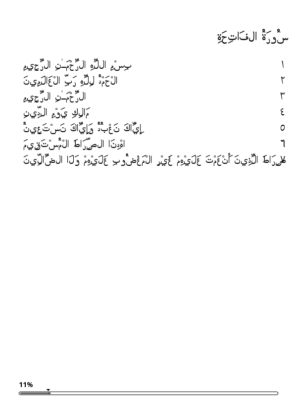

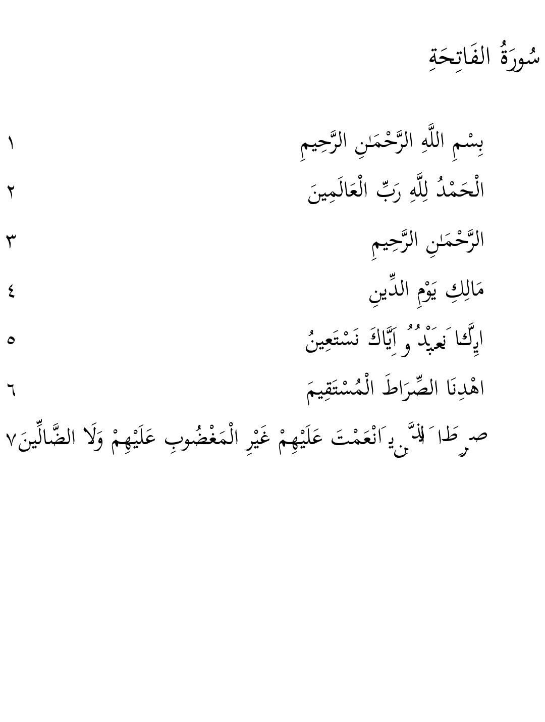

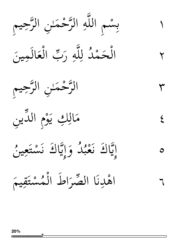

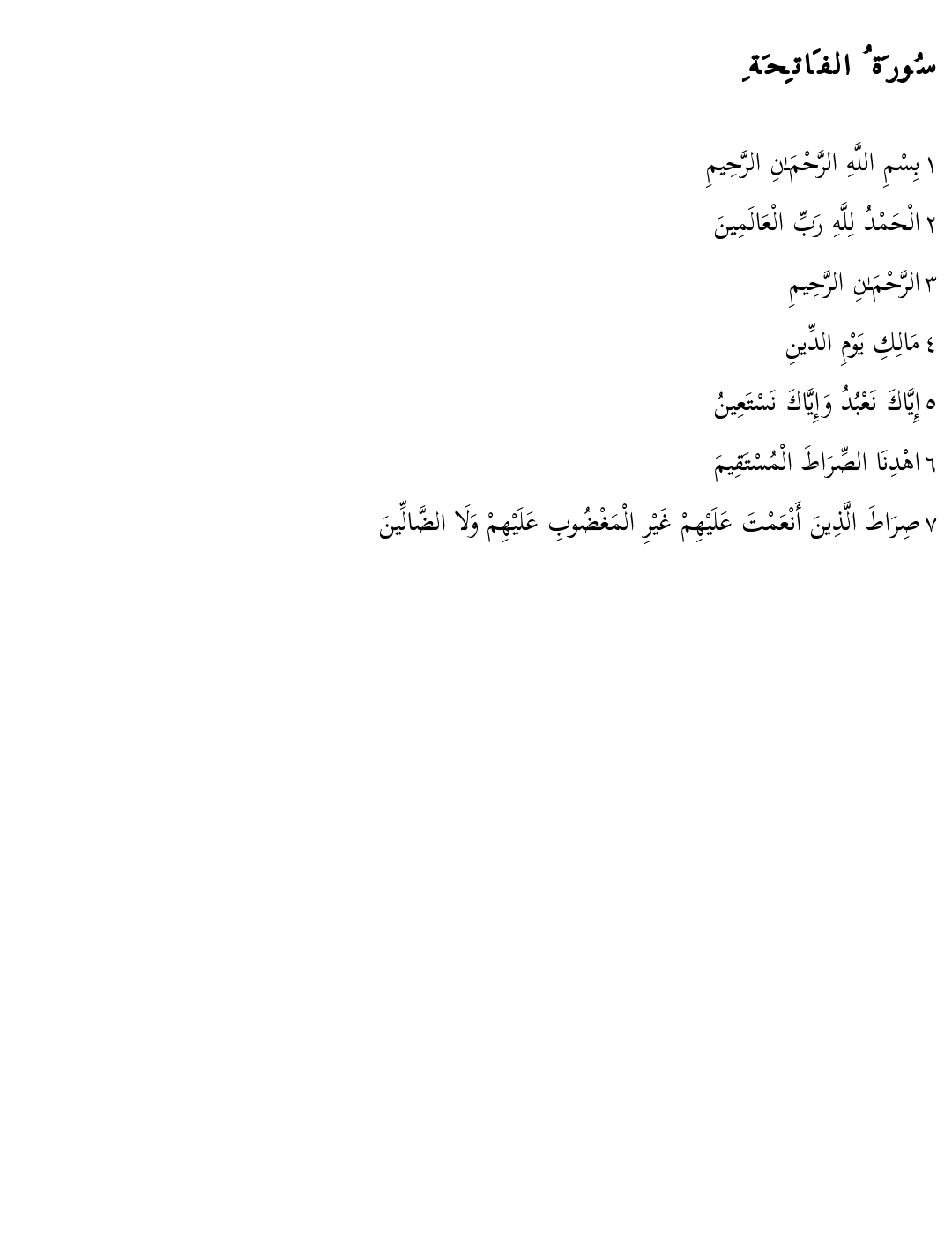

And the answer is, yup, complex shaping is broken, as expected.
And for the record, here's Adobe RMSDK doing it mostly right on a Kobo H2O, and Kobo's ACCESS renderer doing it right (AFAICT) [provided an adequate font is side-loaded and selected, here, SIL Scheherazade].
I'll check if I can mangle FC like on FW 5.x, but the hack is really, really not designed for that so it might be tricky.
EDIT²: Nope, still no complex script shaping, even when very hackishly and quickly trying to replicate what works on FW 5.x. If anyone with more time on their hand wants to mess with FC, be my guest, but that's it for me .
On the plus side, I took the opportunity to check out Bookerly on small Pearl screens, and it looks very neat there ;p.

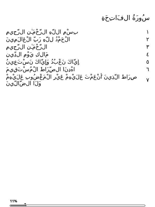

After updating the font-hack and restarting, it seems the problem is solved.
Thank you all for your kind help.
