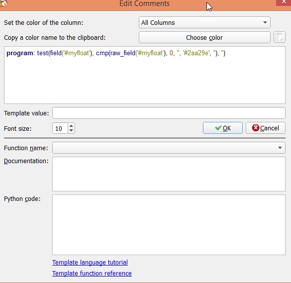

This is what you should see in the advanced rule editor, except for #price instead of #myfloat.

Old 10-25-2014, 02:06 PM   #24
Nyssa
Series Addict
Nyssa's Avatar
Posts: 6,180
Karma: 167189477
Location: Florida, USA
What does it do?
Note that there can be no spaces before the word program.
I made sure there wasn't a space.
Its still not seeing a difference between "0.00" and "undefined".

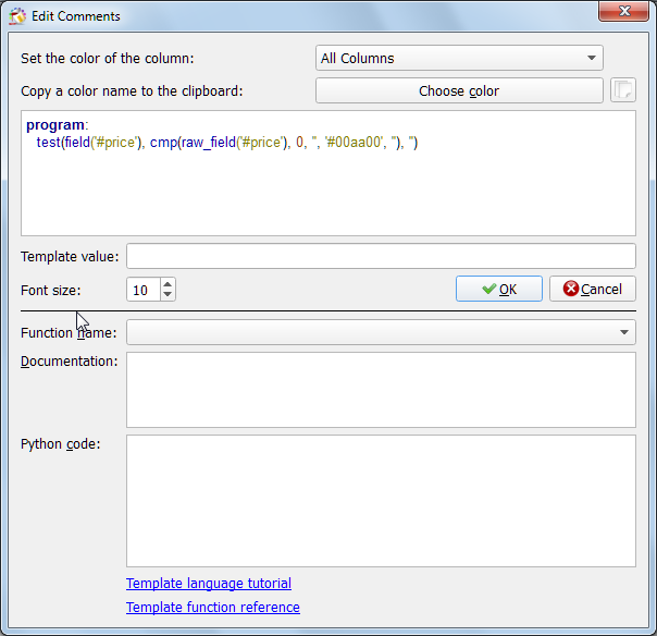

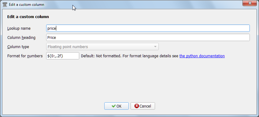

The following 4 attachments show what I have done.
First, I created a column #price so we aren't using different columns.
Next I entered a rule:

As you can see, the line with price 0.00 is green and the lines with no price are not.
Idea: some other rule is being applied to the lines so that the "price" rule is being ignored. Try moving the price rule to the top.
