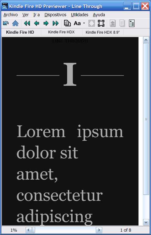

Hi Hitch;
Yes, I think you're right. Watch the following images:
1. Kindle Previewer (font-size: 3)
Name:	Line Through I.jpg
2. Kindle Previewer (font-size: 11)
Name:	Line Through II.jpg
As you can see, with a font-size "3", instead of "--- I ---- " we could also have written "--- II ---- " without problems. But with a font-size "11" that is not possible. So, we need to add code to manage that issue with bigger font-size and my "perfect solution" was not so perfect

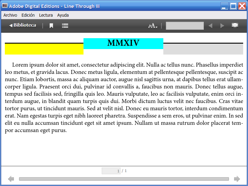

I think I had success As I said before, I used a three columns layout but not by using tables! I just used the property "float: left" and it worked also in ADE!
In the css stylesheet, I wrote:
body {
   margin: 0;
   padding: 0;
.left_col {
   float: left;
   width: 33%;
   text-align: center;
   background: yellow; /* This is not necessary */
   border-top: 3px solid;
.double_col {
   float: left;
   width: 67%;
   text-align: center;
.col1 {
   float: left;
   width: 50%;
   background: aqua;  /* This is not necessary */
   margin-top: -0.5em;
   font-size: 1.4em;
   font-weight: bold;
.col2 {
   float: left;
   width: 50%;
   background: #ddd;  /* This is not necessary */
.cleared {
   clear: both;
   text-indent: 1.2em;
   text-align: justify;
In the .html code I wrote:
<h2></h2>
<div>
  <div class="left_col">&nbsp;</div>
    <div class="double_col">
      <div class="col1">MMXIV</div>
      <div class="col2">&nbsp;</div>
    </div>
</div>
<p class="cleared">
Lorem ipsum dolor sit amet, consectetur adipiscing elit. Nulla ac tellus nunc. Phasellus imperdiet leo metus, et gravida lacus. Donec metus ligula, elementum at pellentesque pellentesque, suscipit ac nunc...
</p>
The background colors I used are not necessary; they are there only for clarity. And also we can only use:
<div class="left_col"></div>
instead of:
The character &nbsp; is only necessary to show the background colors. And of course, we are free to change the width of the columns.
This is the way it looks in ADE:
Below I attach the respective .epub.
Regards
Rubén
