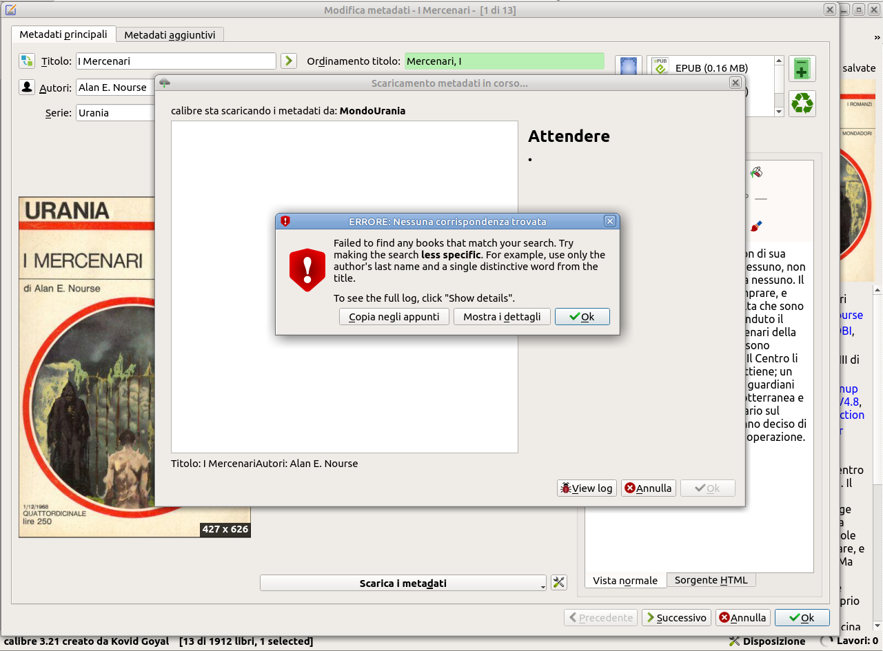

However even if I've got the same book, the plug-in does not work for me. Here is a screenshot:
And this is the details given by Calibre:
calibre, version 3.21.0
ERRORE: Nessuna corrispondenza trovata: <p>Failed to find any books that match your search. Try making the search <b>less specific</b>. For example, use only the author's last name and a single distinctive word from the title.<p>To see the full log, click "Show details".
Running identify query with parameters:
{u'authors': [u'Alan Nourse'], u'identifiers': {}, u'timeout': 30, u'title': u'I Mercenari'}
Using plugins: MondoUrania (0, 2, 1)
The log from individual plugins is below
****************************** MondoUrania (0, 2, 1) ******************************
Found 0 results
Downloading from MondoUrania took 0.44456410408
Querying: http://www.google.com/custom?as_site...ri+Alan+Nourse
title: i mercenari - Mondourania
url: []
Plugin MondoUrania failed
File "/usr/lib/calibre/calibre/ebooks/metadata/sources/identify.py", line 48, in run
self.plugin.identify(self.log, self.rq, self.abort, **self.kwargs)
File "calibre_plugins.MondoUrania.__init__", line 154, in identify
File "calibre_plugins.MondoUrania.__init__", line 238, in _parse_search_results
IndexError: list index out of range
The identify phase took 0.60 seconds
The longest time (0.444564) was taken by: MondoUrania
Merging results from different sources and finding earliest publication dates from the worldcat.org service
We have 0 merged results, merging took: 0.00 seconds
Could you please help?

{u'identifiers': {u'customidentifier': u'URANIA 707'}, u'timeout': 30, u'title': u'Condominium', u'authors': [u'J. G. Ballard']}
Hi, sorry for the late rrsponse, it's due to the corona.
I made quick fix, but did not test it through and through.
I expected more difficulties because the plugin was from july 2018. And that would be a long periode without any changes. But it seems to work after a small change in the code.
So give it a try, test it and enjoy.
Update 0.2.3 available at the start of this thread.
Thank you!
Just tested and works like a charm.
Really appreciated!
Stay safe!
Waylander
