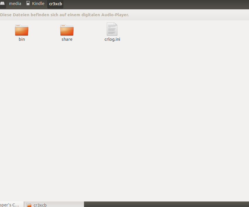

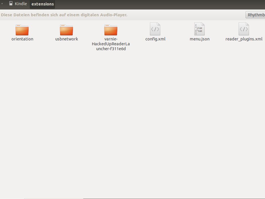

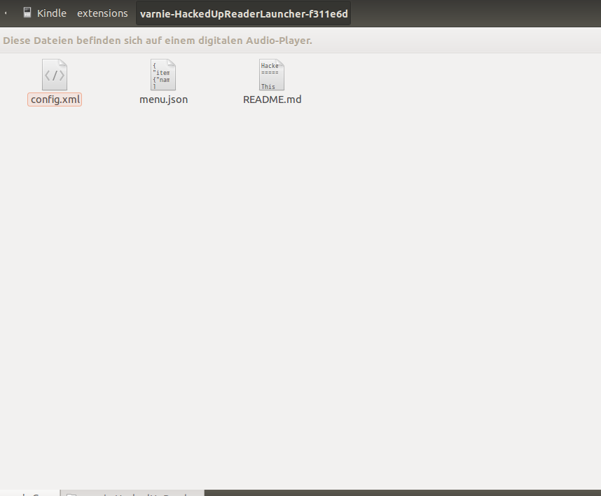

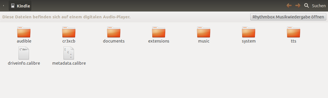

Here are the screens :
ID:	88385   Click image for larger version
ID:	88386   Click image for larger version
ID:	88387   Click image for larger version

From the images you posted, it looks okay.
What happens if you ssh into your Kindle and type in:
/mnt/us/cr3xcb/bin/cr3
bhaak is offline   Reply With Quote
