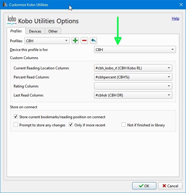

So I use Store reading point, but after updating Calibre and the plugins, it's not saving the 100% in the #koboreadpct column like it used to - the column is blank. When I go to run Store again, it does have the date I finished reading and says 100% in the dialog popup so it's being stored somehow, but I can't see it's finished in my column anymore.

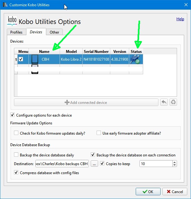

Sometimes Kobo Utilities loses how to recognize a device, especially after a hard reset or a format, and sometimes after a firmware upgrade.
To check this, start calibre, plug in your device, start Kobo Utilities, open the "Devices" tab, then ensure that the attached device is being recognized with the device name you expect.

Then open the "Profiles" tab to ensure that the profile you have used to set the columns references the same device you saw above or "*any device". Also make sure that "Store current bookmarks/reading position on connect" is checked.

threebluestars
threebluestars began at the beginning.
Posts: 10
Join Date: Mar 2015
Device: Kobo H2O 2nd Edition
Attachment 208913
Attachment 208914
THANK YOU! It was the devices. Weirdly it didn't like me specifying "Kobo Aura H2O" and wanted it to say "Any Device" - why, I don't know, but it's working under that setting.
